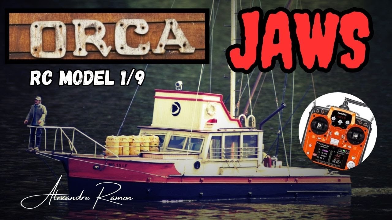

ORCA 1/9ème Jaws
Why 1/9 scale, you might ask?
Simply because I found the main characters from the film on a specialized figurine website, and for them, the scale is 1/9.
The propulsion is carried out using a Marchal 12V windshield wiper motor. It is powered in 6 and 12V by two 6v 12ah lead batteries in series which serve as ballast. The propeller is a 3-bladed 70 mm. For the stern tube which is 50 cm long, I used a piece of 8/10 copper. Using my lathe, I machined bronze bearings then bored to 6 mm for the passage of the propeller shaft. Next, the tube was drilled to place a grease nipple and everything was brazed.

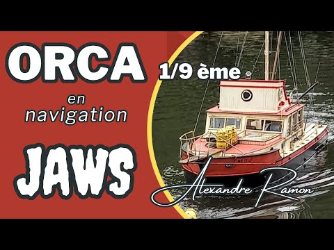

ORCA 1/9ème Jaws
For doug, From the bowsprit to the stern, the boat is 1.50 m long and 44 cm wide and has a mast 1.30 m high. Its weight is 21 kg in running order.
