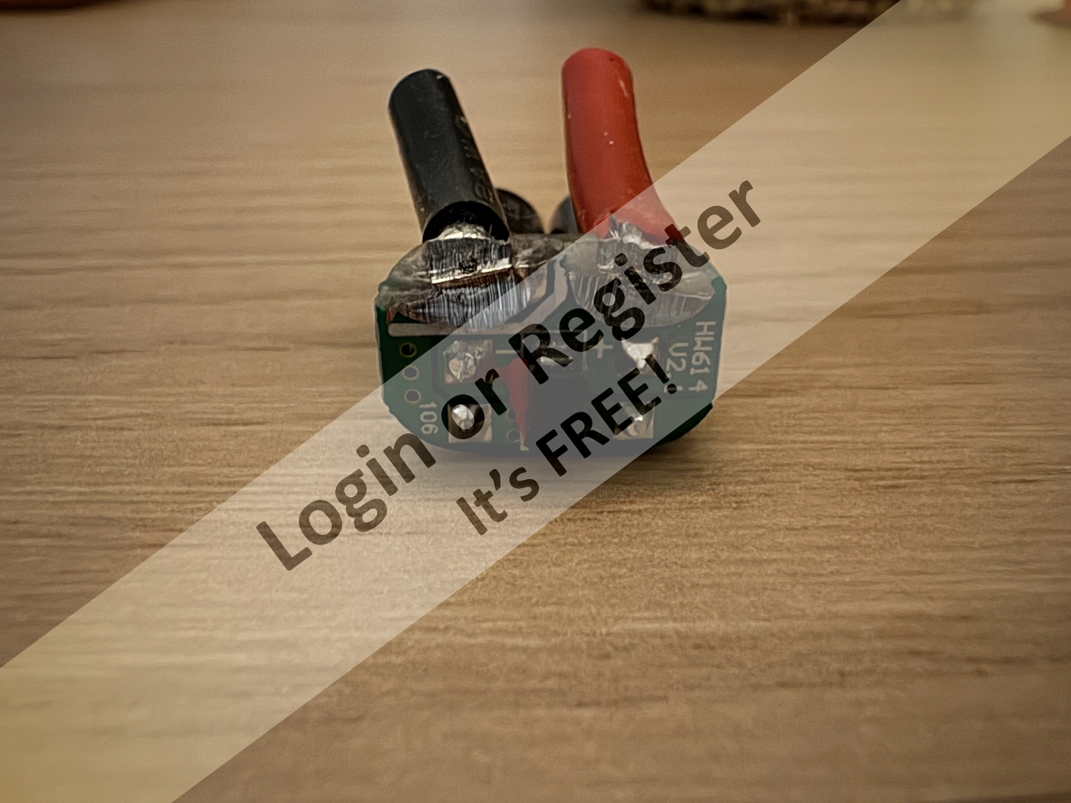

What is the purpose of this small device (pictured below) that comes buried under black shrink wrap and is fitted across the positive and negative power supply wires to the ESC?
….and of much more interest (as far as this particular farce is concerned), why does it prevent the brushless motor being able to rev when the power supply is dropped from a pair of 2C LiPo batteries (wired in parallel - same voltage) to a single 2C LiPo battery .

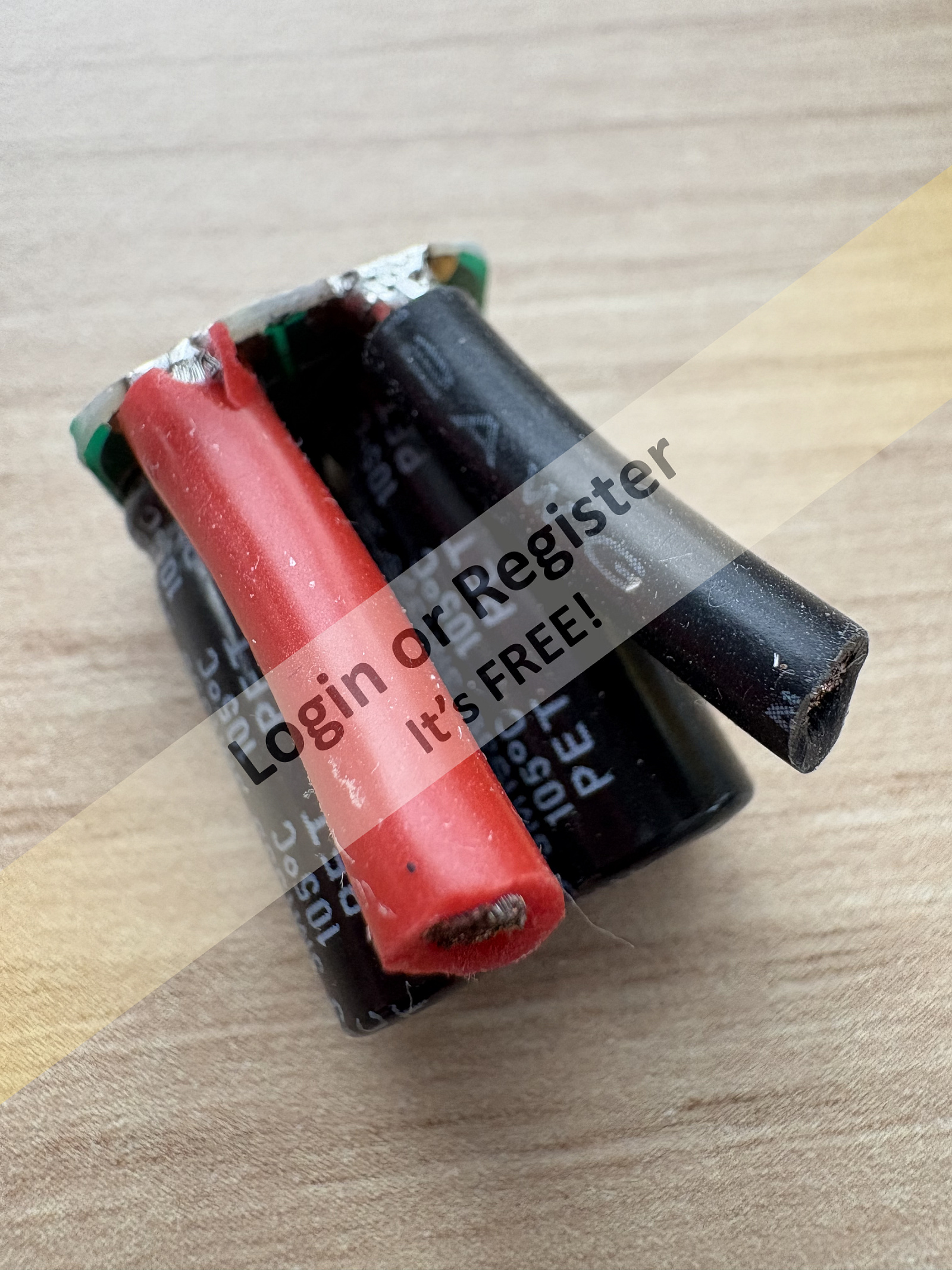

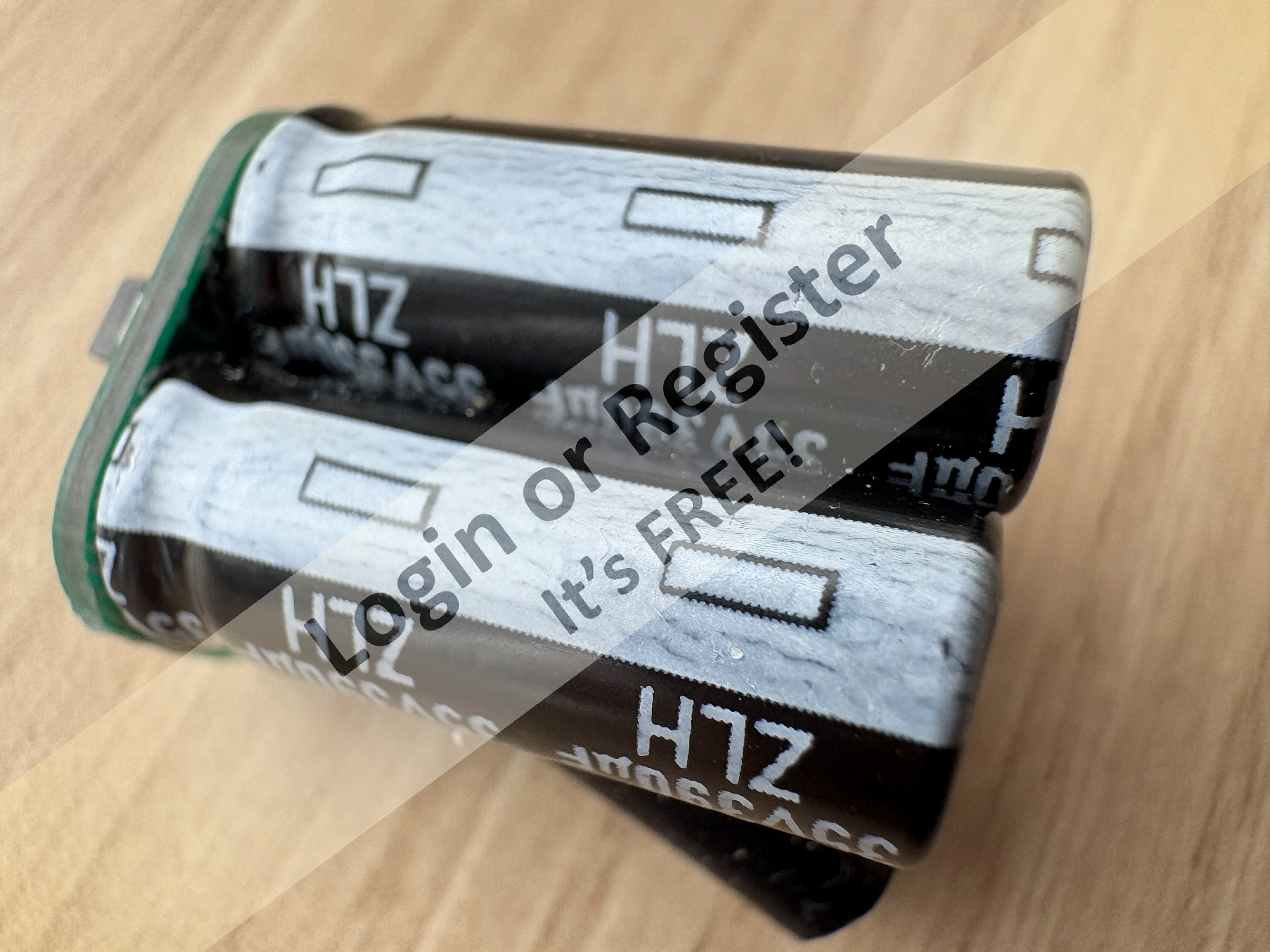

This little circuit board was the culprit, the reason why the ESC would only deliver full power from a pair of LiPo batteries.
It was the “lump” hidden under the black heat shrink that can be seen on the black and red power supply wires.
The ESC would not allow the motor to rev with only one LiPo battery connected.
The “Y” lead was soldered in parrallel to double the endurance (not to double the volts) so in theory the motor should be able to run equally well on one LiPo or two LiPo batteries.
…….and it does now that this circuit board has been removed.

Eventually the penny dropped ! The little circuit board that was on the ESC supply wires must only allow it to work on two LiPo batteries.
I cut out this circuit board and soldered on the XT60 plug again - and this time the Remora positively flew around the lake - no problem with not being able to rev now….but nobody that I have spoken to can understand this or why it happened.

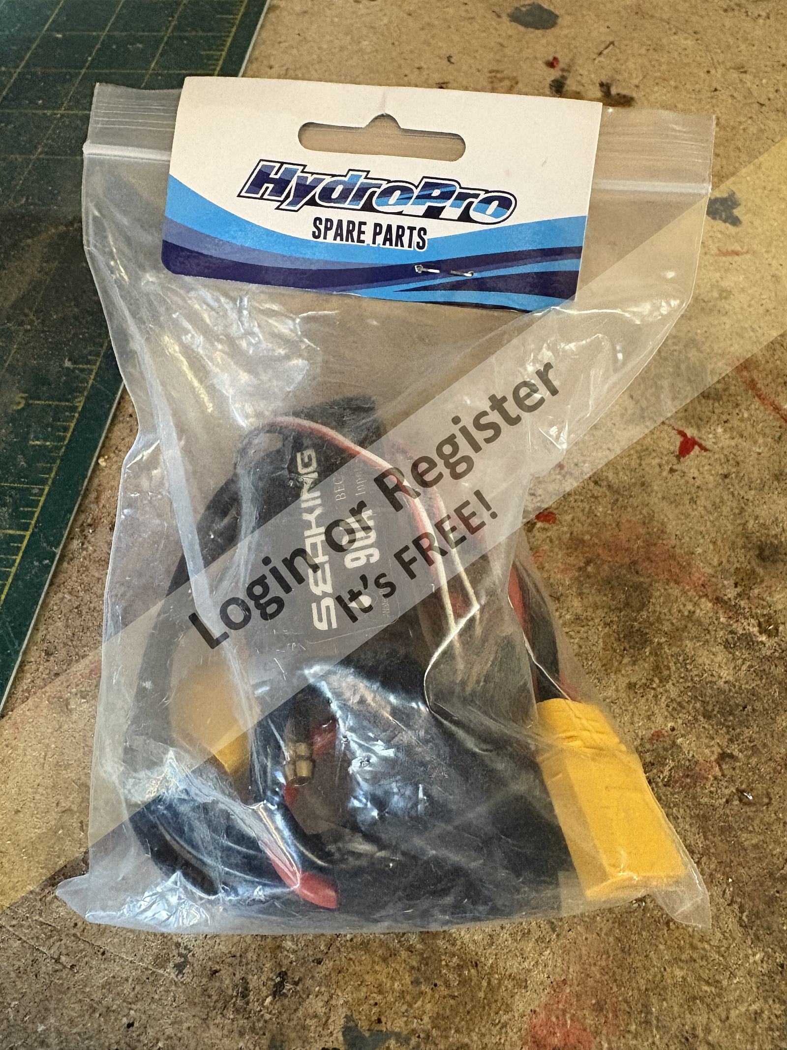

The first picture shows the spare ESC in its packet as supplied new,

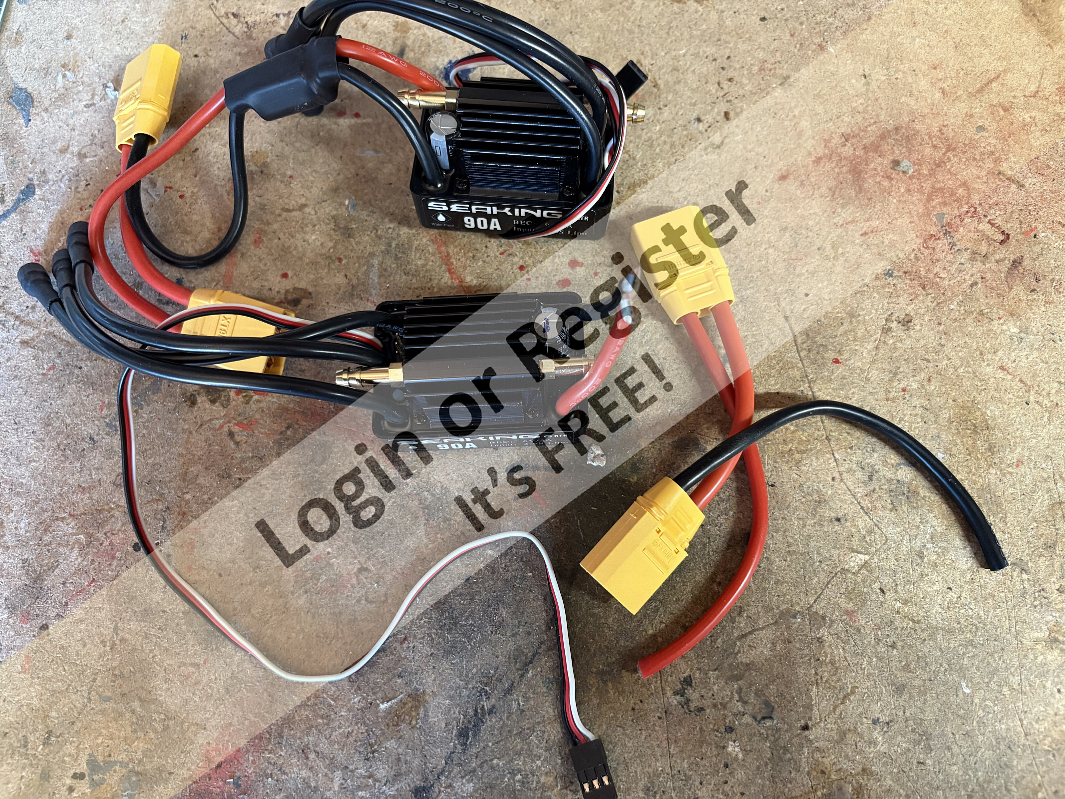

The second picture shows one ESC with the “Y” lead and one without.

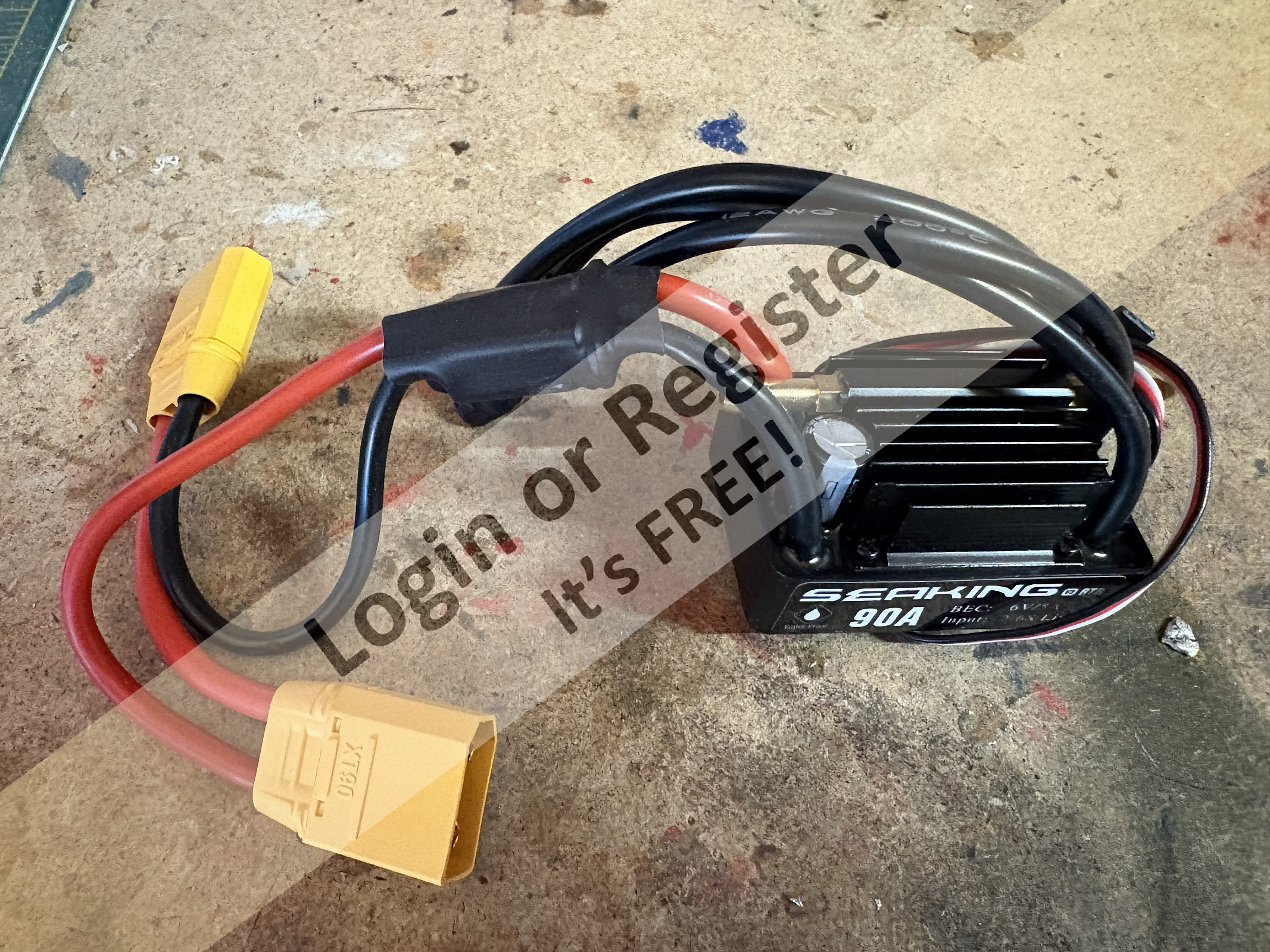

The third picture shows the ESC as it was delivered with its “Y” lead attached.
