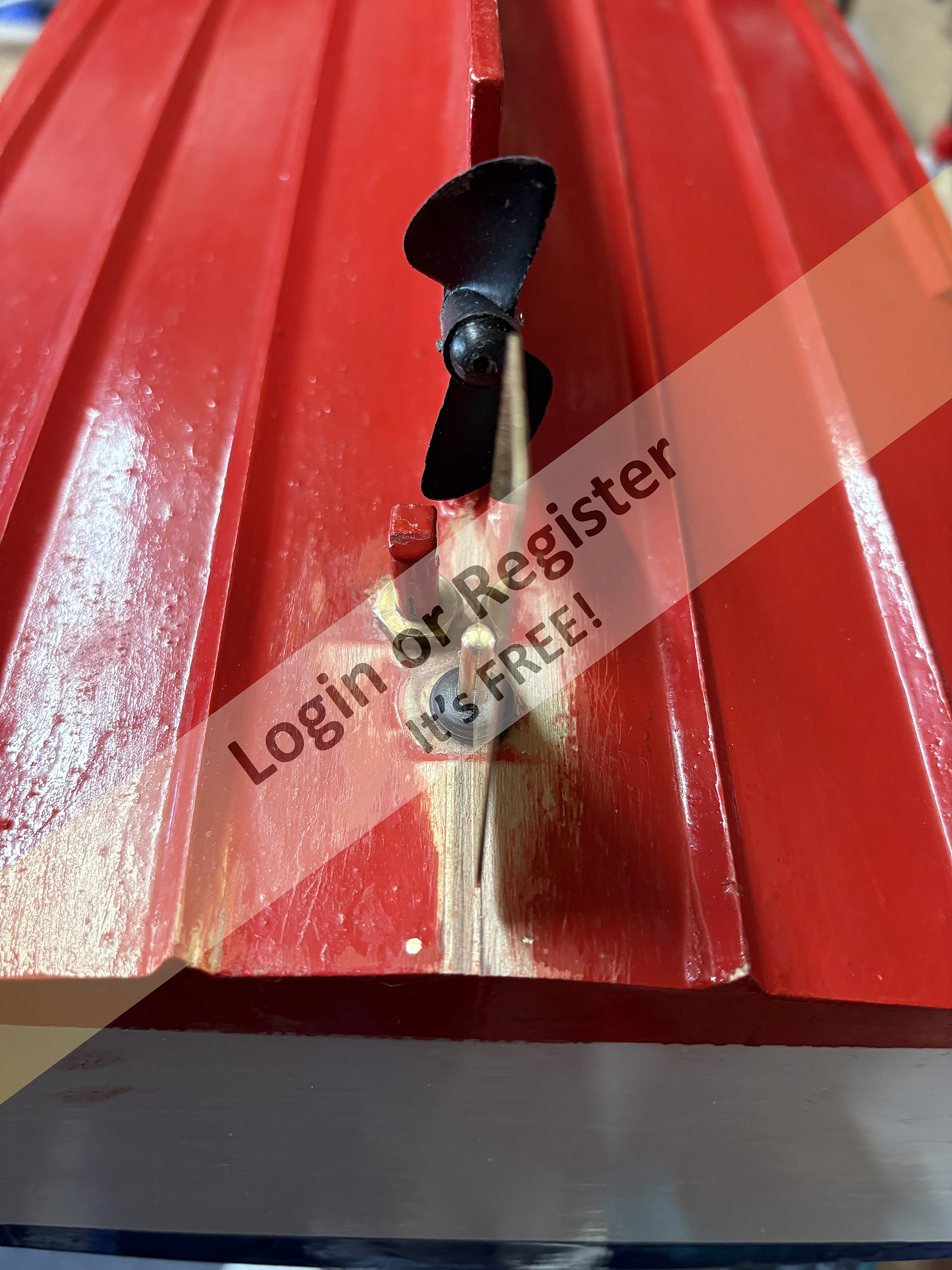

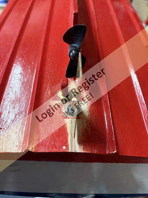

I have just repositioned the water scoop on my troublesome Sea Commander that likes to drop its nose down into the water when it turns RIGHT into choppy water or another boats wake.
Turning the boat LEFT into the same choppy water or another boats wake does not change the boats poise at all and since the boat is built nice and square and the rudder and water scoop were directly on the centre line, the most likely cause for this strange behaviour is that the hull is being affected by torque?
This is further confirmed by turning the rudder to the LEFT when the nose is diving under the water as this causes the boat to immediately stop diving and regain its composure.
With the water scoop now re-positioned so it is mounted as suggested by Vic Smeed all those years ago, it naturally places it on the RIGHT underside of the hull.
Maybe this will help to off-set the torque twist that may in turn be causing this boat to nose dive when turning RIGHT into choppy water?
I will cover the raw wood with some paint in the area where I have been working and get the boat back into the water to see if it has helped in any way?
