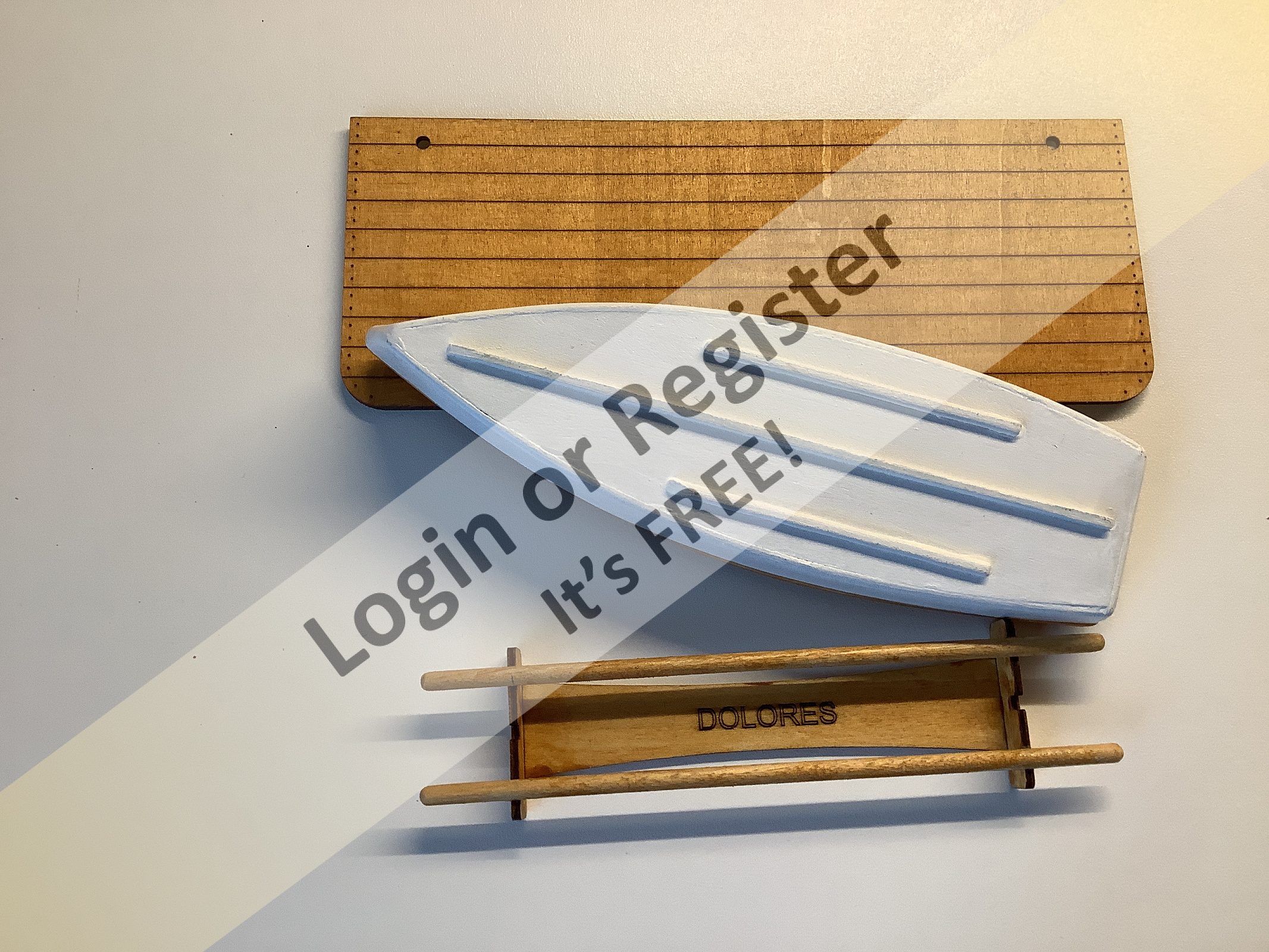

Hi JockScott I think it's a good method for such small boats.
Alternatively, there is the 3D printer, but I would still have to do the drawing.
Try your method, if you are not satisfied I will try to make the drawing and send it to you in any case.

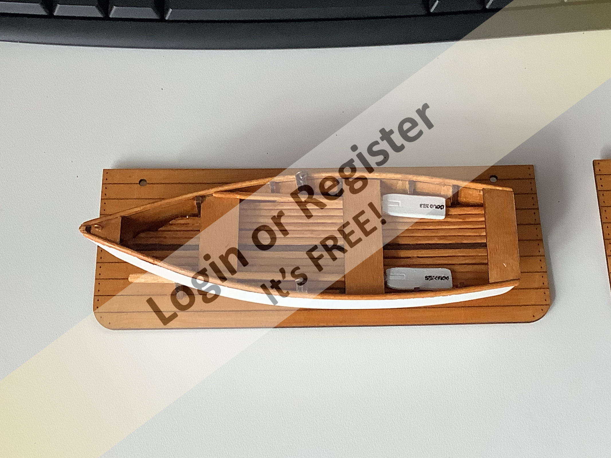

Yes Alessandro, the boats will only be 53.3mm long. I planned to make it from 2 half's of bass wood (Linde) pre-shaped with a .5mm centreline frame of styrene glued together and then shaped with a fine rasp and sand paper to what it should be based on my best rendition of what they looked like.

Yes Alessandro, the boats will only be 53.3mm long. I planned to make it from 2 half's of bass wood (Linde) pre-shaped with a .5mm centreline frame of styrene glued together and then shaped with a fine rasp and sand paper to what it should be based on my best rendition of that they looked like.

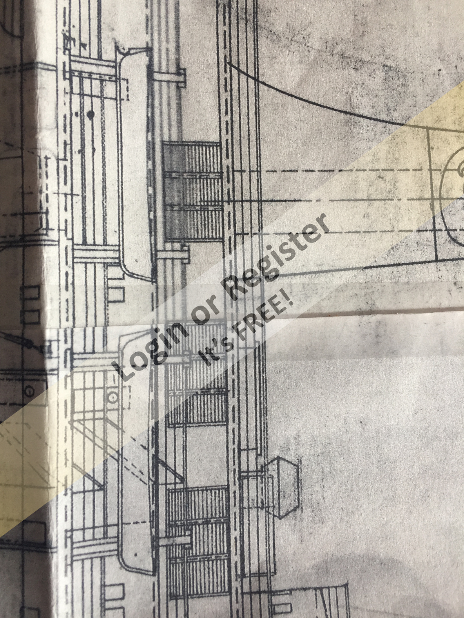

Hi Jock, the images aren't great and unfortunately the front view is missing (which would have given me the indication of the larger frame).
However, without any guarantee of success and with very long times, I could try if you like.
But there is another problem, if I haven't made a mistake in the calculations (i.e. a simple division) an eight meter long boat on its tanker means little more than 5 cm. It is very small to make it in wood with the planking method. I made 4 of them twice as long and a little more and I had quite a bit of difficulty.
An important question: if I provided you with the drawing in two 2d would you then like to make it in wood?
If you say yes, even just to try then I'll try to draw it too.

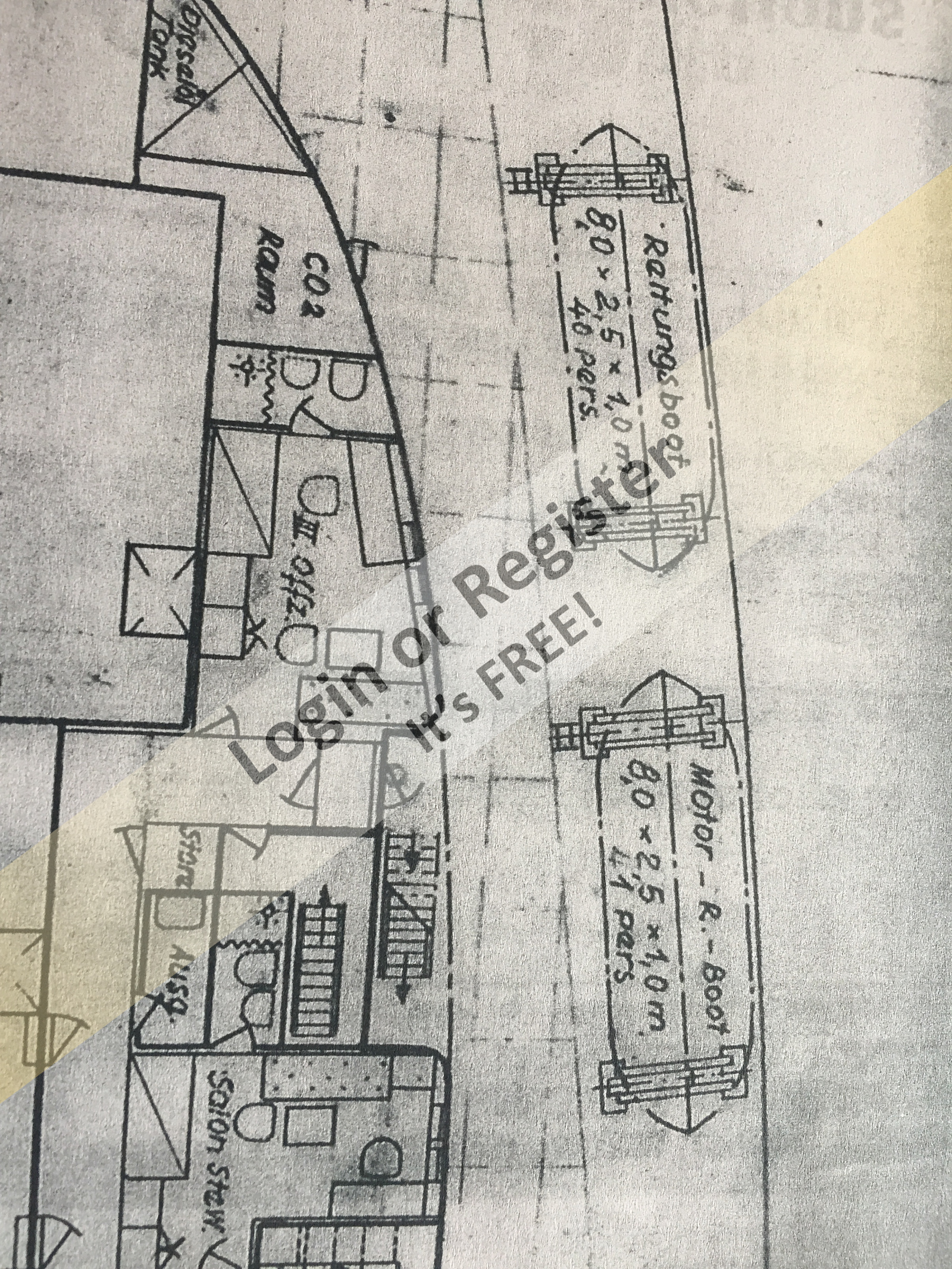

Alessandro, I have enclosed photos of the lifeboats on the GA Plan with shape and dimensions. I may be able to visit Hamburg in the next few month and plan my usual trip to the IMM for some close up shots of the lifeboats I am looking for.

Hi Mike, as I already told you in your "build blog", I like your boat a lot, I think it is expertly made.
The problem is that our boats are not suited (hull shape) to JockScott's tanker.
If one of mine was the right shape, we would have already solved every problem because I can scale the 2d plane (keel and frames) to the desired size.
