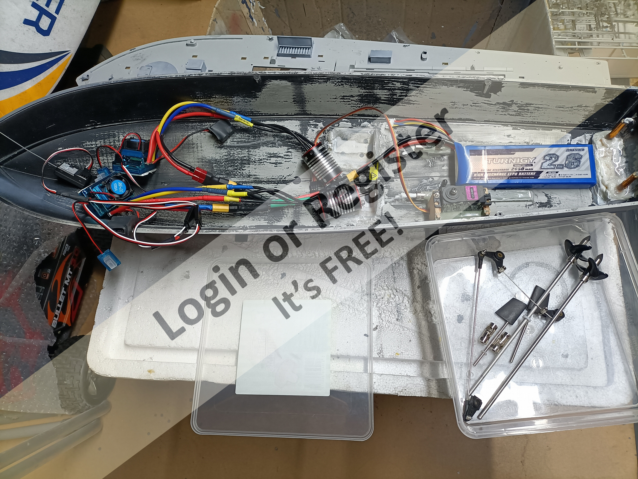

    Yes you could use smaller, slower motors. You have a lot of weight to install, 2 ESC's receiver, ect.
    before you get too far, I would put all the components into the hull that need to be there. Not installed, just as weight. I would put you hull in a tub and see where she sits reference her waterline. You can go deeper than scale, particularly if your motors will get you onto a plane, as ELCO's usually ran, but be careful. There is not alot of difference between a bit more and getting sunk.

    Thanks for the reply, as you may see from the pic, I've already installed the 2 props so I assume I can use smaller motors thus giving me longer run times?

    If my research is correct( don't hold your breath) that motor, with that battery, will turn 33000 at no load.
    Honestly, I think that ONE of those motors would be more that enough to power that hull at greater than scale speed. Running one motor will give a long run time and simplify your installation. As long as low speed maneuvering is not too important to you.

    Hi all, Converting the Italeri 1/35 Elco and looking for battery/motor advice.
    I have 2 brushless 2838/3800KV with ESC for each. Props are 28mm. (Unsure if U need to know that but trying to give as much info as poss).
    I have a few lipo batteries from my plane/drone gear. Is one 2.6 battery enough to power this or should I do 1 battery per side?
    There's a lot of info on this but so many opinions its frying my brain! ๐Ÿค”
    All info is gratefully received!๐Ÿ‘
