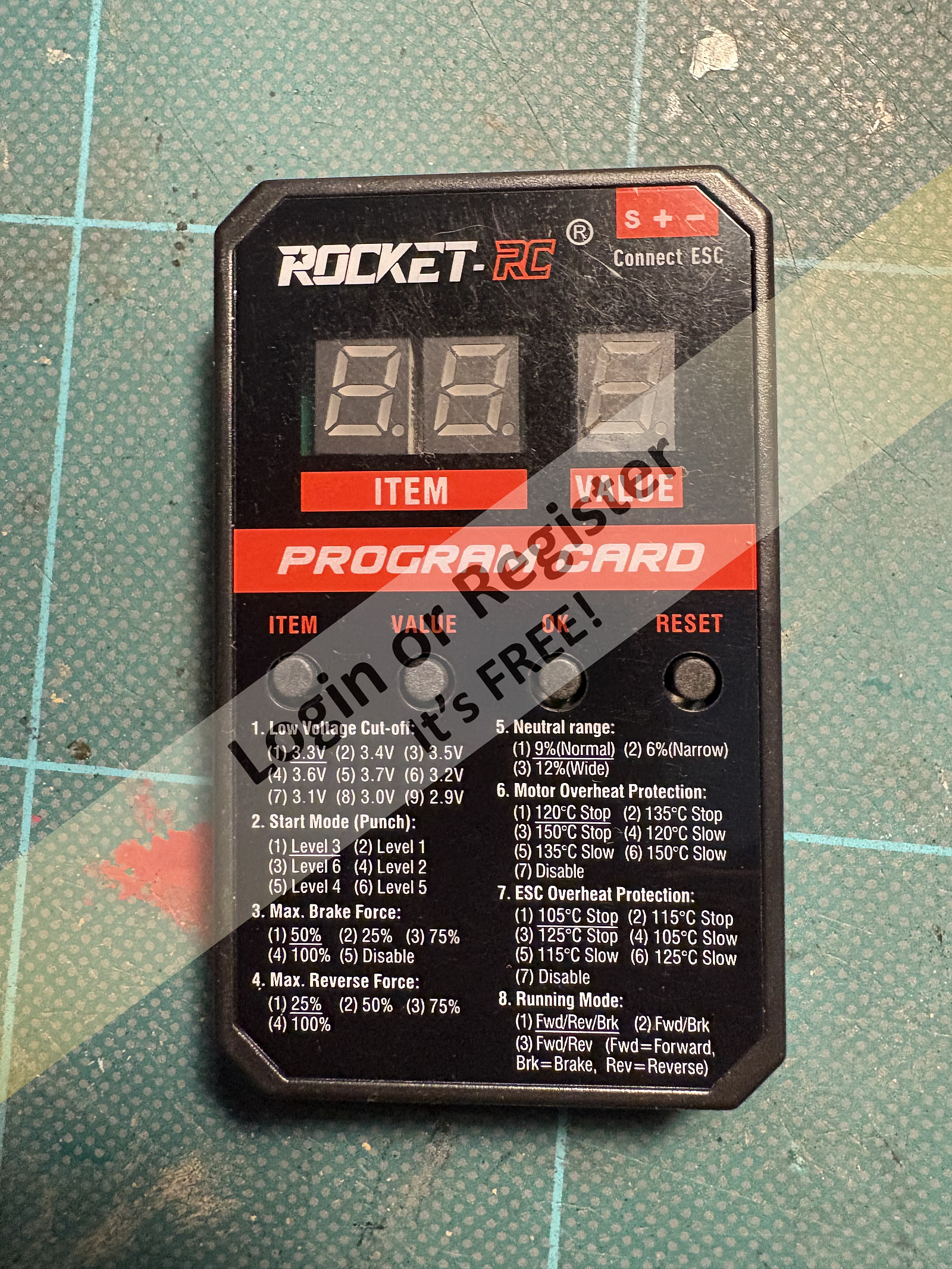

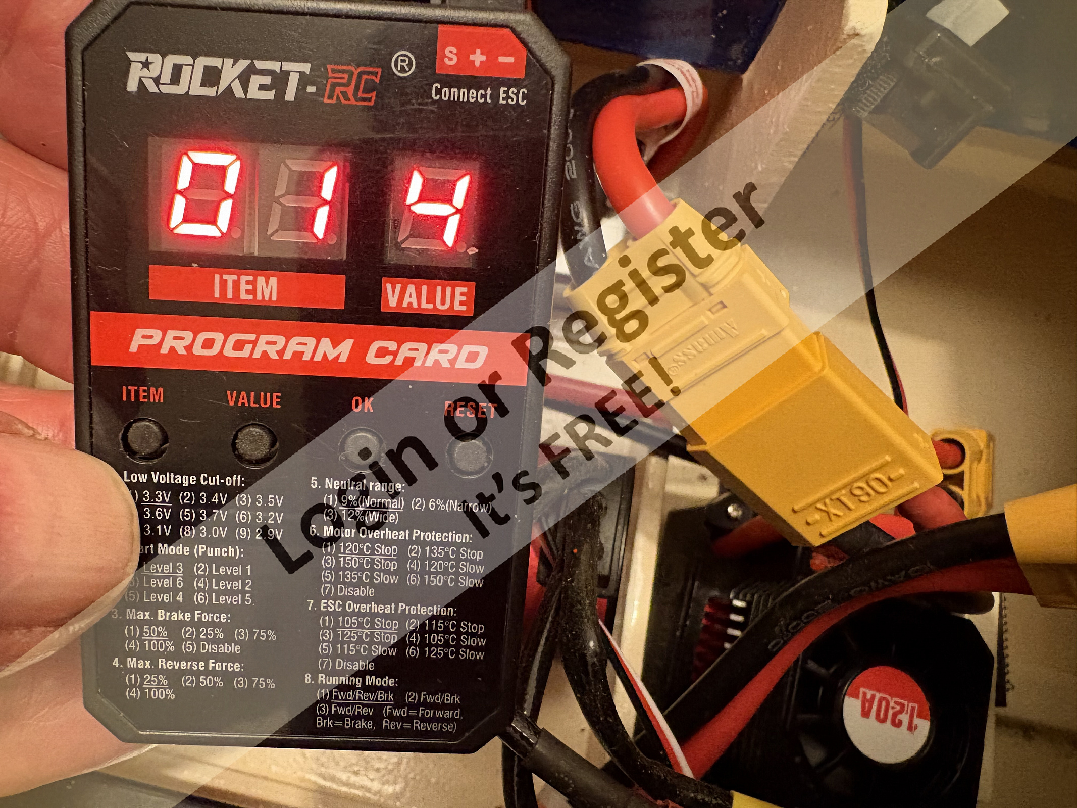

I programmed the Surpass 150A ESC this evening using the Rocket RC program card that I placed inside the hull of the Sea Commander.
No instructions about how to connect the card comes with the card, but it is simply connected to the lead from the ESC to the receiver.
Just pull the plug out of the receiver, plug it into the program card and switch the power on.
The program card has the functions printed on the case so it is easy to choose any function that you want to alter or set.
My main reason for buying it was to stop the ESC draining the LiPo battery and this was easily done.
Most of the other functions such as drag brake, brake force, boost timing and turbo timing are for the car racers as they are not needed on a model boat.

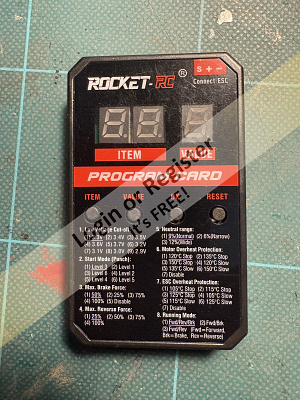

The Rocket RC program card to use with my Surpass 120A ESC has now arrived.
As soon as the paint has dried on the underside of my Sea Commander, I will get it connected and make any adjustment needed to work on 2C and adjust the lowest residual voltage setting to prevent any more LiPo batteries getting run out completely.
The program card is aimed mainly at r/c cars, so a lot of the advanced settings are not really applicable for use in a boat, but I will have a play with it anyways as it is the correct card for use with my ESC.

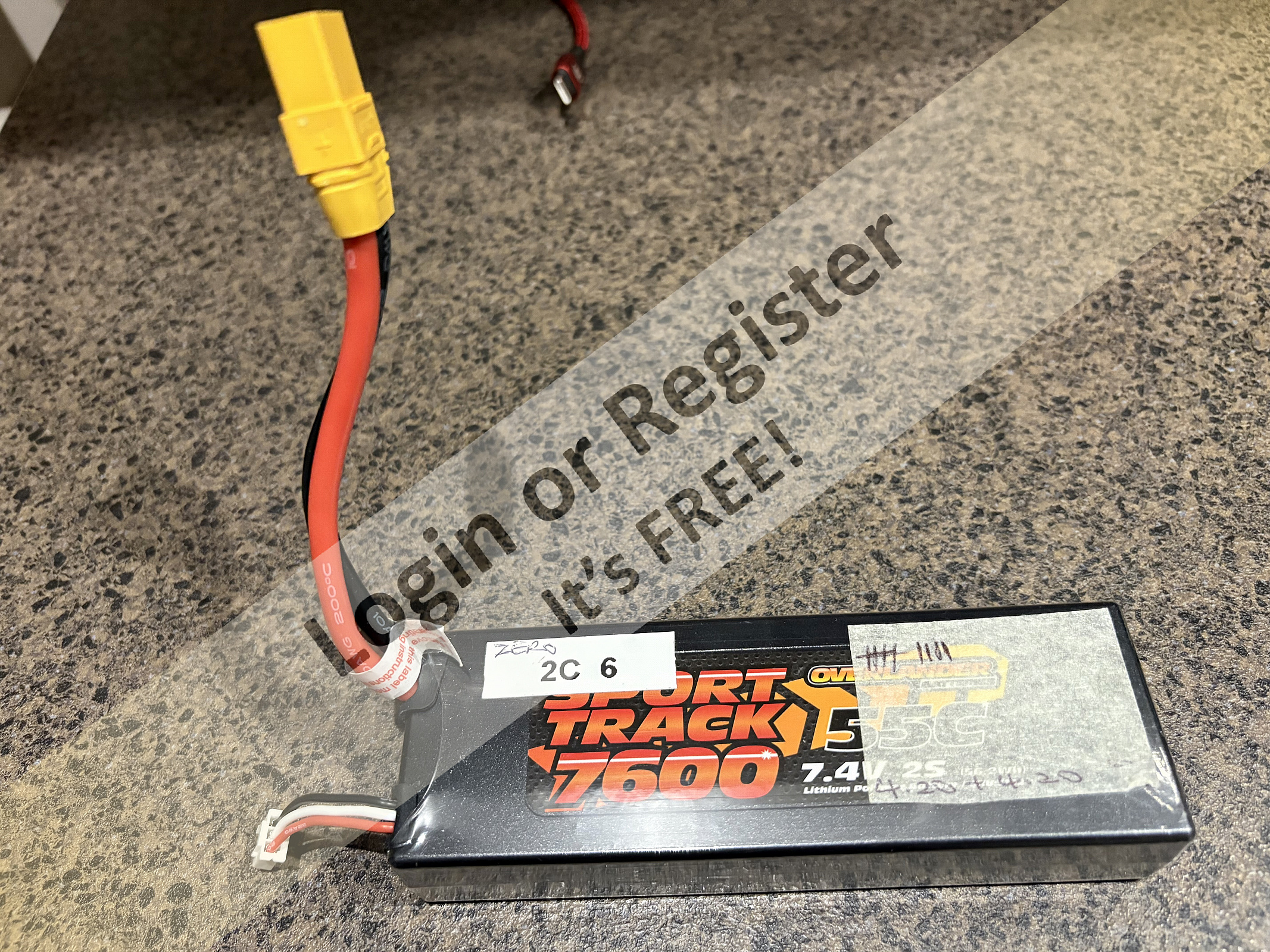

Magical LiPo Recovery?
The Overlander 55C 7600 2S LiPo pack that was drained completely flat by my Surpass ESC has been balance charged on my DC-100 charger.
This battery is identified by my Dymo label as 2C 6. In have written ZERO on this label to remind me that this was the LiPO battery that had been drained completely flat.
Although registering “Fuel level ZERO” after it was drained flat, it has been successfully recharged to full capacity (!) and used again another eight times since!
I waited until after I had used and charged the same battery a few times before saying anything on here as the battery had clearly dropped well below its minimum residual level on both cells so it should have been killed stone dead, and unable to recover.
All of the Kopy Commander testing videos seen on here have been run on this same battery and they show that it can still deliver plenty of power.
As my Surpass program card has not been received yet and I am still running the boat on the same Surpass 120A ESC, I have been careful not to run it for as long as I would normally in case the ESC should drain it again - but it has still delivered good power and been used for decent length run times.
After this mornings “rudder testing on the Kopy Kommander I balance charged it again from 45% back up to 100% full capacity.
I always add a strip of masking tape to my LiPo batteries to record the number of charges using simple “five bar gates”
This battery started again with a fresh masking tape record strip after it was totally discharged.
Each time both of the cells in this battery pack have recorded a perfect 4.2 balance with each other, and this was repeated agin today making 9 successful charges.
I think I have been very lucky to recover this battery, and I don’t know if the incident will have shortened its working life, but for now the battery is working very well.

[{"id":"176176963134","name":"176176963134.jpeg","caption":"","url":"https:\/\/model-boats.com\/media\/176176963134\/l","thumbUrl":"https:\/\/model-boats.com\/media\/176176963134\/s","isImage":true,"ext":"jpeg"}]
When I go home this weekend, my Surpass program card should be waiting for me in the postbox, so I will set-up the ESC correctly to make sure that it stops working before totally draining any more batteries.
The “safety cut-out has obviously failed on this Surpass 120A and is why it drained the battery completely.
I will see if it is possible to dial it back in again when I get the programme card.
Let’s hope we can as the other forward/reverse functions are still working OK.

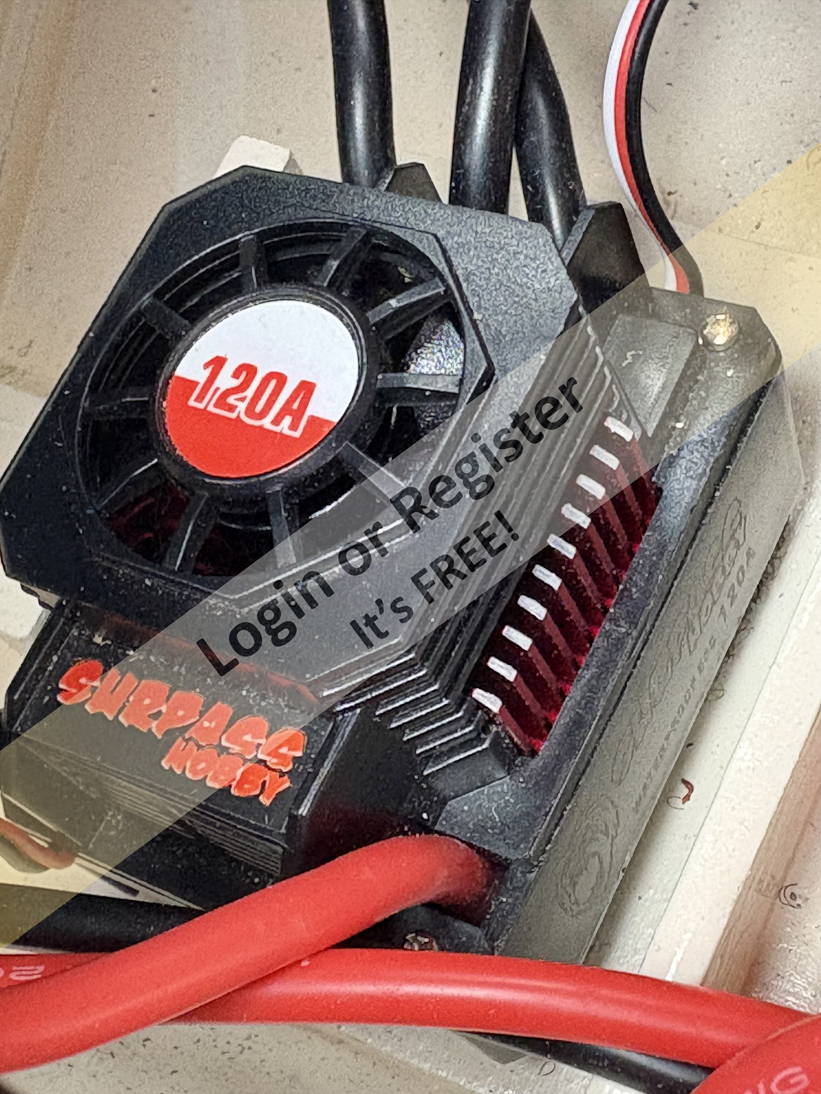

The last time I was out driving and testing my SEA Commander, it suddenly stopped running.
No slowing down or advance warning it just stopped - when out on the water.
All other ESC that I have used in my boats for brushless motor control cut power at a pre-determined cell voltage to protect the battery.
Often, following the power cut the ESC will re-set to allow you to limp back to shore with the boat ready to have another fresh battery fitted to replace the safely discharged one that is in the boat….not this one, it just stopped.
I connected another battery and the ESC worked normally, which I found a little puzzling.
The LiPo was a 2C 7600 Overlander LiPo.
When I connected the LiPo to my Overlander DC-100 charger it gave the “fuel level” as zero!
The battery was completely exhausted.
I always balance charge these LiPo batteries at 2.5 amps, not too fast, but not too slow either.
Fearing that I had just destroyed my LiPo by allowing it to drop below its residual value I pressed the “go” button in any case - nothing to loose!
The charge rate automatically dropped itself to 0.1 amps and very slowly began to increase just before the charger “timed-out”.
I started a fresh (second) balance charge and the LiPo now began to accept a charge at the requested 2.5 amps!
This second charge continued until the charger stopped the cycle and recorded “battery full”.
I am not too happy to run this air cooled (with integrated fan) Surpass 120A ESC again unless I can find a way to programme it to protect the LiPo’s from dropping below their residual safe voltage.
The paperwork that came with the Surpass 120A ESC is at home, so until then I may give my new water-cooled ESC its first run.
As for the LiPo, we will have to see if it can still deliver the power as it has always done, but if it does I will be very pleased - but surprised !
Does anyone else have an experience to share about using this Surpass 120A ESC?
