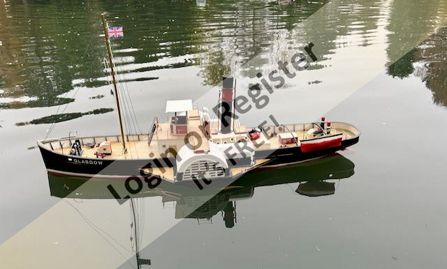

    My Glasgow makes gentle headway with the paddles rotating so slowly that I can see the individual paddles enter and leave the water. I estimate that to be less than 60 rpm, as that is one rotation every second - I doubt that I could see the paddles at that speed.
    I had the opportunity to take a trip on the coal-fired paddle steamer Kingswear Castle along the river Dart a few years ago, and the paddles rotated quite slowly, but they did move quite a lot of water in the process. I expect the views of the river and mouth of the Dart were very pleasant, but I only looked at the paddles and the gleaming steam engine!

    My Graupner Glasgow was bought already built and sailed, with an MFA 540 motor with integral 2.5:1 reduction gear, driving the paddles through a further 3:1 reduction. On a 7.2 NiMH pack I couldn't open the throttle more than about 20% or the paddles simply created froth and noise, but very little propulsion.
    I have now re-motored it with an MFA 540 which has 11:1 reduction drive, still with the 3:1 final drive to the paddles, and it is now a joy to sail, though full throttle is a little unrealistic.
    I calculated from the motor data that the paddles are doing about 180 rpm max, though I rarely use full power on the water. The Glasgow uses about 1.5 amps of battery capacity in a two hour session on the water.
