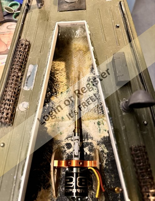

I have spent most of the day trying to get a pair of ESCs that will work together in my Robbe police boat having damaged one of them when playing ice breakers recently.
Having failed to find any in my various boxes, I decided to get back to the ASR.
I had left the new shaft tube strapped in place and secured it with micro fibres and cyano. It was firmly in place and lined up with the centre line of the hull.
As the picture shows, the original builder had been more than generous when cutting the hole for the tube to pass through the hull, so tomorrow's jobs will include a good helping of glass fibre filler to make good the area around the shaft and also to reinforce the rudder tube.
I need to wait until the morning as I'll have to work with the windows open to minimise the smell of the resin, so best done while my wife is out.

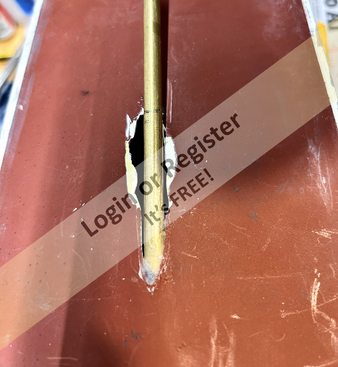

Over the last few weeks I was struggling to line up the new prop shaft (not helped by the large hole in the hull), but it was only today that I realised that the rudder had been mounted off centre.
Rudder hole fixed with cyano and microfibres, then re-drilled in the correct place, the rudder tube fixed in place.
Next, I established a true centre line on the hull and have tacked the prop tube in place with another dose of microfibres and cyano.
I'll be out at the club pond tomorrow, but hopefully can get the shaft tube firmly fixed in place later tomorrow or on Monday (the joy of retirement!).

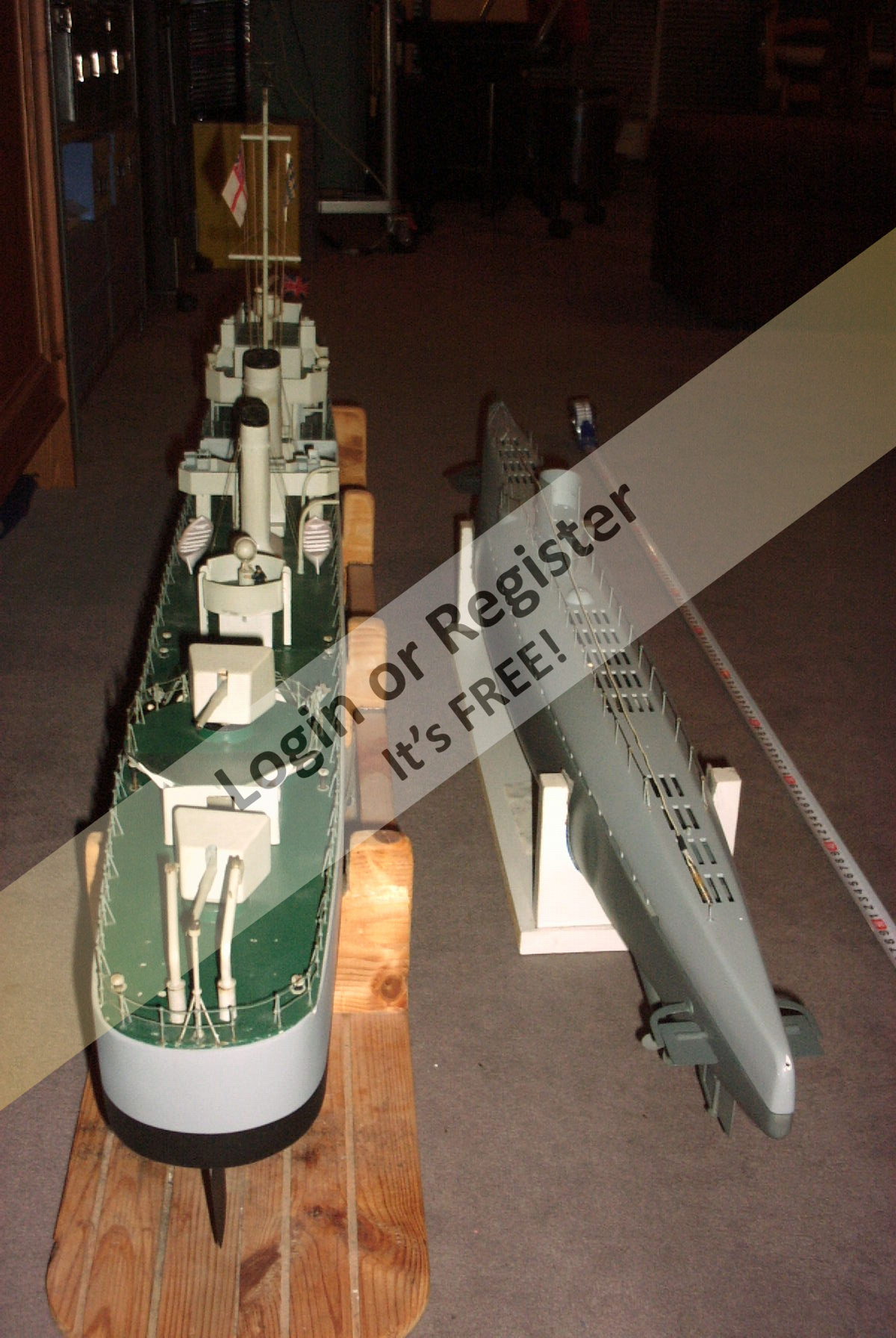

Hi BJ,
Re "Doug was 'Submarine Racing', on the Canadian border?"
Actually no, but on an inland sea in Munich, Bavaria.

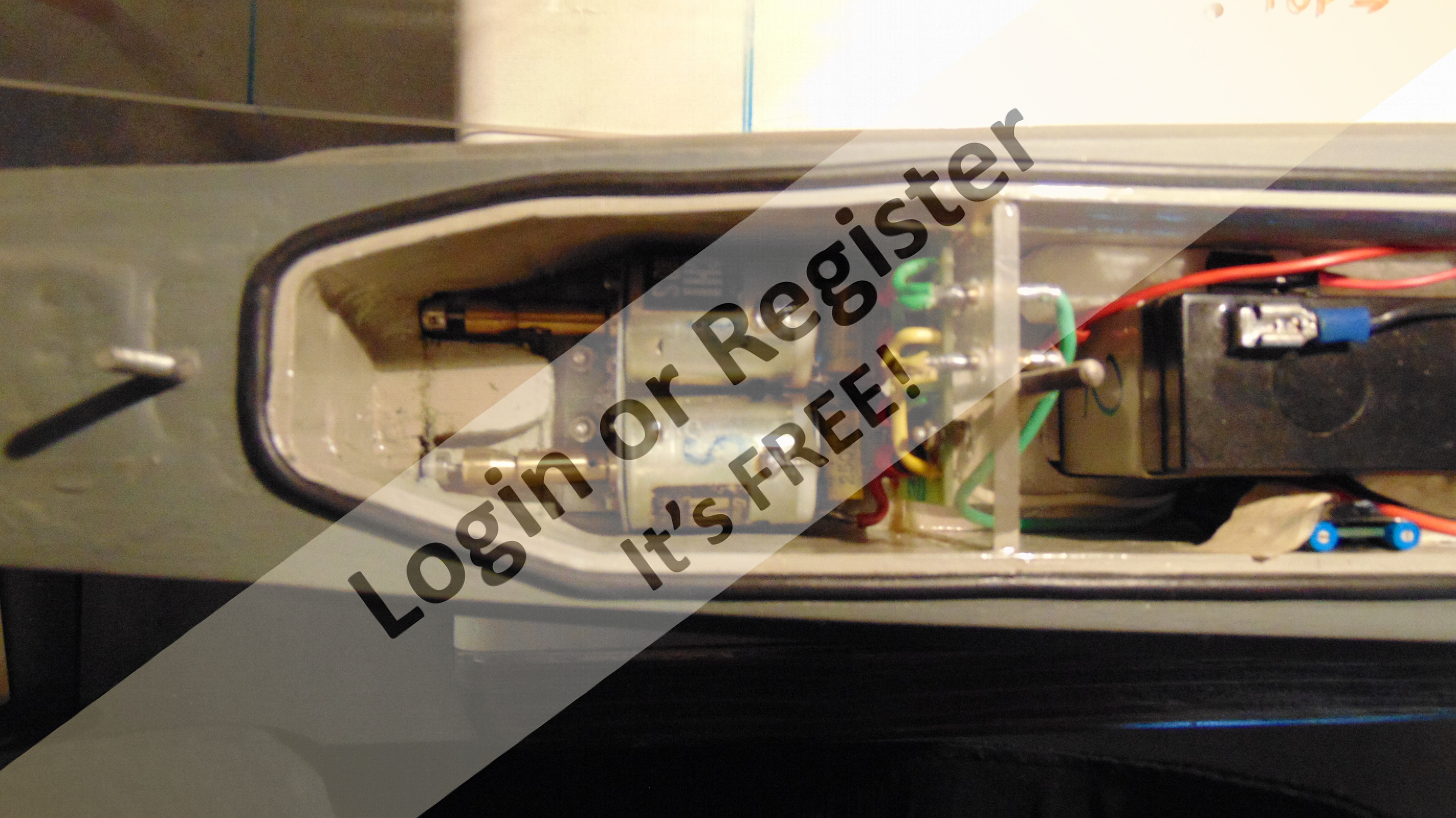

Running a 107cm type 1A U Boat (1/72nd scale, running two 385 brushed on 12V driving 30mm screws) I easily outran several RTR 'Speed Boats' leaving their proud owners looking a bit glum.😂🤣 Advantage of a ca 10 to 1 LoA to beam ratio😁
Cheers, Doug
BTW What's with all the odd cryptic posts? Have you been inadvertently sniffing too much glue?
