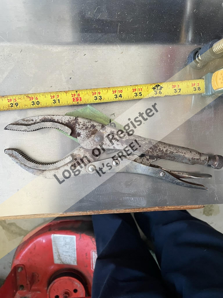

    modify extended-reach VICEGRIPS to accept your rivet bit tools. You will be able to adjust the tension you need by adjusting the VICEGRIP tension

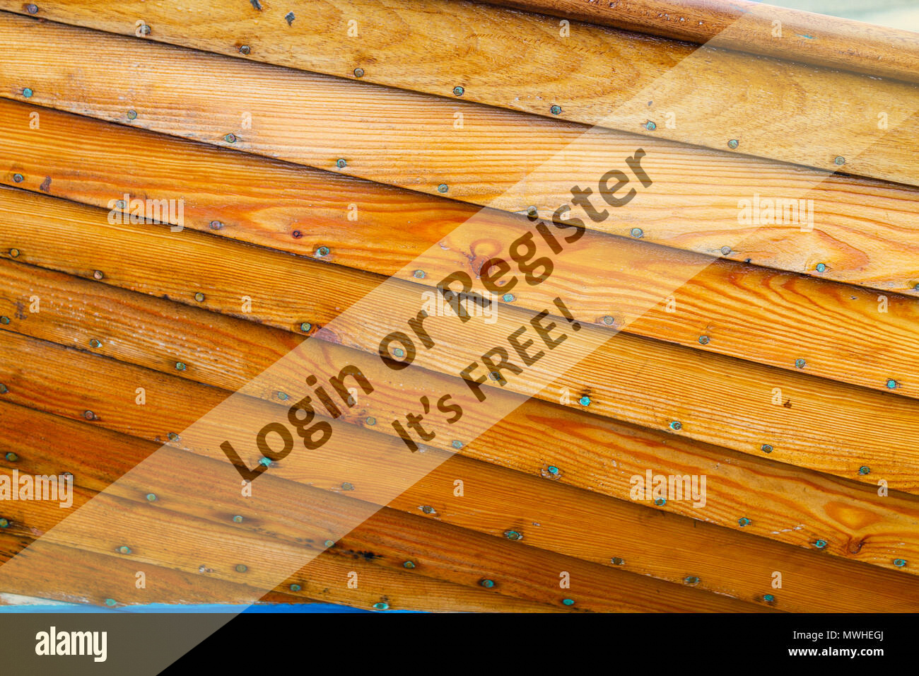

    The pins are a solution, but I plan an open rowboat. The rivets will also be seen from the inside.

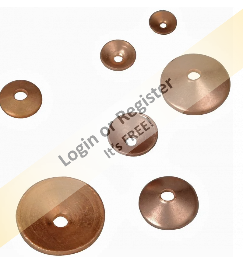

    In real life, the pins are insertet from outside and on the inside of the hull, the washers are squeezed on the pins to keep the wooden planks together. Then the remainder off the pins are cut and then cropped.
    The squeezing is not the point, but how to show the rivets from outside and within the hull is the question. The pictures are from the real thing and these are to big.

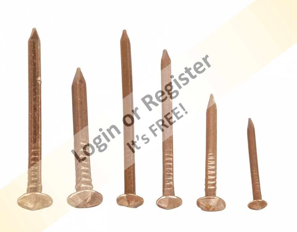

    Brass pins and polish (sand after install) the finish off the head.
    I used about 900 stainless steel pins in the BLUENOSE hull. It's a lot of work
    pin head diameter: 2.1 mm
    pin shaft diameter: 0.9 mm

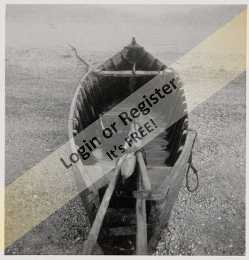

    I'm looking for a new project and found a Dutch "haringboot".
    This is a clinker-build boot of about 7m long. I plan to build a 1:10 model with a real rowing mate.
    Now i'm wondering how to do the clinker-build. The single planks are attached with copper rivets and I want to do the same on the model.
    Does anyone know were I can find such smal rivets?
