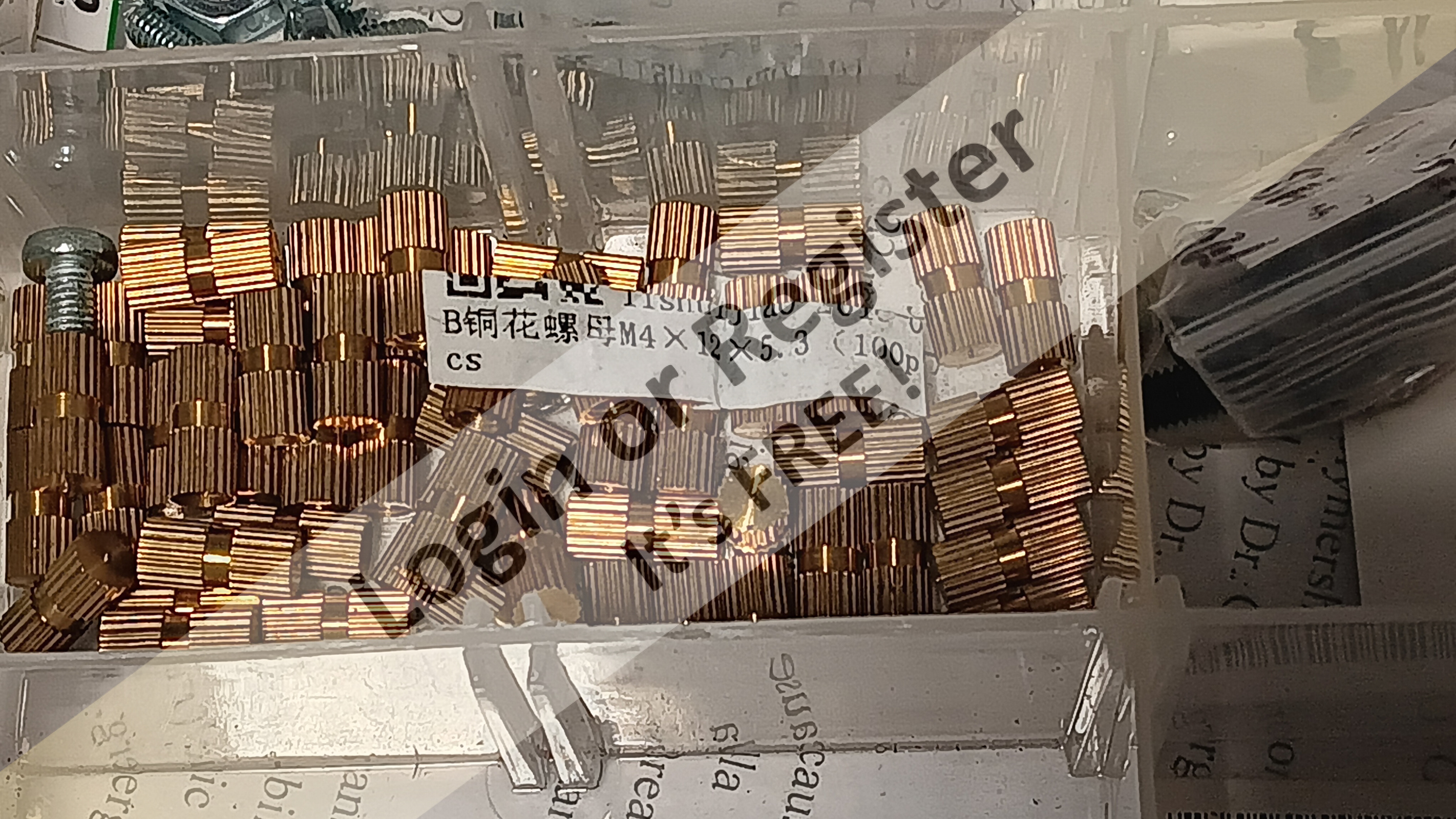

Roy, so far I have been using M4 inserts. I make the hole in the props hub a medium press fit with some superglue so it aligns with the insert pretty good.
I don't build (or even have) speed/racing boats. I don't classify patrol boats as "speed boats". Thus I have no interest or issues with specialty shafts. Just keeping it simple with my scale boats.
