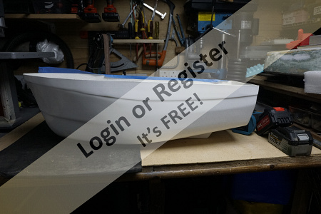

I'm building a displacement hull fishing boat, 16lbs in weight 27" x 10" beam
single prop, prop needs about 50-60mm ? Anyone have any advice regarding motor and esc choice ?
