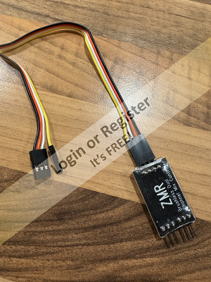

Hi yes, what you are dealing with is 2 esc's each set to supply the current used to run the receiver. Inevitably the voltage each esc is supplying is not the same and you only need one of them to do the job.
The best way to do it is to use an extension servo lead and cut the red lead in the wire. Plug one end of the extension lead into the receiver and the other end into either esc.
That way the esc's remain intact.

Hi ColinJ2, the mixer you have there from AliExpress is marked brushless. BUT it is not just brushless it will drive a brushed esc just as well.
The mixing is done before the esc is involved. It is possible the mixing has taken brushless operation into account.

Hi Eric. The main servo lead goes to the o/p lead for the throttle. There is a single connecter and that goes to the rudder signal wire which is the inner wire where the rudder o/p is connected.
These single wires fit into the normal 3 lead _ve, +ve signal servo connecter. But only the signal wire is needed.
I would suggest it is only a mixer and 2 off esc's are connected to the o/p of the unit and these drive the motors.
So you can operate the 2 motors from a 2ch. RC set. The rudder control balances between the motors.
If you want a rudder as well then you need a rudder servo and connect the signal wire to the rudder servo connecter in parallel.

Hi Eric, can't help with the wiring diagram but hopefully you know that you need an ESC for each brushless motor?

Hi, bought two of these for my RC shark, I need to mix two brushless motors and two servos. They don’t have wiring diagrams 😆 any suggestions as to how to wire them up please? I’ll be using a Futaba 6EX-PCM 1024 as it’ll be under water (hopefully!) thanks in advance..
