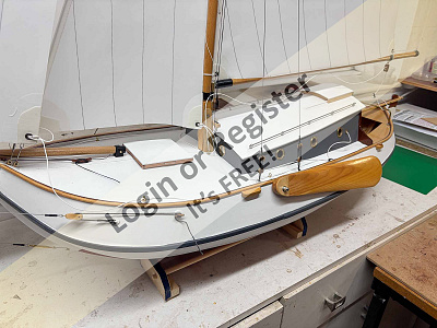

Andy,

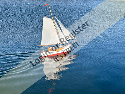

What a magnificent model—she looks absolutely great and very elegant out on the water.
All your effort has really paid off; she sails beautifully.
A real pleasure to see.

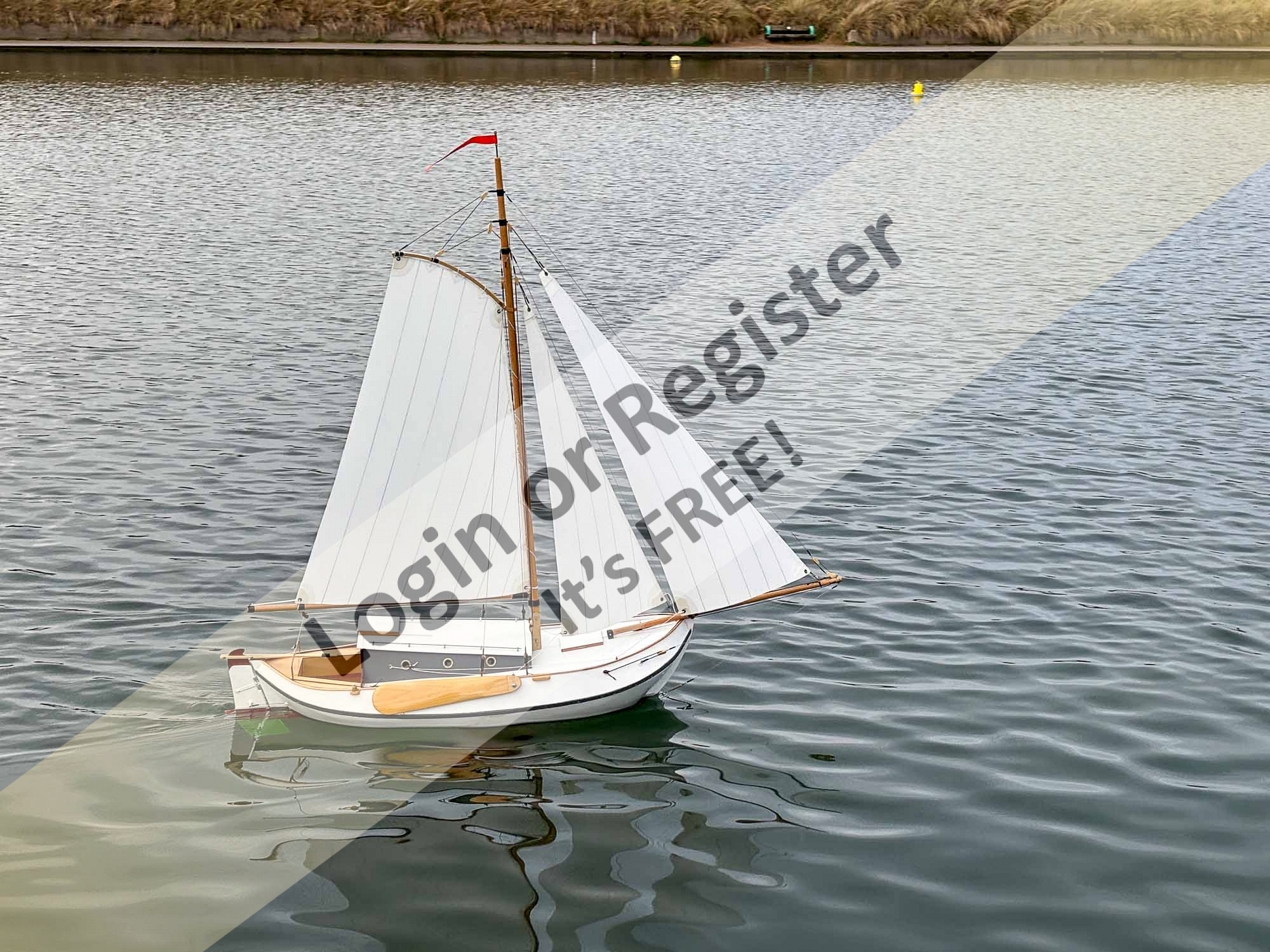

#108 4

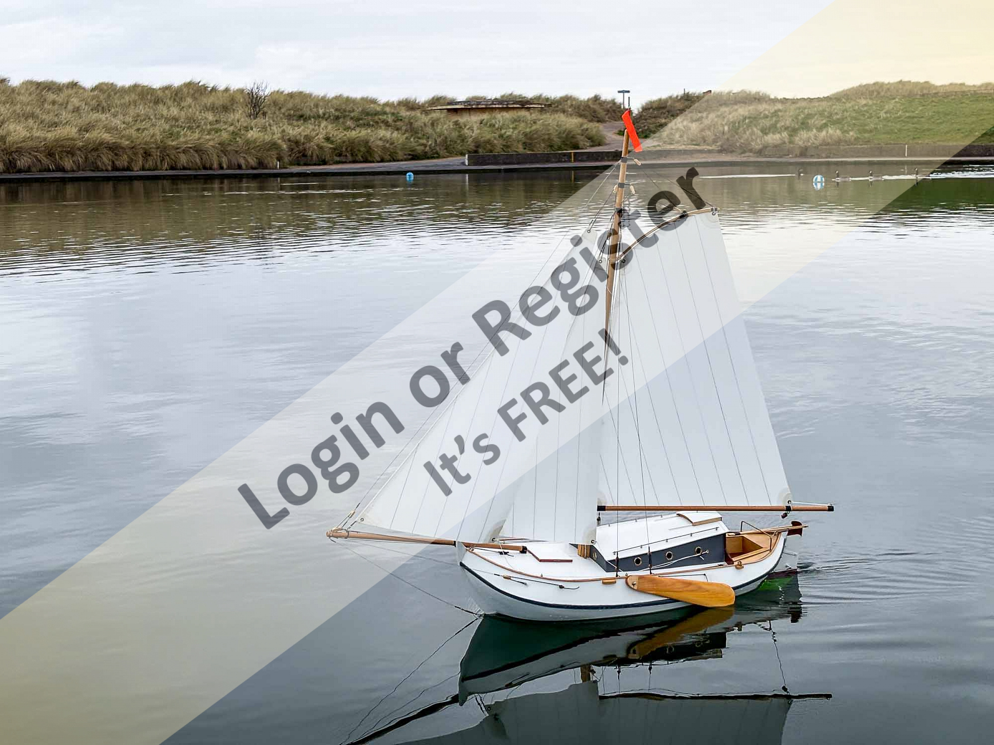

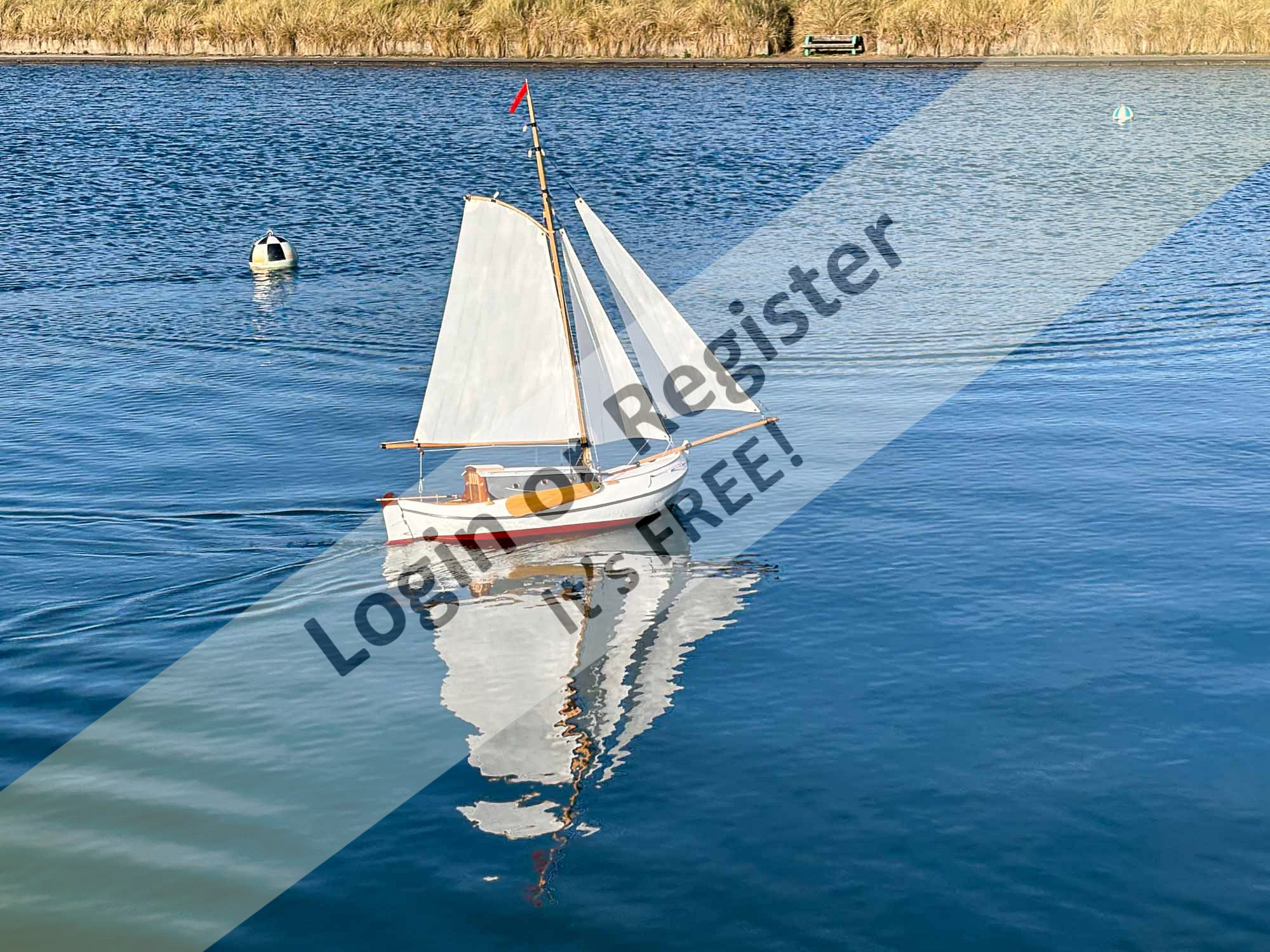

Dutch sailing barge

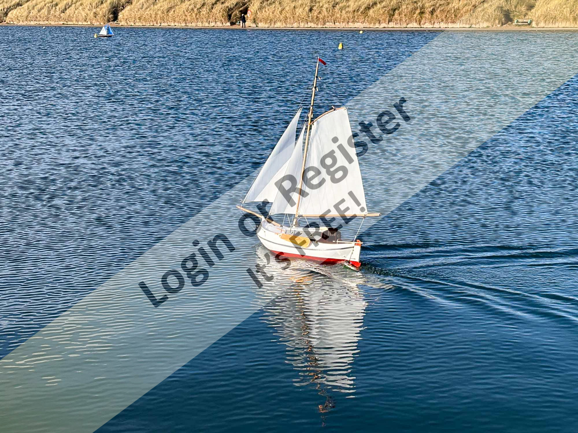

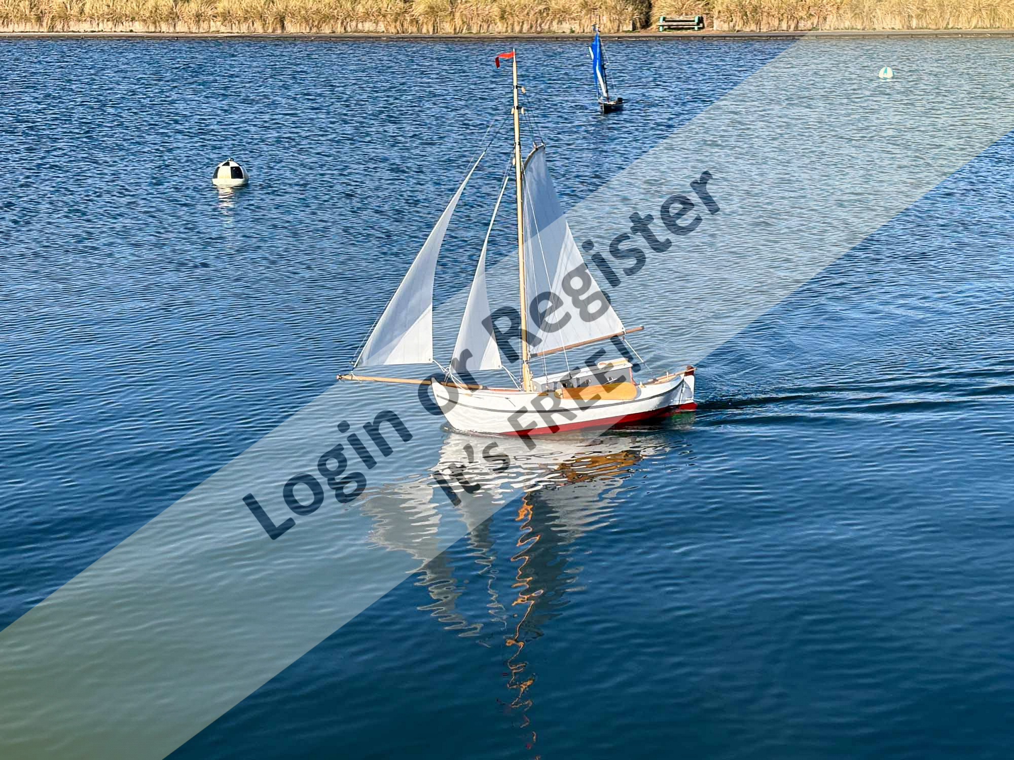

3rd sail
Sailed very well without the rudder extension - no leaks and no caught sheets
Success !
Sailing at Fleetwood - Building Katie
Liked by Razor1955 and EdW and

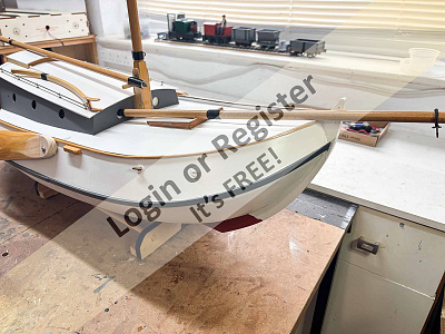

Dutch sailing barge

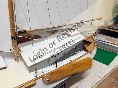

Made a few small changes, minor rigging, added some ballast to the stern and shortened the mast, lowering the take of point of the jib. Looks better and sails fine. However, still have a small leak via the prop shaft, so that does need some thinking about for a solution.

#105 4

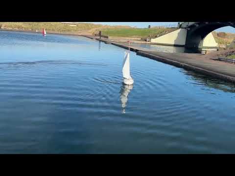

Dutch sailing barge

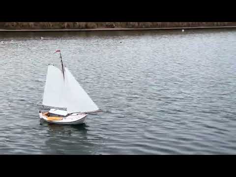

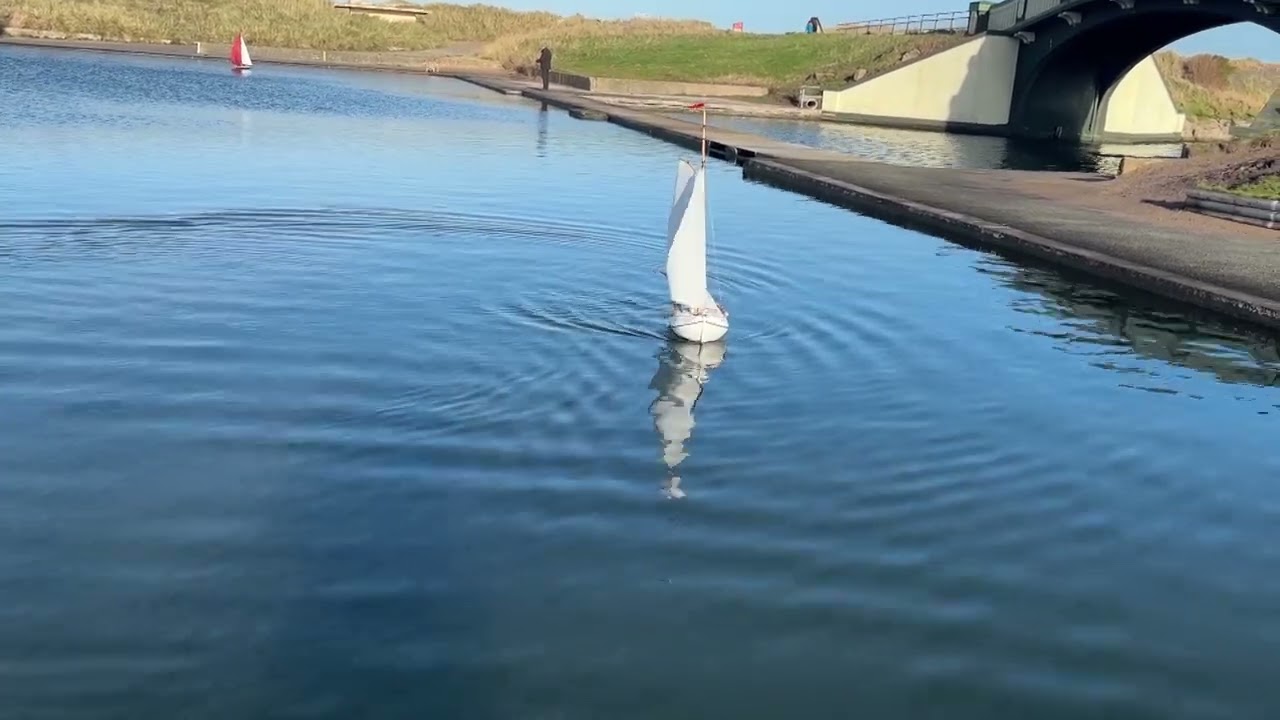

Took the boat for a first sail today. This has been delayed as the local weather has been so windy. Sailed better than expected - a couple of small issues and a small leak - which I think is the prop shaft, so will need to explore that. However, its more likely to be the join between the cockpit and deck edge, as the cockpit is removable.
This is a link to a YouTube video. Trying to hold the phone and control the boat with three servos was a bit of a challenge - but hopefully shows the general idea.
Liked by EdW and Northernflotsam and

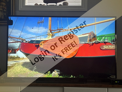

Dutch sailing barge

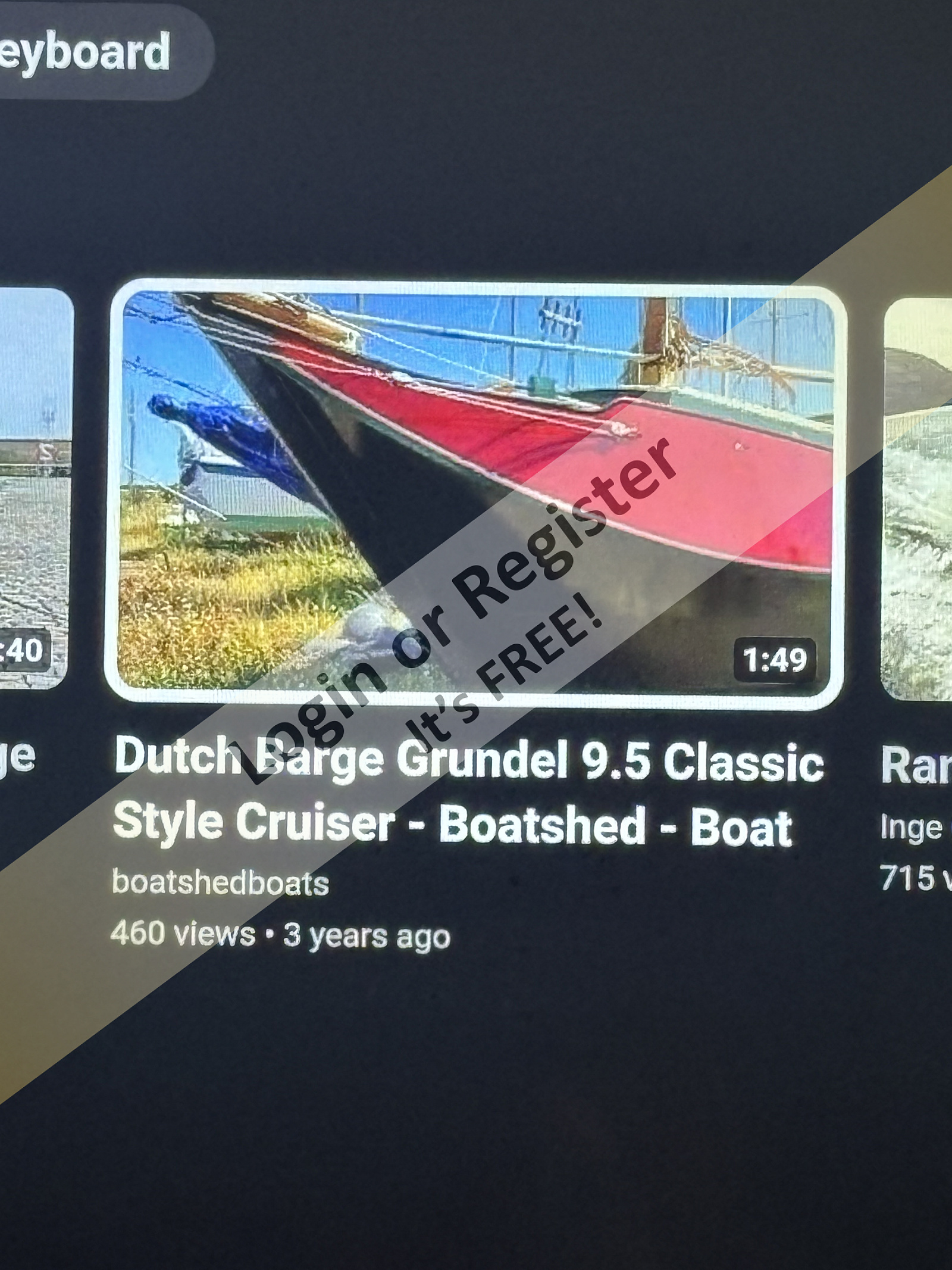

I came across this video on YouTube today, just type in the title in the search box of YouTube.
Liked by EdW and chugalone100 and

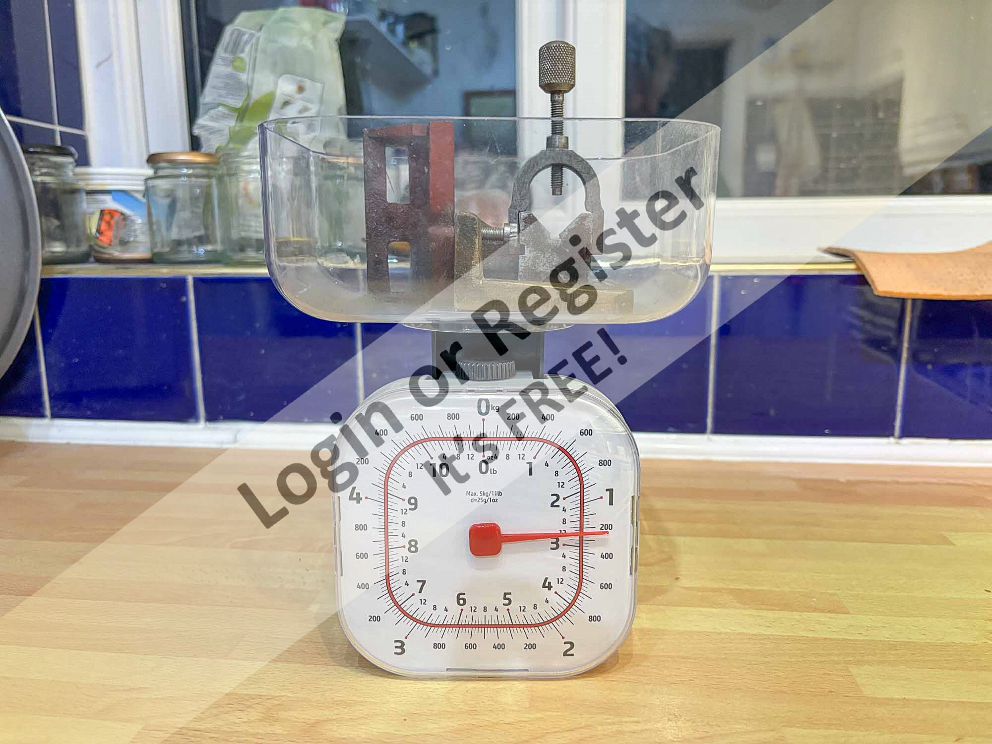

The idea is to leave the lead weight removable until after a few sails, to ensure its correct. Adjustments can then be made.
As for the saucepan - others are available - the one in the photo hadn’t been used for years and I’d cast lead in it previously.

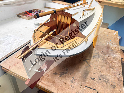

Dutch sailing barge
Made some progress and the hull etc and fittings are just about done. The last real task was to cast some lead - just a small amount. This is never going to be a "heavy weather" model. The lead will need some cleaning up and a coat of paint.
I warmed the saucepan and lead up on the kitchen cooker, before going outside for a final warm and pour.

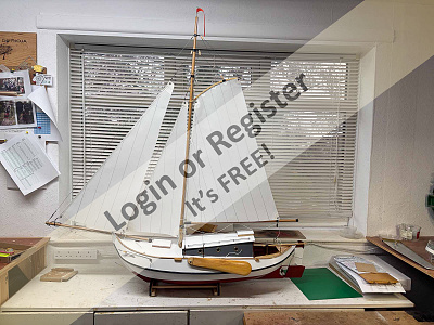

#91 4
Dutch sailing barge
Have made the sails, fitted and everything seems to work OK. There are some details to be added - winches on cockpit sides, a few more bits of rigging etc. The main challenge is to cast the lead and fit the keel - then a trial sail !
Liked by Mike Stoney and luckyduck and

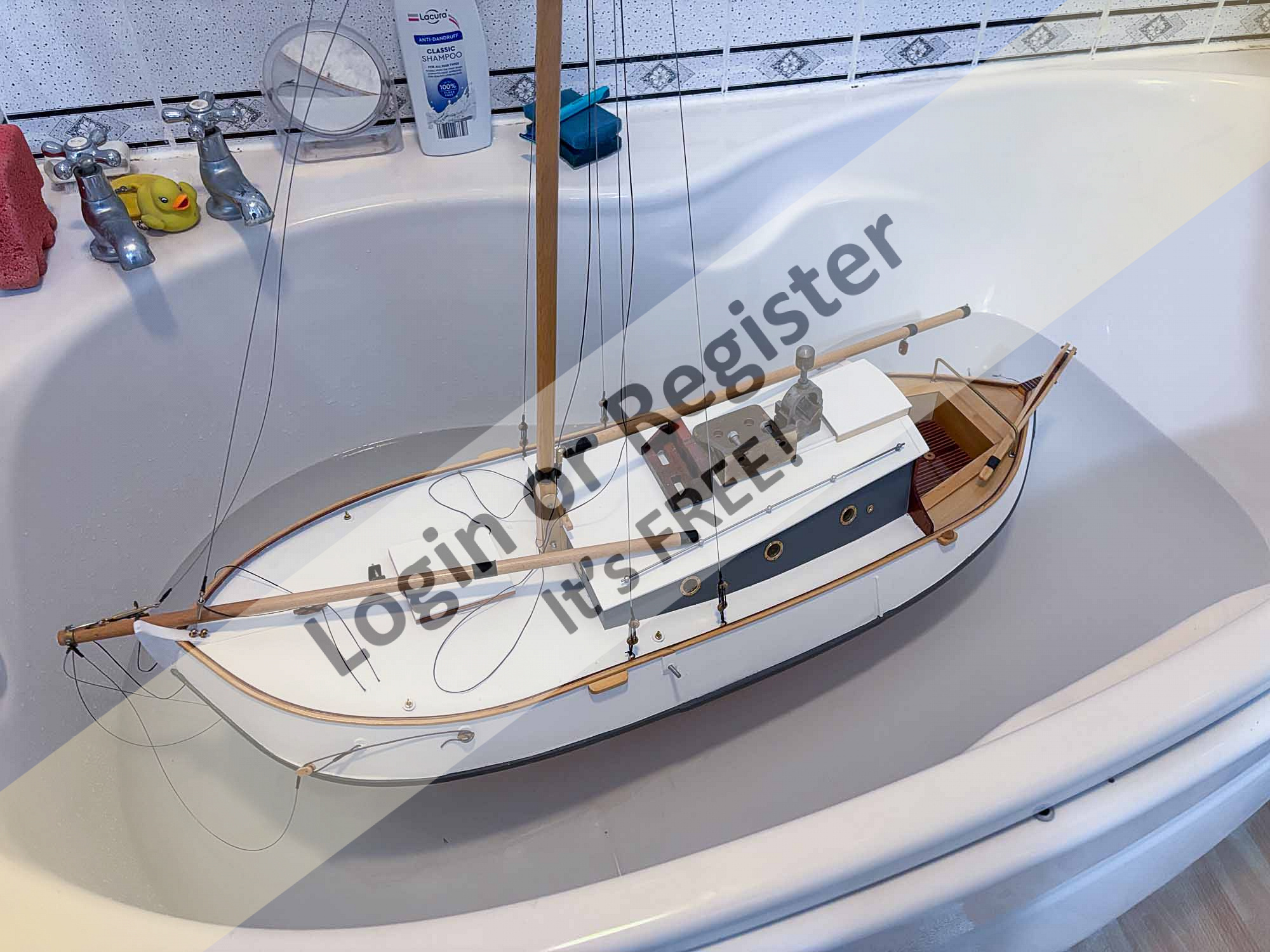

#89 4
Dutch sailing barge

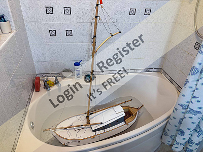

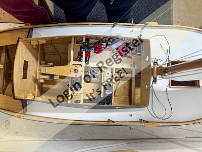

Have made a final float test - with all the RC equipment on board. Using some pieces of metal, it was possible to check how much weight was needed to load the boat down to the water line. This weight will be made by casting some lead shot and fixed to the end of the "false" keel.

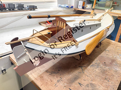

#80 4
Dutch sailing barge
Have completed the rigging and made some "paper" sails, as templates. Next step will be some "real" sails and then checking the operation of all the servos - the final task will be a float text and to consider how much lead will be needed - and there will be all those small details and finishing touches - which are forgotten until the end!
Liked by Rogal118 and EdW and

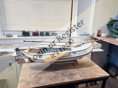

#79 4
Dutch sailing barge
Made a little more progress. The prop shaft has been fitted and works, even had a quick go in the bath.
The sail and rudder servos have also been installed, seem to work ok. The next stage will be the standing rigging, before making some paper templates for the sails.

Is this a Lemsteraak sailing barge?
Or
Grundel 9.5 Classic style cruiser
