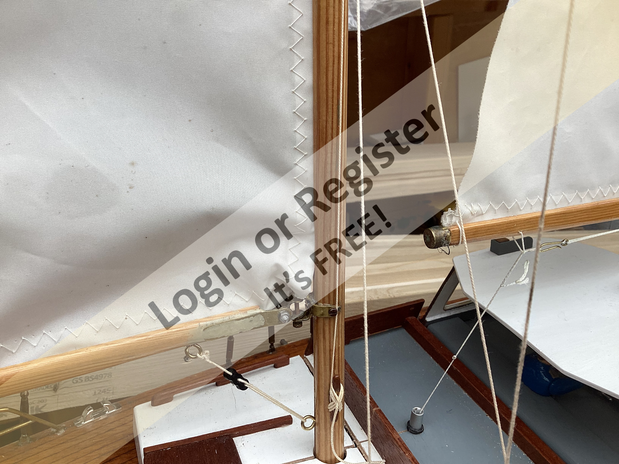

Hello everyone, AlessandroSP. The reason I intend to make new sails, is, the type fitted at the moment are a plastic material and I prefer “cambric cotton” which look better for this type of sailing ketch. My 1st IngaIV I made the sails having never sewn before and had never had a sail boat before either. I was completely a novice and to some extent still am. I have intended to rework the sails to give a slightly more area, and a little more roach to the main sail plus add roach to the booms as my 1st sails had none. Having plenty of material left over I shall make two sets which I feel will improve both yachts. I have also been toying with the idea of making a set of stowed sails and using the motor driven yacht for our steering competitions. This would look like the real thing then when entering port. I don’t have a photo of Inga with sails stowed but the enclosed photo give some idea what I intend to achieve. The other photos show the plastic sails against the set I made up.
Roger
Liked by Razor1955 and Peejay and

Hi everyone, Roycv, I think this is the first time I’ve actually viewed a photo of your Inga IV, and I must say I like the cabin woodwork, the lighter graining is mellow and very attractive, I am also surprised that you still have a one piece cabin, as you say it’s an pain removing the mizzen mast and rigging to open the hull up. A definite original design flaw!. As my 1st Inga didn’t have a rear cabin top when I acquired her I made a point of building the cabin in two halves. Which means I don’t have to derig her, not even when I go to the pond as I’m fortunate to have suv with a tailgate big enough to accommodate her in fully rigged state. Now my new acquisition has a one piece cabin so I’ve just de rigged her mizzen mast and with a fine blade in the band saw cut the cabin into two sections across the beam. Then I cut the rear cabin in two, forward and aft along the centre line. Put her all back together and rigged her up. All I have to do now is tidy the joints up, job done access to the hull without derigging.
Roger
