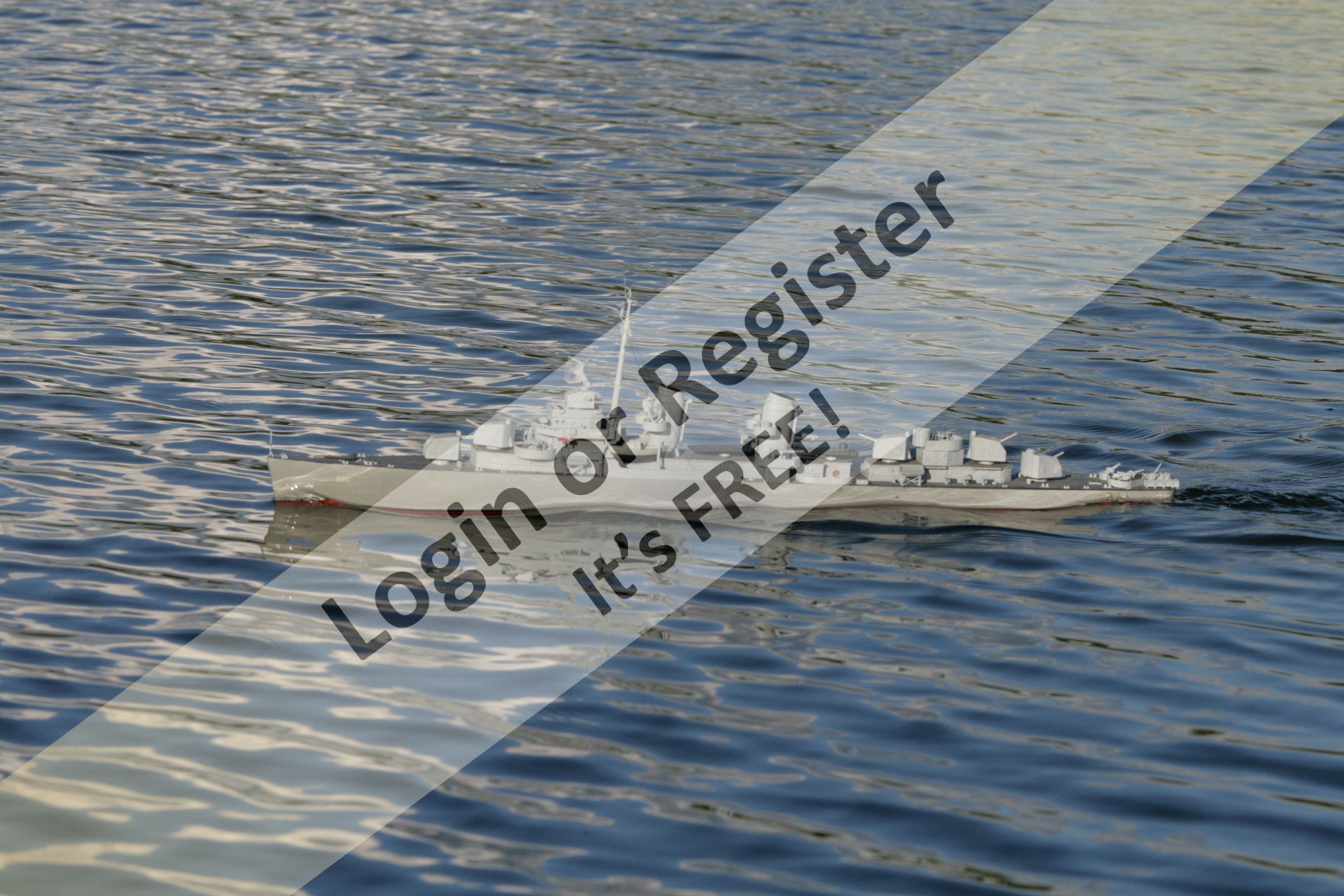

My USS Melvin (Lindberg kit) has a different system. Up-down on the left stick controls the power to both motors, left-right on the left stick controls the balance between them. So I stop both motors and put the stick over one motor will run ahead and the other astern. The motor control is a home designed and home built job. I built the USS Melvin in 1979 when I was home on leave from the British Merchant Navy. Since the only fault has been a failure of one power transistor.
I normally run the USS Melvin on my 4 channel Futaba transmitter but sometimes on either of my 6 channel Futaba transmitters.

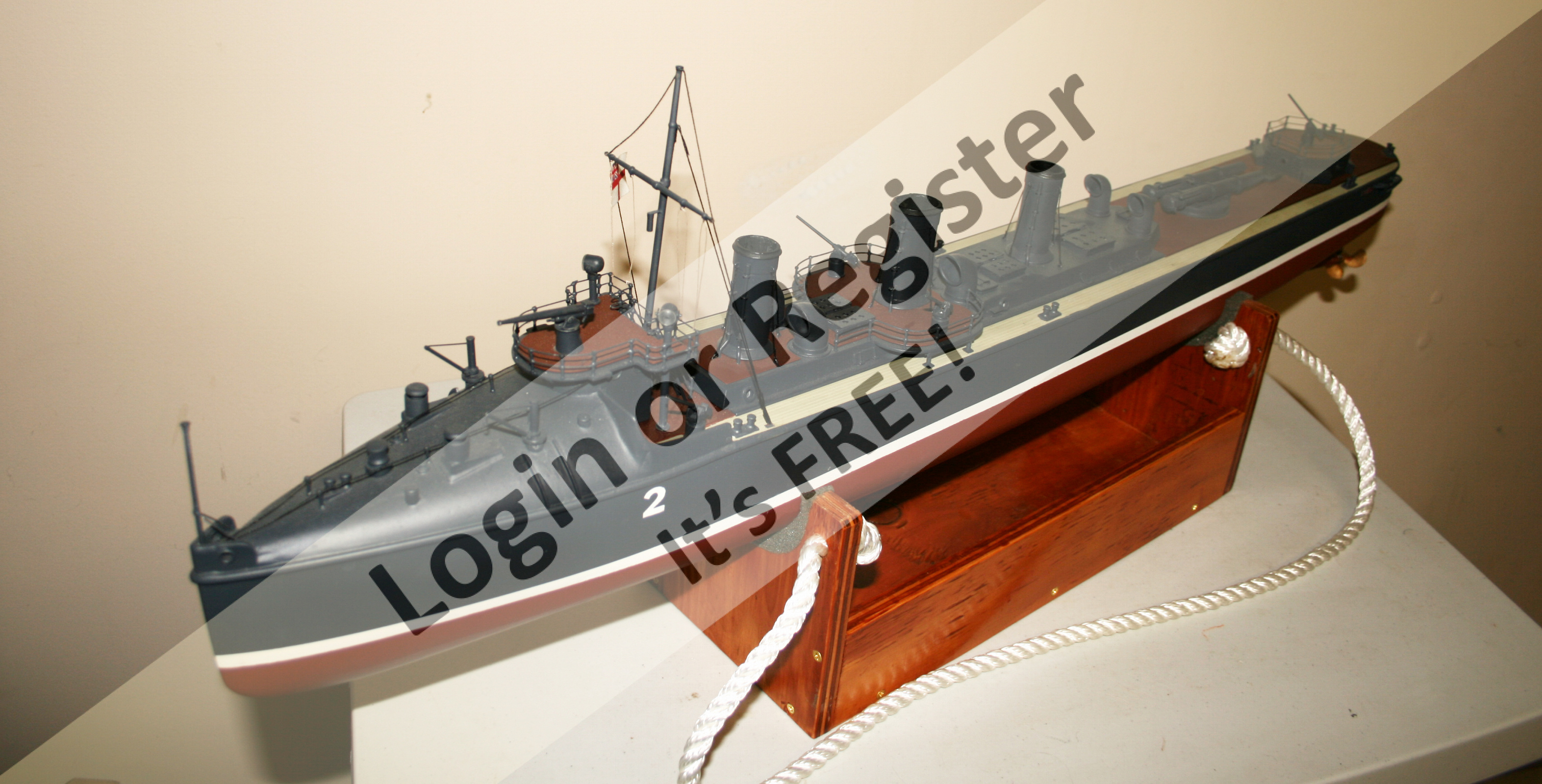

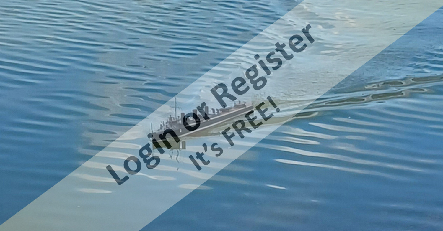

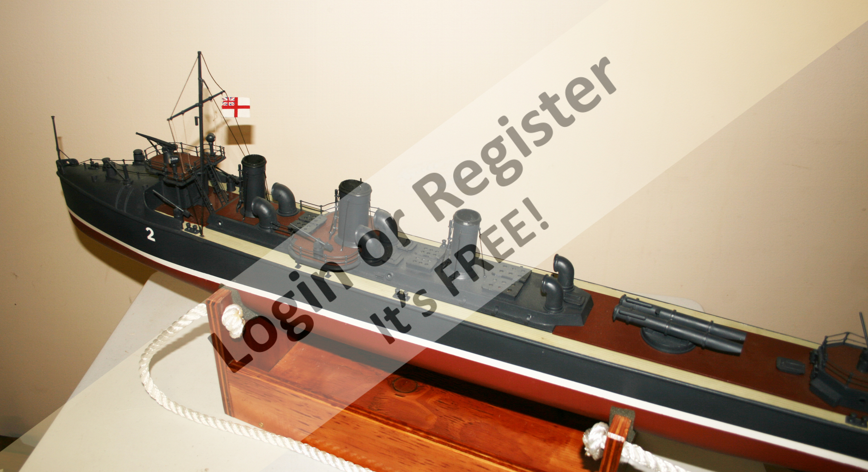

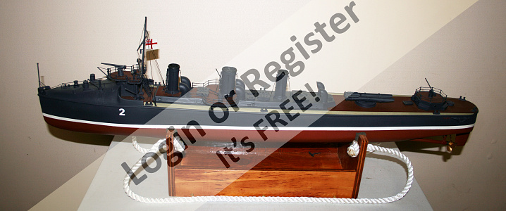

Thanks for the compliment!
The model is a "C" class destroyer (also called 'Star" class) they were built by Palmers on Tyneside in north east England in 1897-8. It is 3 feet long and built 'bread and butter' from 1/2 balsa and sheathed with fine glass fibre and polyester resin.
The superstructure is various thicknesses of EverGreen styrene sheets.
The conning tower and forward gun platform are aluminium alloy as are the guns, anchor davits and mushroom vents. I used my Toyo ML 210 lathe to make those.
Thee funnels and vents were 3D printed by the local library from STL files that I made. I have since bought a 3D printer.
I still have to make the torpedo davits, anchors and the ship's boats.
The photo of it sailing on Lake Mendota (about 100 miles west of Chicago) was taken on my wife's phone. When the lake thaws and I get out sailing again I'll get some better shots of it.
