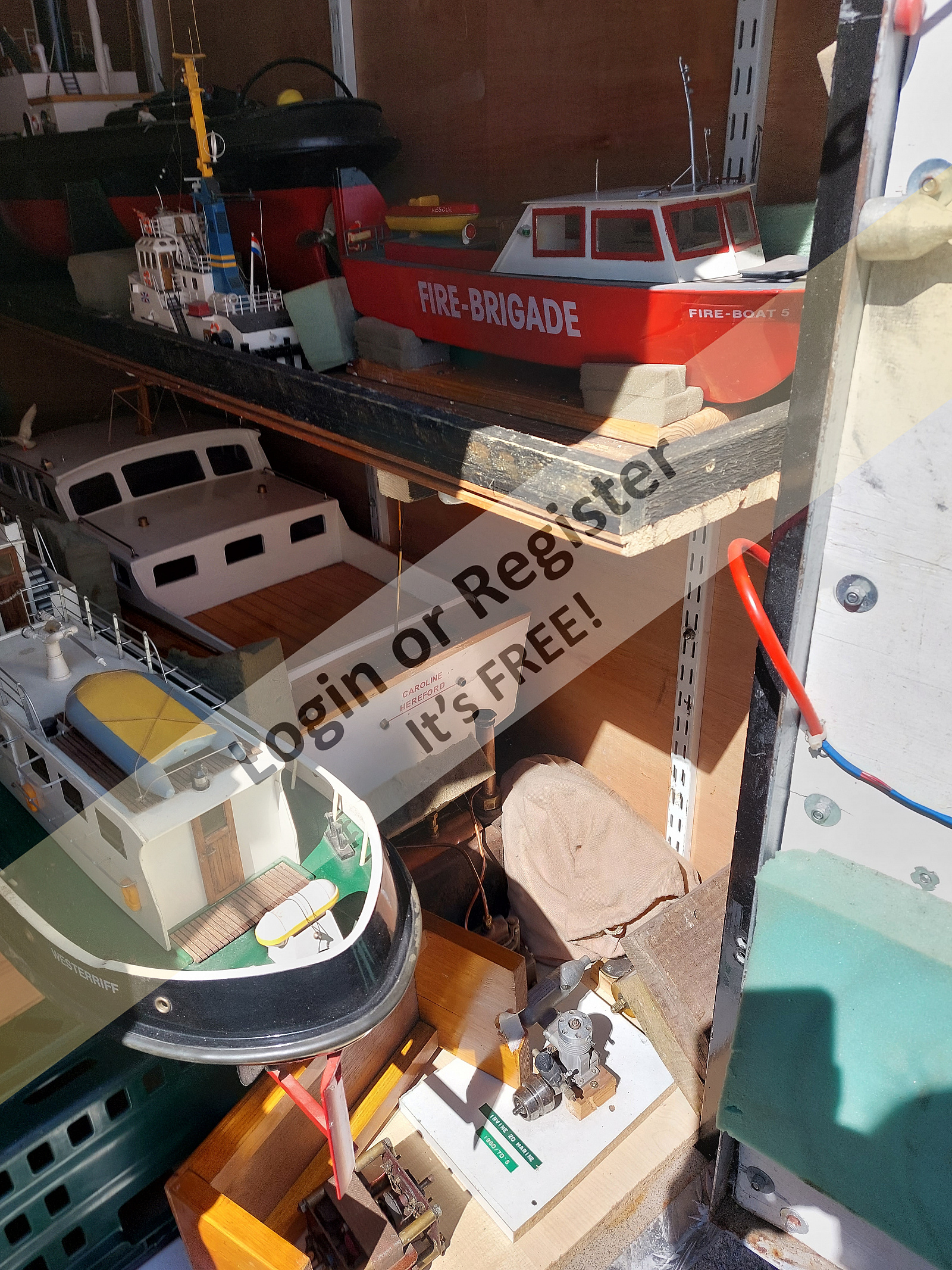

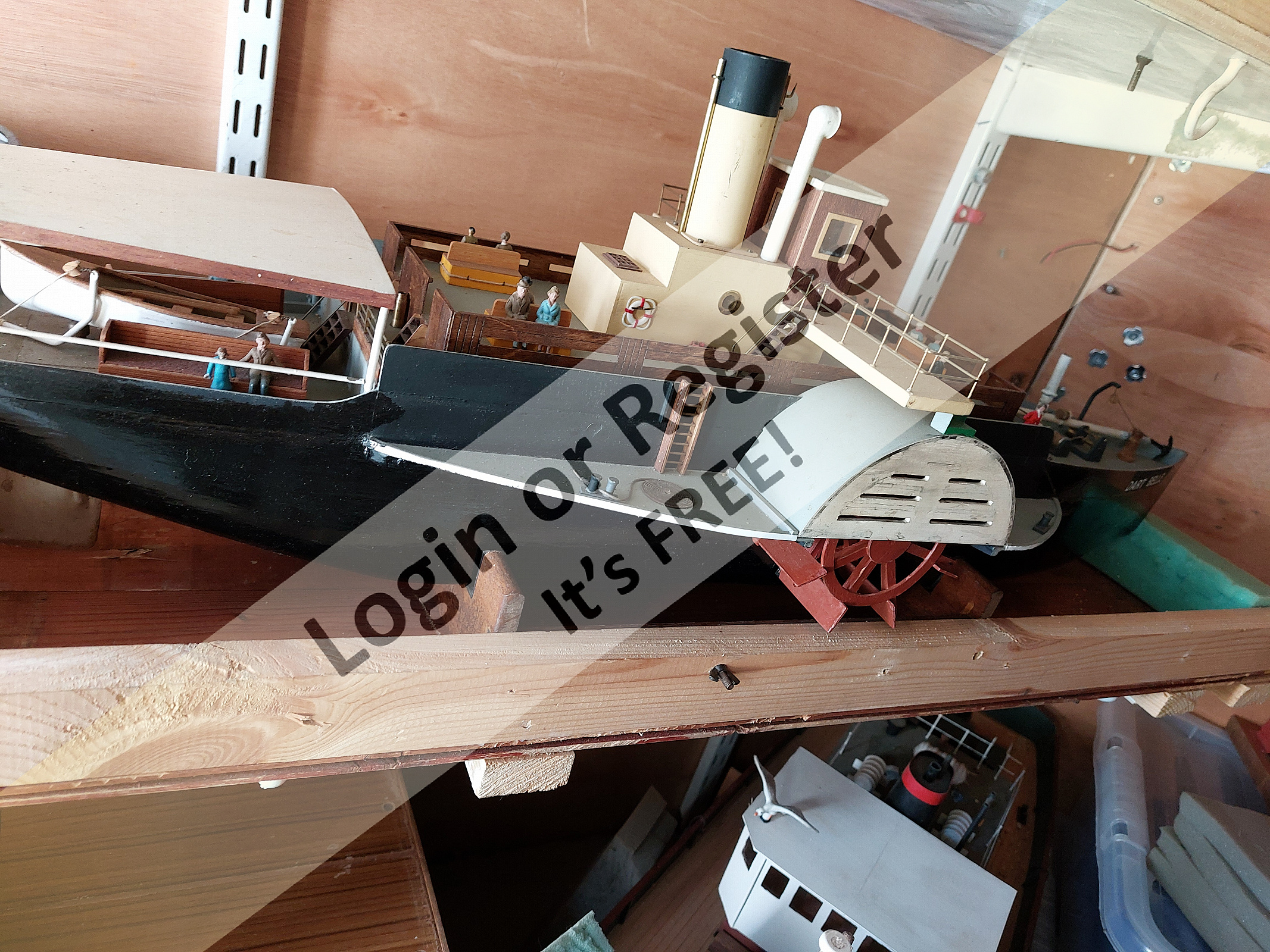

Most damage to the paint occurs during transit or accidental mishaps.
I've got models of varying ages some 80 years or older.
Most have paint that is over 10 years since last refurb. I transport 100's of miles each year going to shows and exhibitions also sailing days.
All my boats except 1 travel on their display stands either in the trailer or the back of my car.
So far I've only had 3 serious mishaps damaging models in transit because of emergency stops to avoid accidents.
Normally my models get a repaint only if damaged, or if when they are given to me require any restoration or repair work.
Pictures show my mode of transport and models inside the trailer.
Cheers Colin.
PS. Car has now been changed to a 4x4.
Fair winds and calm waters,
COLIN.
