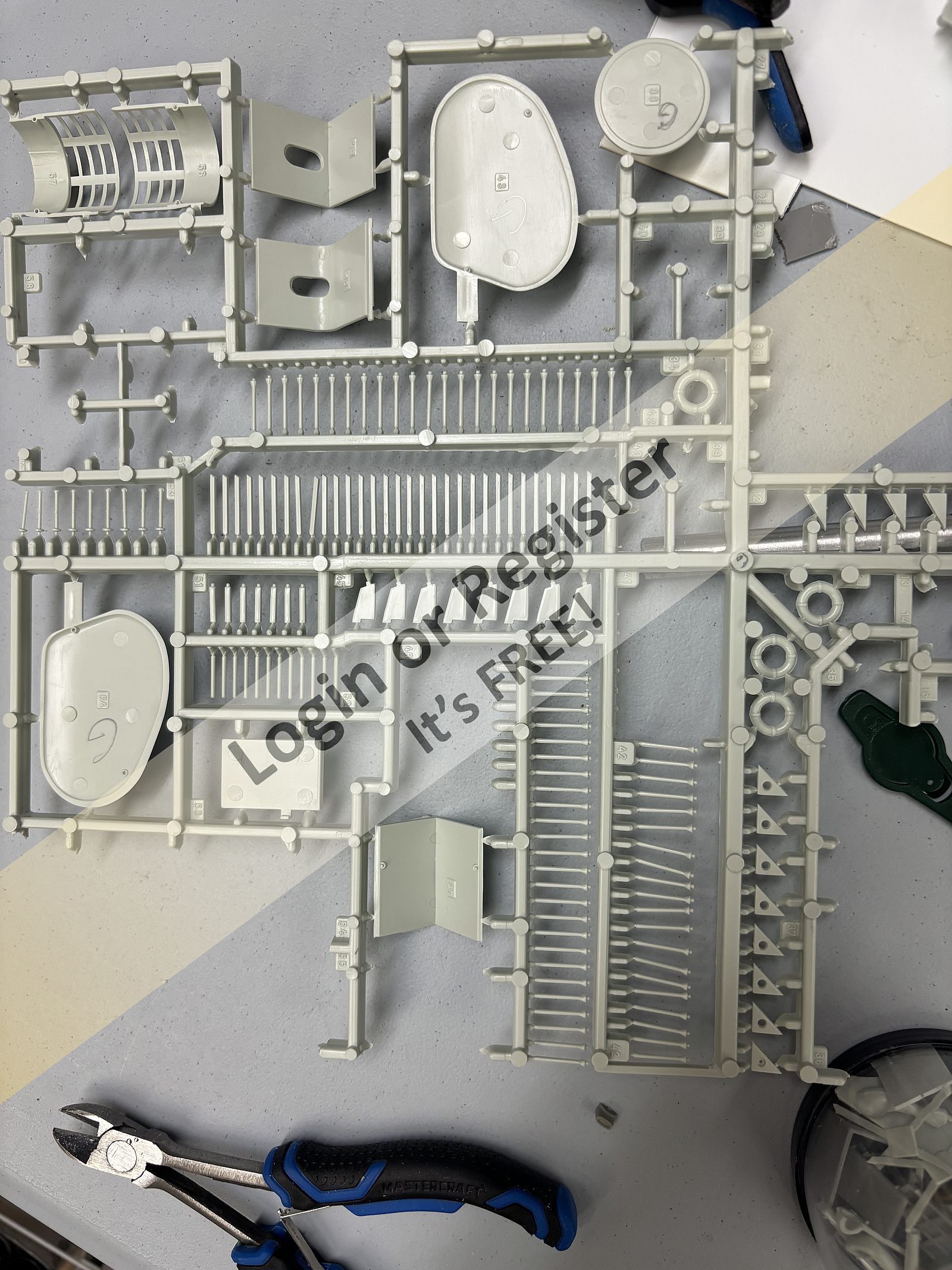

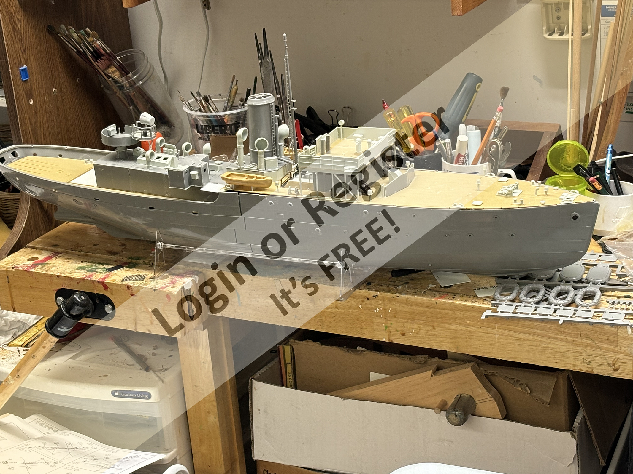

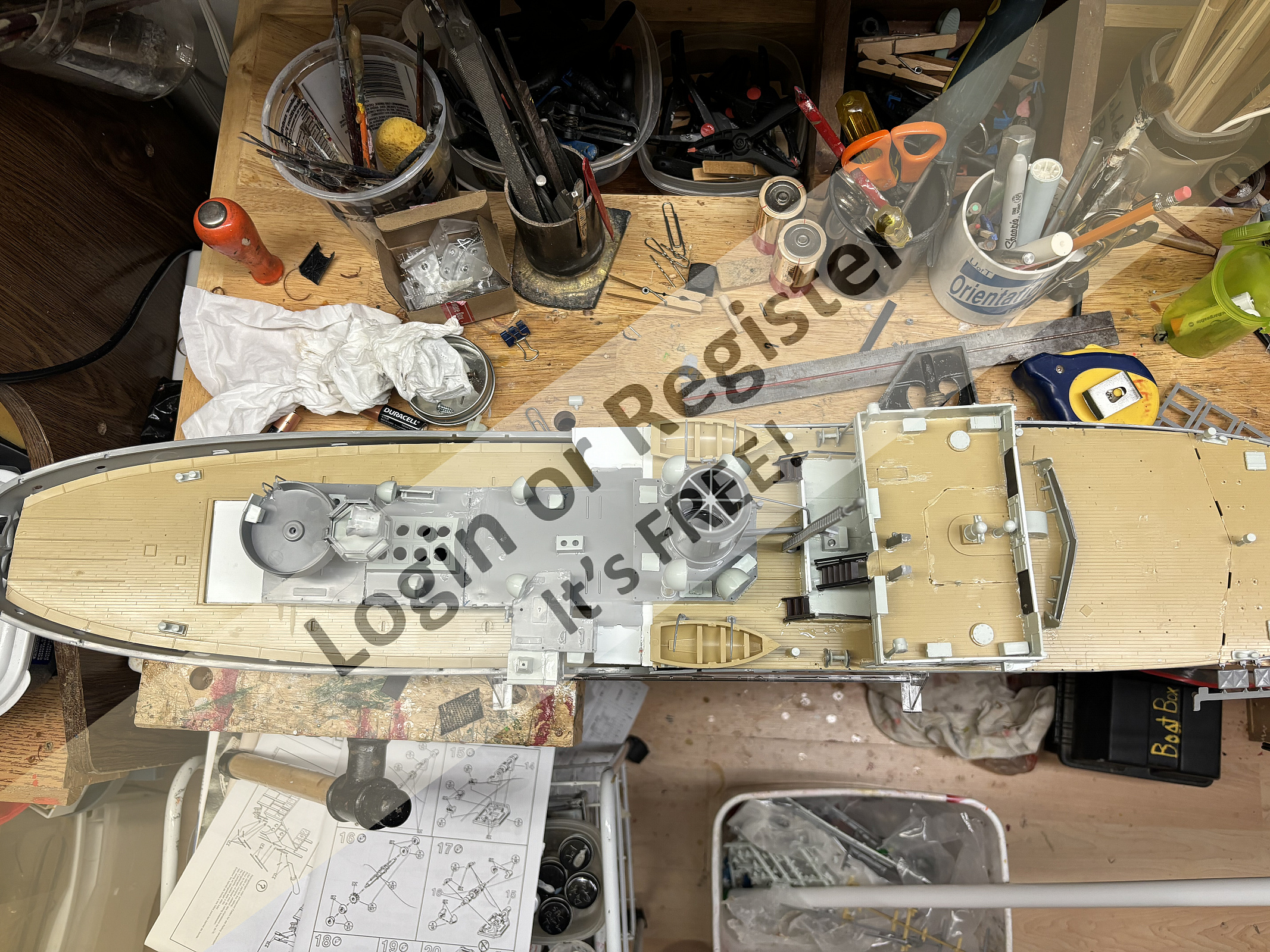

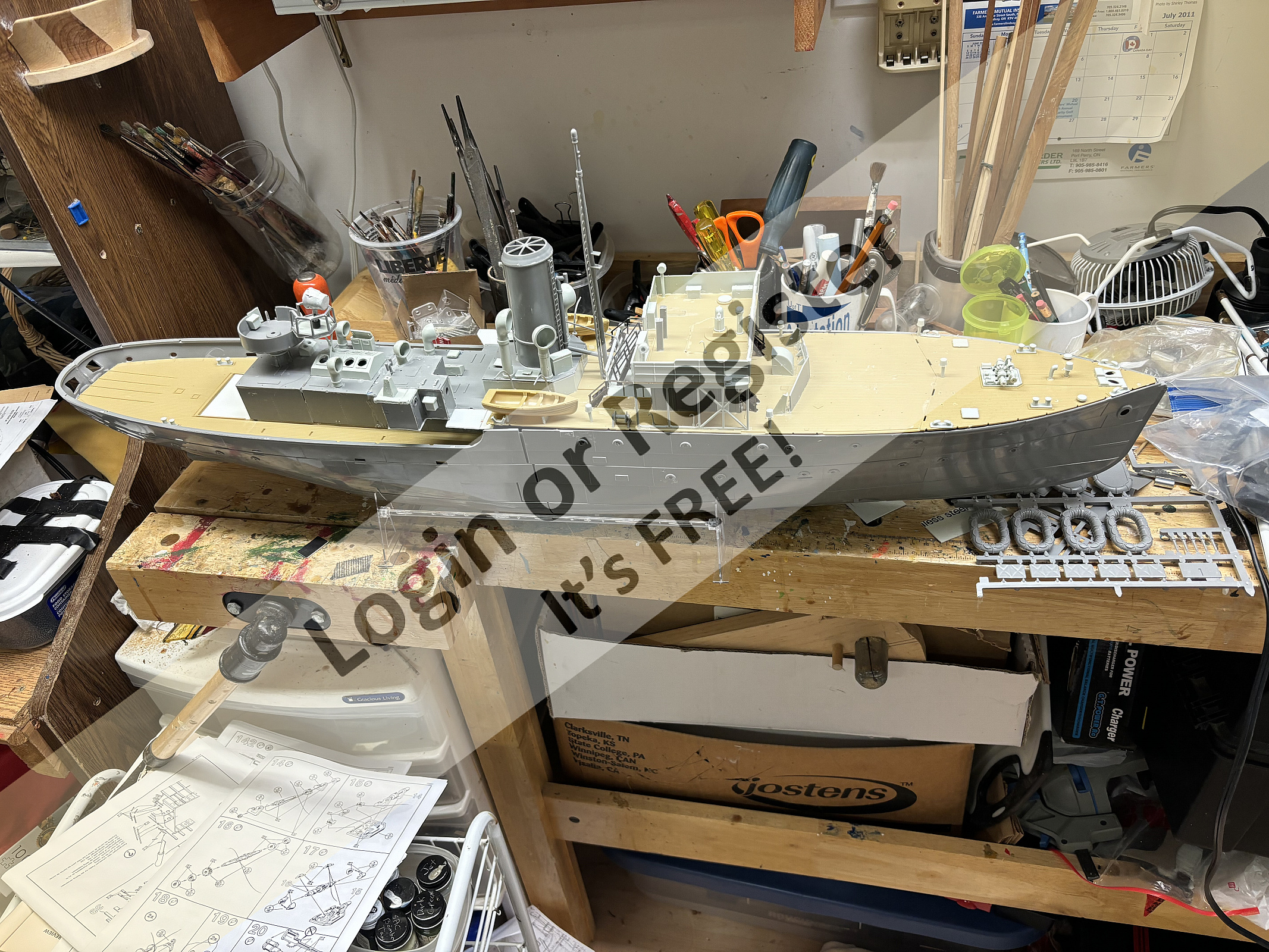

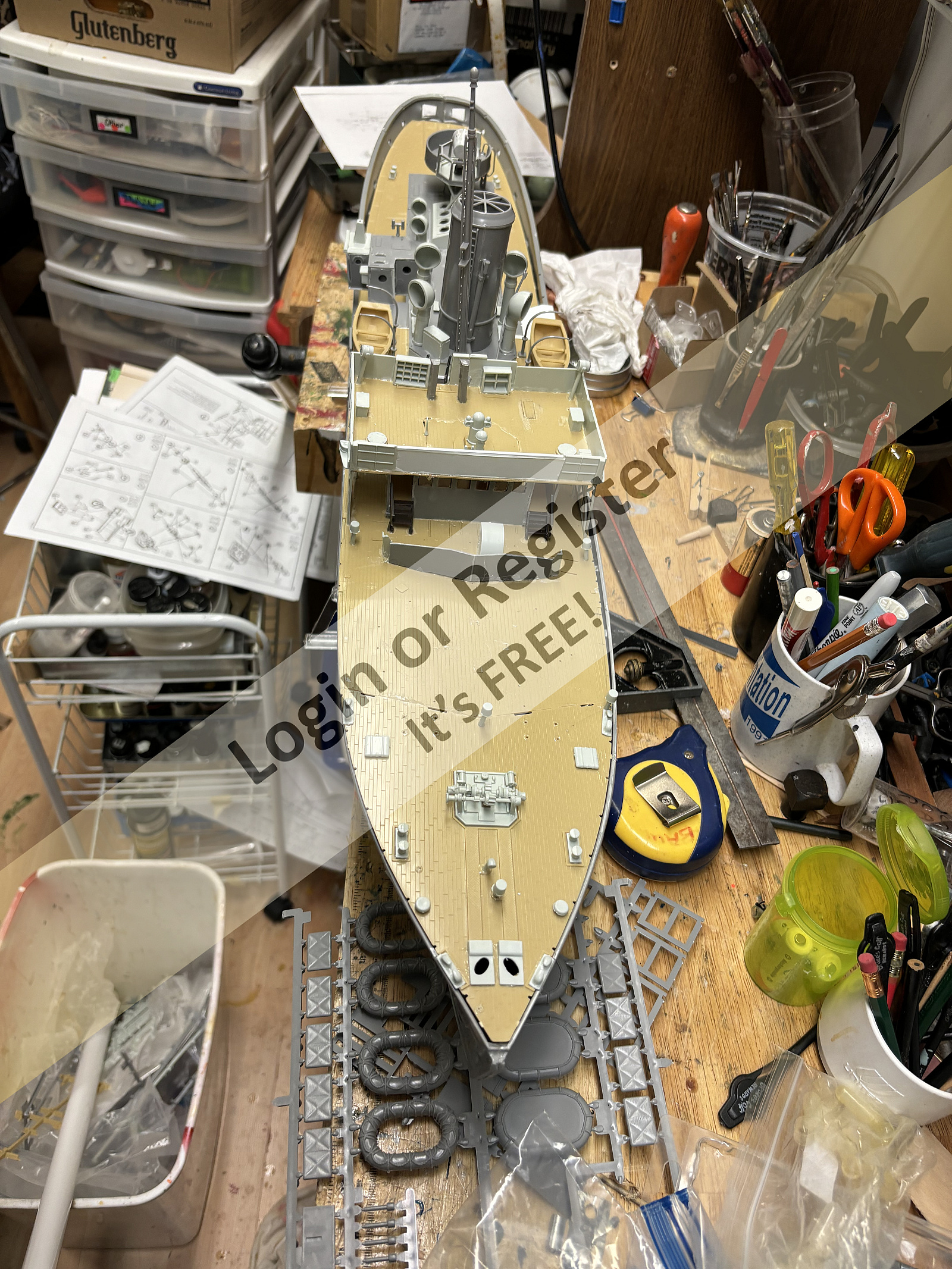

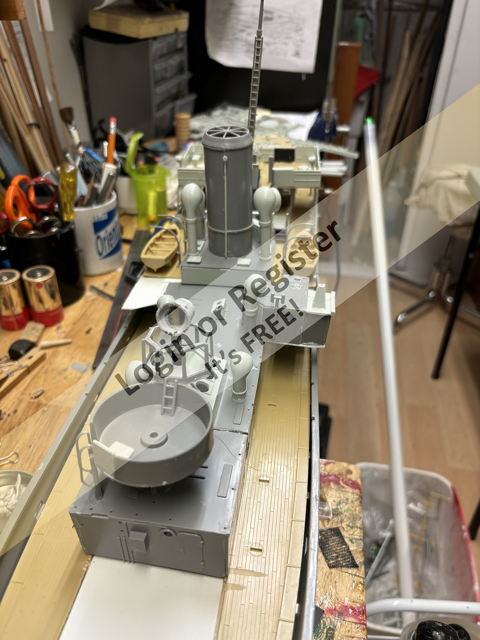

    First of all this old plastic model kit was bought for $35 and is being altered to represent the Research vessel of 1956 prior to its refit in Montreal. I am not buying parts, just making them as required such as Samson Posts forward of the Bridge. It also needs a winch on the aft deck.

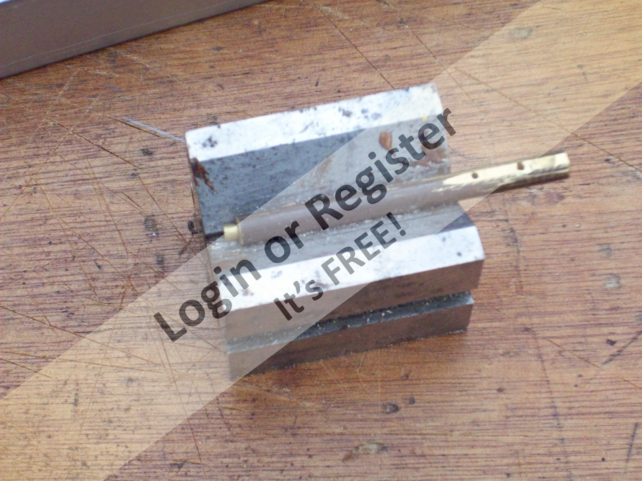

    Stanchions can be a real problem. I bought some soft metal cast ones about 1.5cms high and they were too fragile to be anything but on a static model.
    I have in a few cases made my own with 2 brass tubes (for thickness) drilled to take the rail holes. I made me a jig with this close fitting double tube and spaced holes for drilling down and making sure the length and spacing was constant.
    These were 2.5cm high and had to meld into taller supports. The tube stanchions had a small length of close fitting wire soldered in at the base and this locates them in the deck all at an even height.
    I have some etched brass ones a bit smaller but again very fragile or perhaps it is me! I find with varifocal lenses that I can easily knock things just below the level of my vision.
    See picture of simple jig with double tube epoxied into a Vee block. The tube has a small bend in it to grip stanchion tube to stop it rotating when being drilled. The drill is 0.7 mm and just about strong enough for the job. The continuous tube is pushed through measured and then cut.
    The rail wire I had to buy in a roll. To make it 'hard' take a length with one end in a vice and clamp the other and hold the clamp and stretch it about half an inch. You then have hard brass wire!

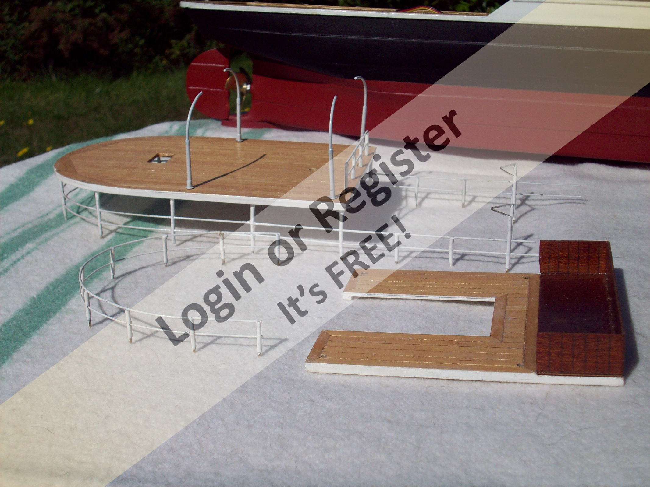

    The superstructure just before installation. All rails are soldered in place.

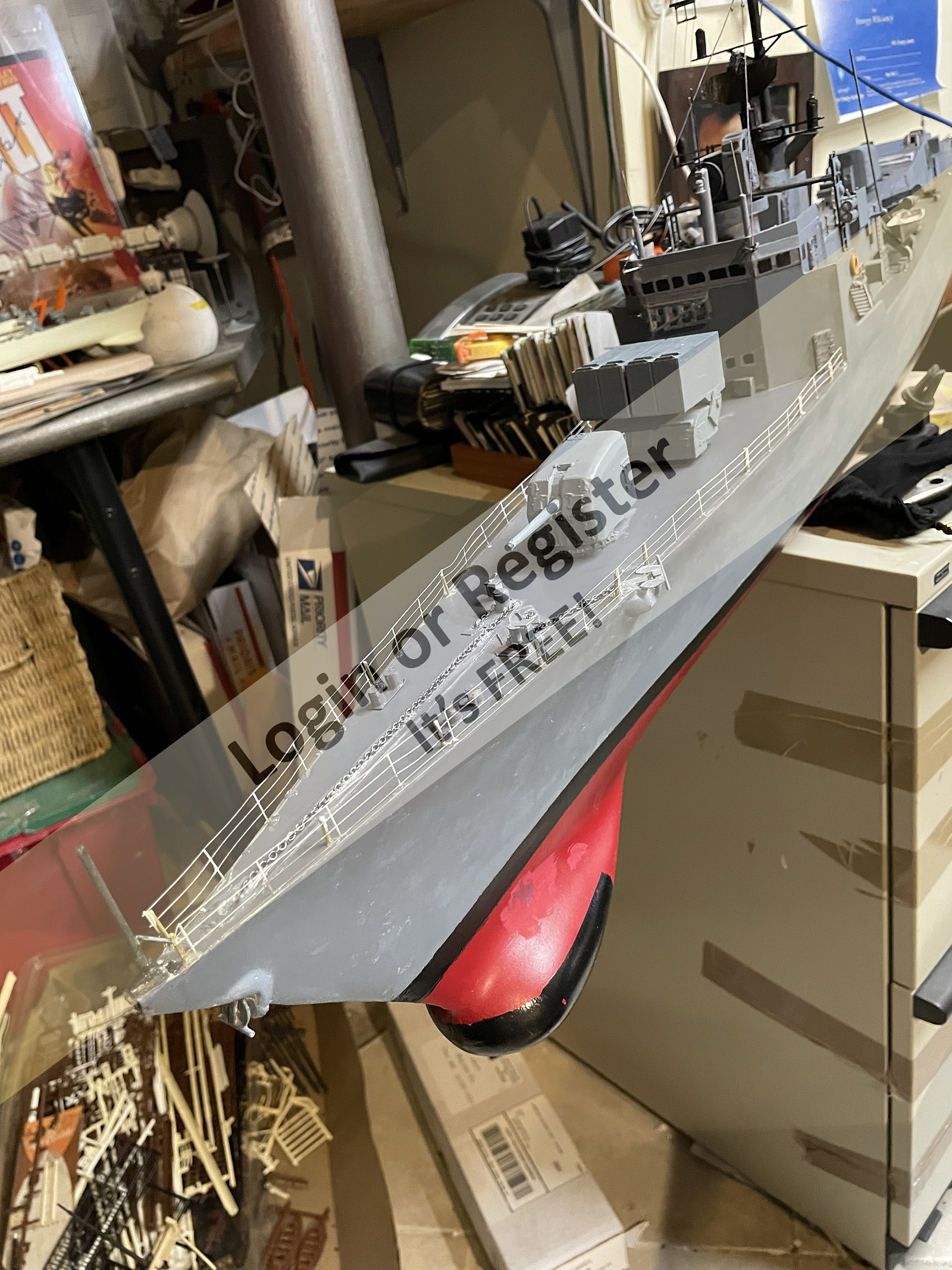

    I was at 1:96
    If you clip one horizontal layer it could work? I also tried putting brass rod vertical at some points to better support the thin railing. Tom may be able to suggest another vendor. My 3D never worked. The space between rails had filler material. I tried removing it but railing would brake other choice I tried was posts n wire. Itโ€™s expensive n a pain Anyway that was my experience enlarge my pic at railing area
