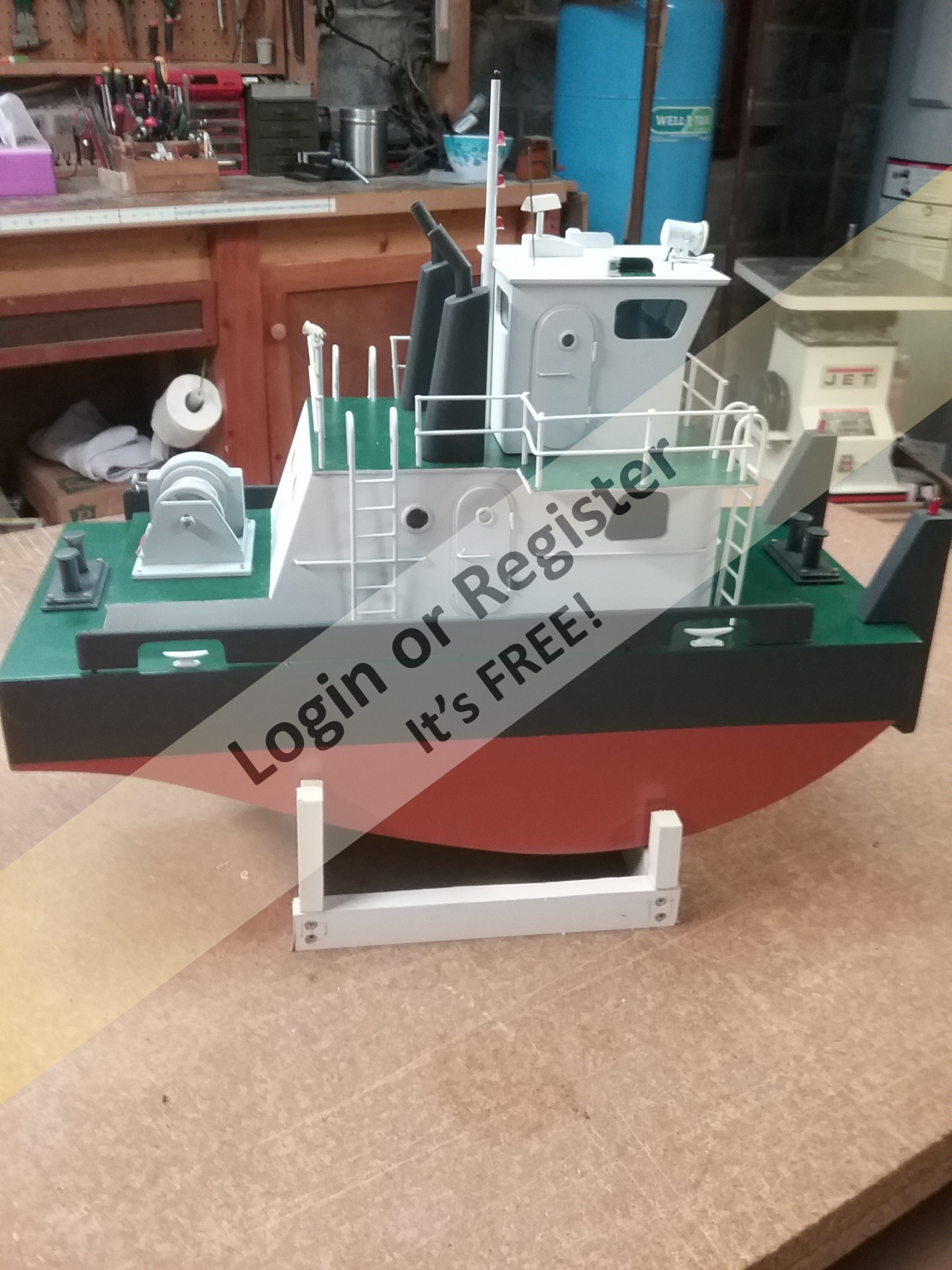

Beautiful work Greghiltz
Here is some of my soldering, now painted.
Little push tug has a mile of ladders and rails.
I will look into Antex, thank you

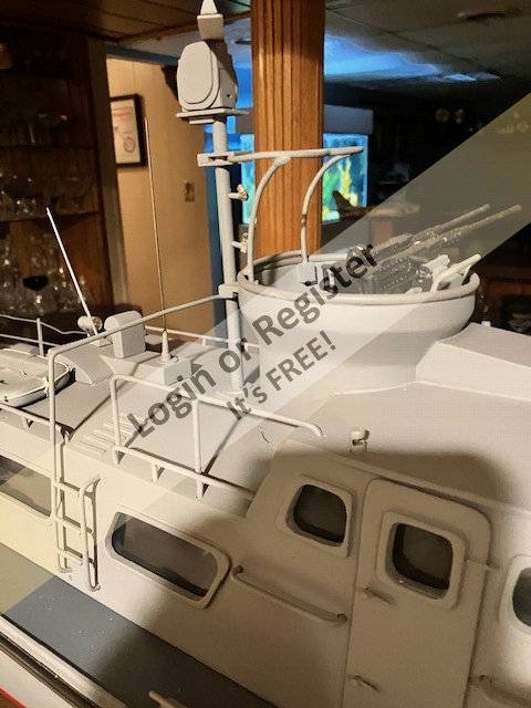

Couple tips from an old school solder guy who loves to work in brass -Your very old dollar is probably the best quality actual soldervyou have and is simply oxidized from age and exposure to the elements. Just run it through a piece of Steel Wool before use, and make sure your work pieces are very clean. I also use plumbers acid flux Padre even on Rosin core solder.
Much of newer solder is Chinese, and foes not work well, requires high heat and Soper clean surfaces.
I dare sayvi have over 20 brands and types of solder, and often need to try a couple for it to flow properly. It is very important to use a very high capacity electric soldering gun, not a pencil type 30 - 40 watt jobbing, use a good 120 to 140 watt one, or a good micro torch, as you really need to heat the fluxed mating surfaces to allow the solder to flow directly to the surfaces.
Hoping this helps , and ask away with further questions if wanted.
Couple photos to justify my credit.
