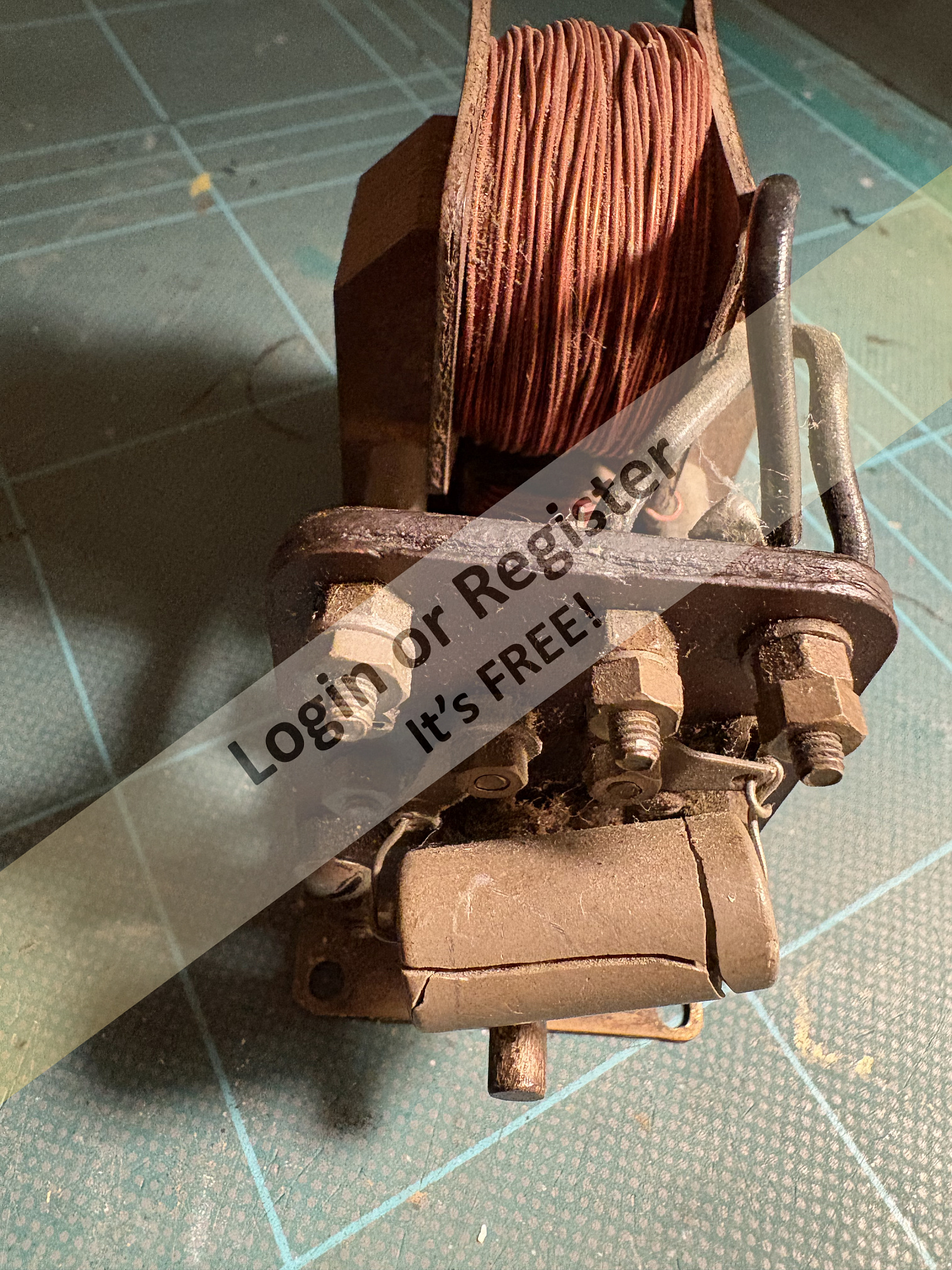

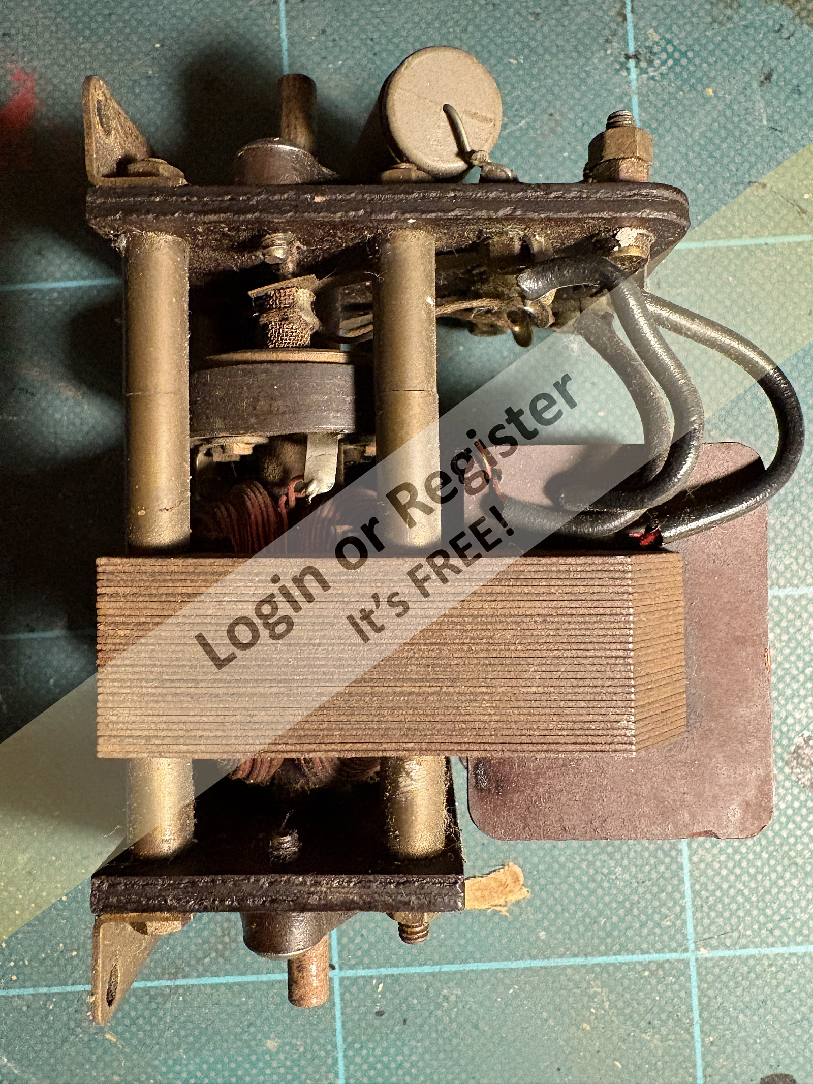

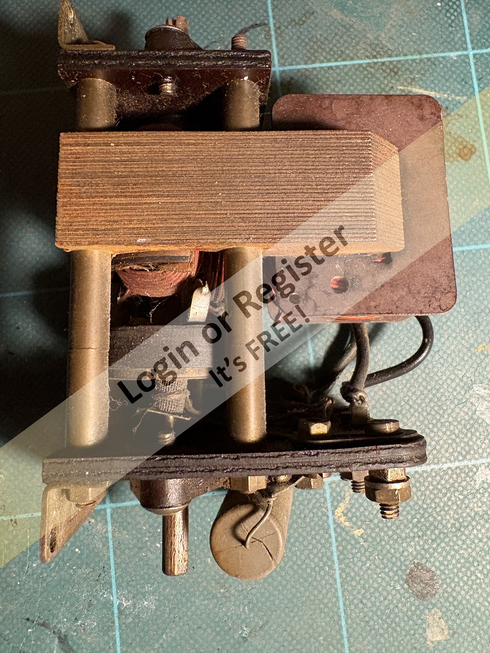

The capacitor can be thrown out as it does not belong.
Looks a little sad but a good clean will improve it no end. I think the 'Standard' is the best of Taycol motors, enjoy it!

I believe that the motor is a Taycol Standard?
I am not into electronics, but I guess that the cracked cylinder on the front of the motor was a type of "capacitor" that had been fitted to try to prevent interference from the motor affecting some other electronic device - such as a radio control receiver?
Because the grey coloured "cracked cylinder" clearly looks like it is "past its best", I doubt that removing it is likely to have any adverse affect?
The motor will be allowed to dry-out gently and the "capacitor" will be removed before I strip and clean the motor to tidy it up before adding any power to see it if actually runs.

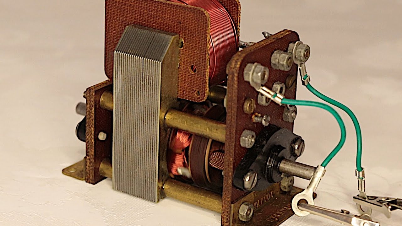

There always seem to be Taycol motors on sale on ebay. Currently there are a pair of Comet motors in tatty boxes. There were the first of the Taycols but had permanent magnets in them.
I have one in my collection and still working and even has that lovely smell of electricity oil.

#36 3
Early Radio Control Experiences
That is a really nice piece of nostalgia that you have there luckyduck. I was especially interested in your mention of the original Taycol motor still working perfectly.
I must find myself a nice working example of a Taycol motor to fit into one of my Classic Model Power Boat restorations as it would be a nice "time related" way to power one of them.
Strangely, almost all of the old hulls that I have picked-up to restore either had (or used to have) ic engines in them. I was hoping that something I took on would have a Taycol motor in it, but nothing has turned-up in need of a rebuild with one fitted in it yet!
