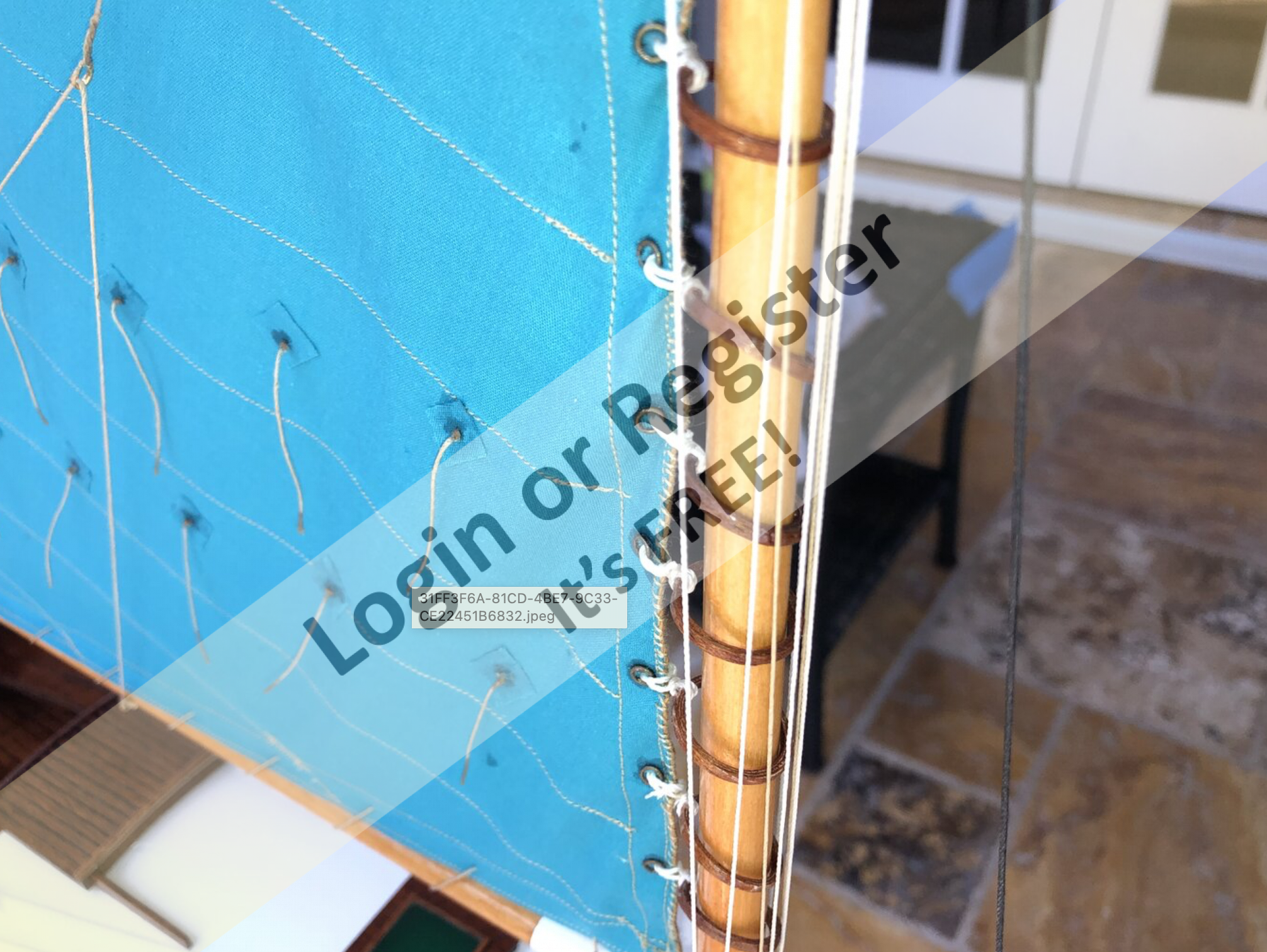

I had a problem back then: I couldn't create closed circles because I had already secured the mast with the crosspieces, so I couldn't thread them in anymore.
I had to find a way to gradually close them around the mast.
It wasn't easy because not even the cyanoacrylate glue would hold them together.
Anyway, congratulations to both of you for your ingenious and effective circle-making methods.
Your circles have exceptional realism, well done.

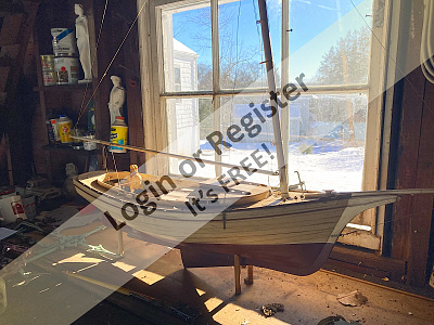

Jumpugly,
I hold your father’s sloop in the highest regard. The planking, in particular, imparts a remarkable degree of realism. With a modest amount of thoughtful restoration, the model has the potential to become an exceptional piece—one that stands as a lasting tribute to your father’s skill and craftsmanship.

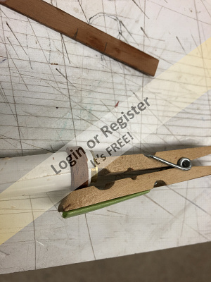

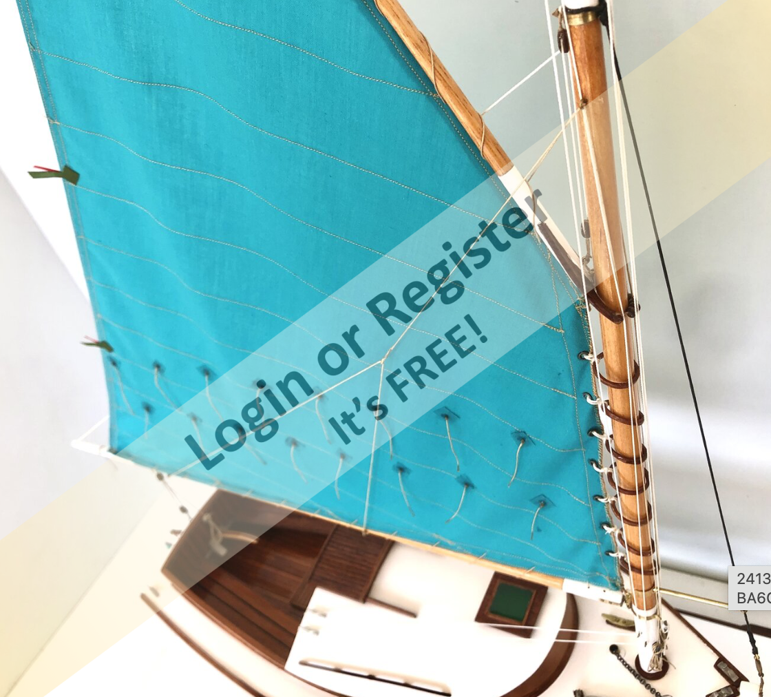

RossM,

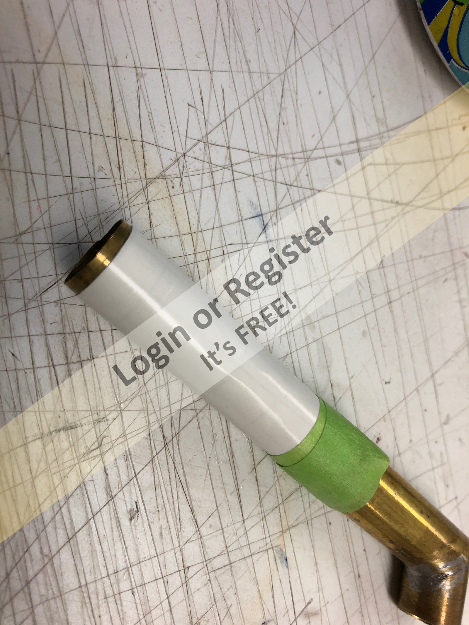

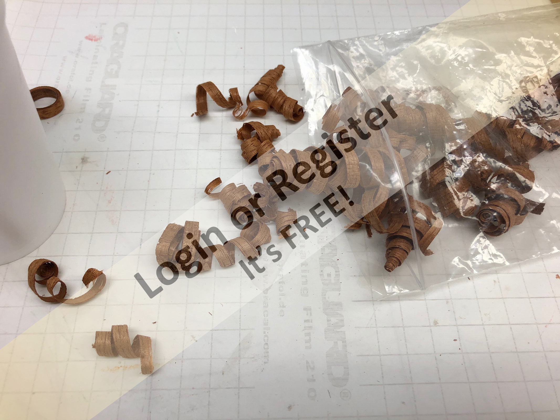

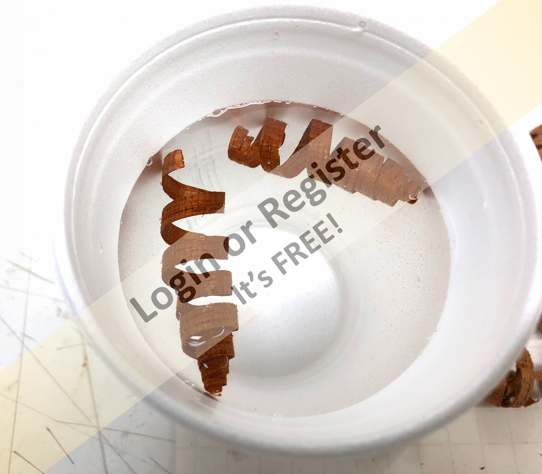

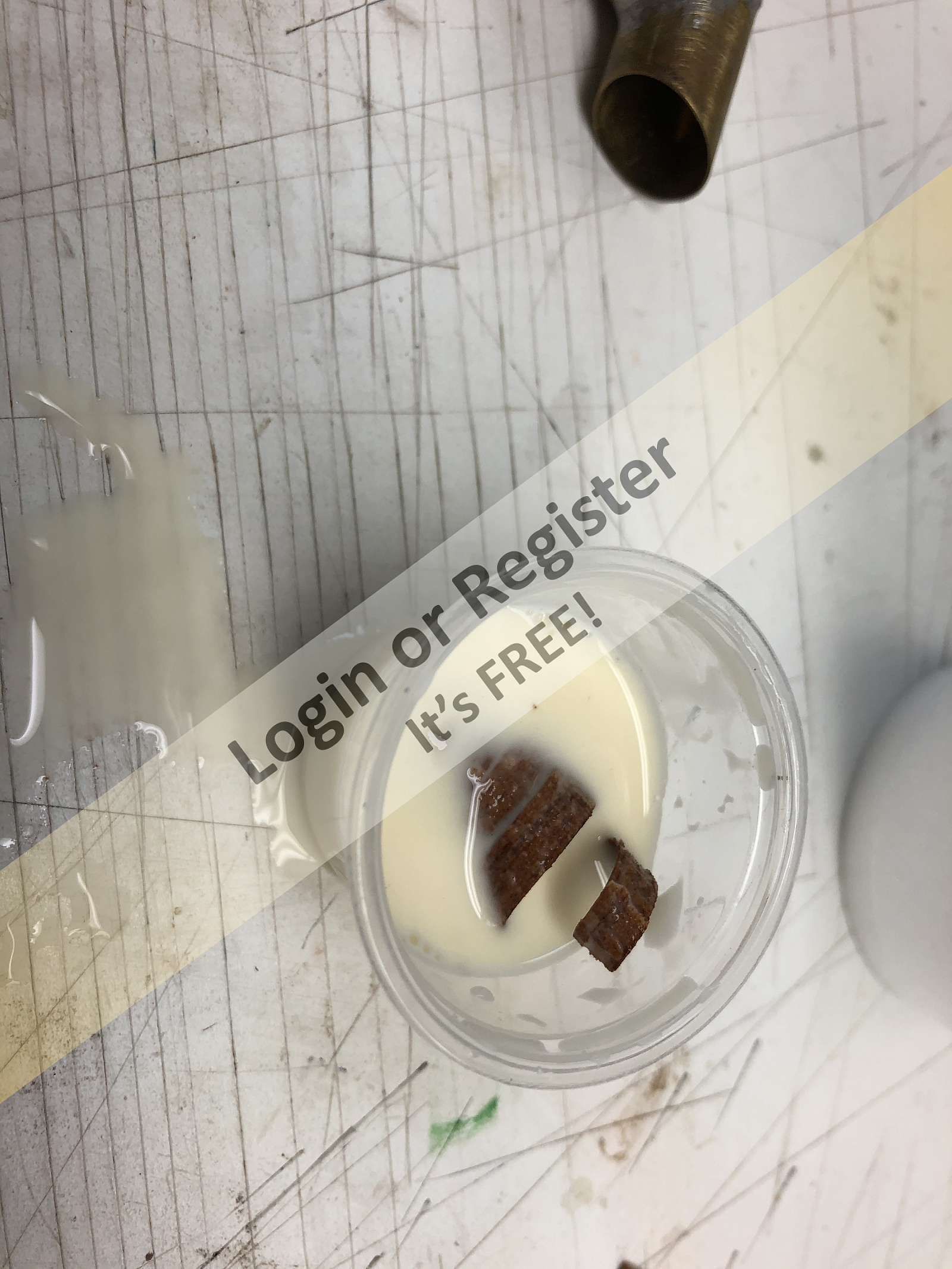

All of my mast hoops are fabricated from mahogany.
Below is a concise, formal description of the method I use:

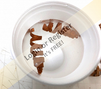

Prepare thin wood shavings from a hardwood stock measuring approximately 1/4" to 1/2" in thickness. Mahogany is particularly suitable due to its consistent grain and warm brown coloration.
Soak the shavings in warm water to expedite softening, or immerse them for two to three hours to allow the wood fibers to relax thoroughly.

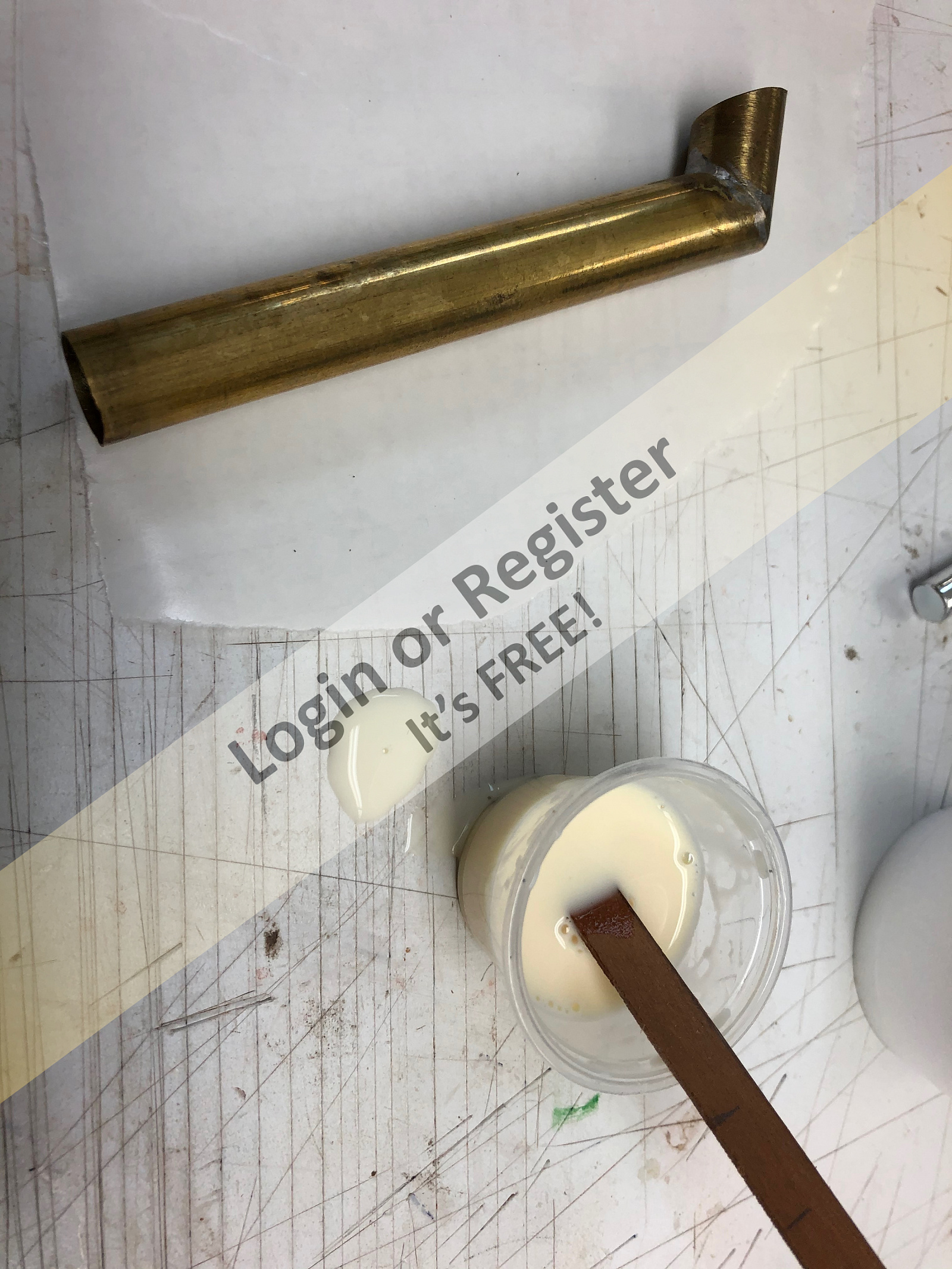

Select a tube of the required diameter and wrap its surface with wax paper to prevent adhesion.
Dilute wood glue with water at a 50/50 ratio.
Remove a softened shaving from the water and rinse lightly.
Submerge the shaving in the glue mixture to ensure full saturation.
Wrap the shaving around the prepared tube a minimum of four turns, securing the end with an appropriate clamp.
Allow the assembly to dry for 24 hours. Once dry, remove the formed hoop, sand it to a smooth finish, and apply varnish or any high-quality sealer.
Presented here is an additional example of my wooden mast hoops.

Jumpugly, your dad did a great job, the hull has beautiful lines and is in excellent condition, the rest is also very good, it really deserves your attention.

She's a beauty Chug! Your tremendous workmanship is an inspiration, as my Dad's ancient Muscongus Bay Smack (a brethren of the Friendship) still awaits me for restoration.

As all have said, beautiful work. Your mast hoops, how were they done? Alessandro & I got into a mast hoop discussion a while ago.

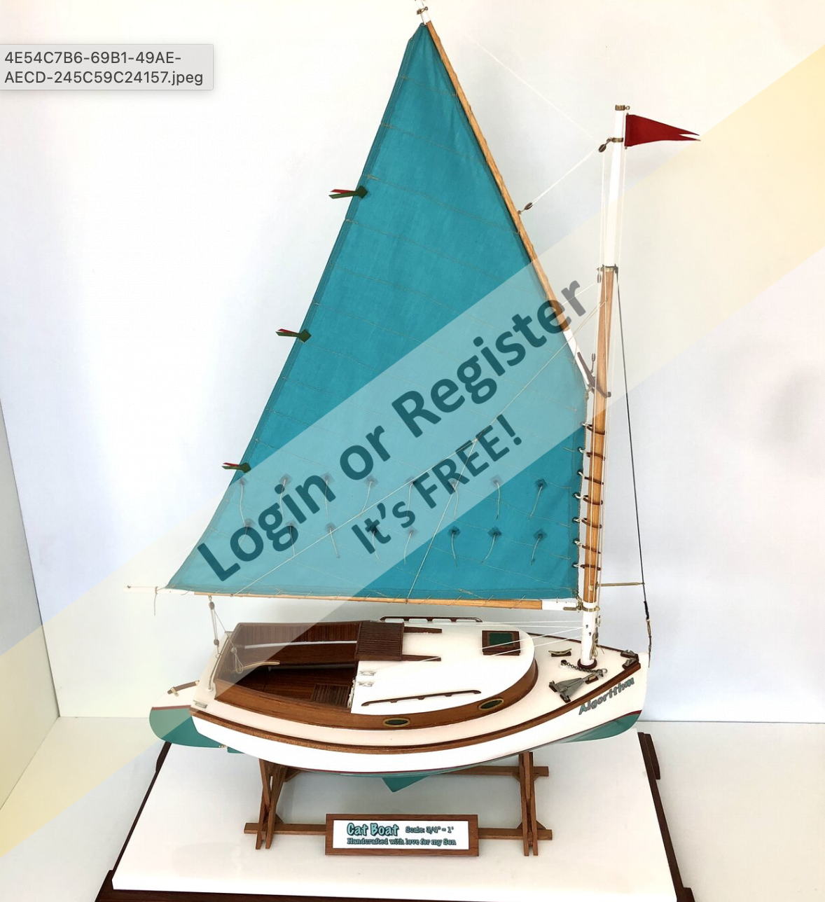

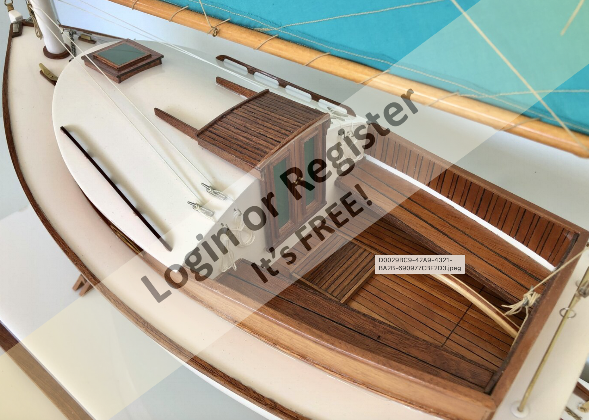

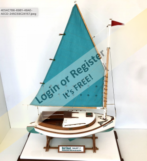

Laughing Whale Friendship Sloop Scale 1:12

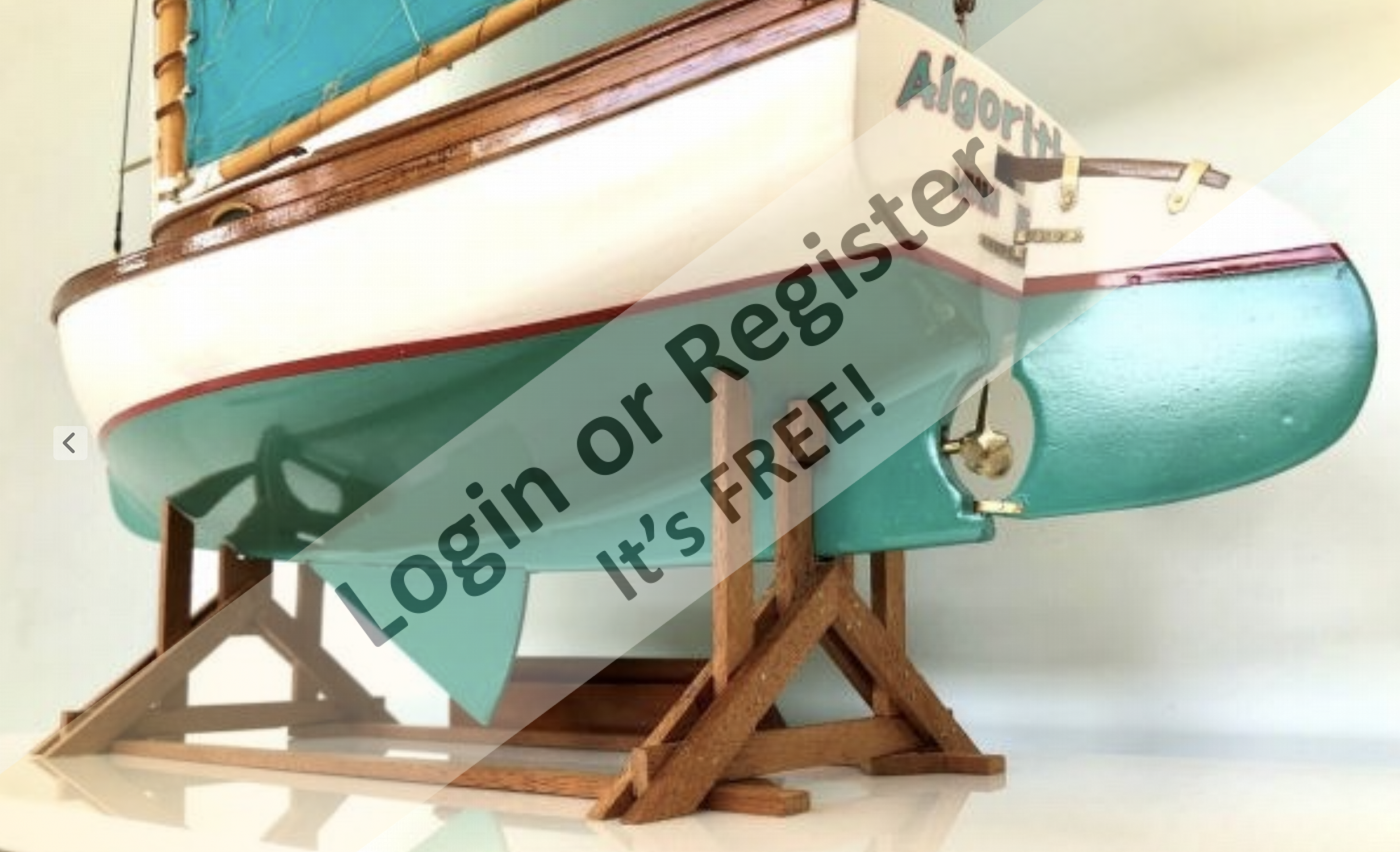

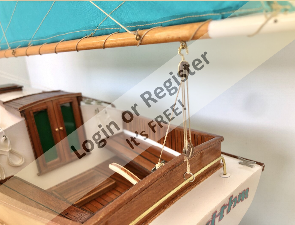

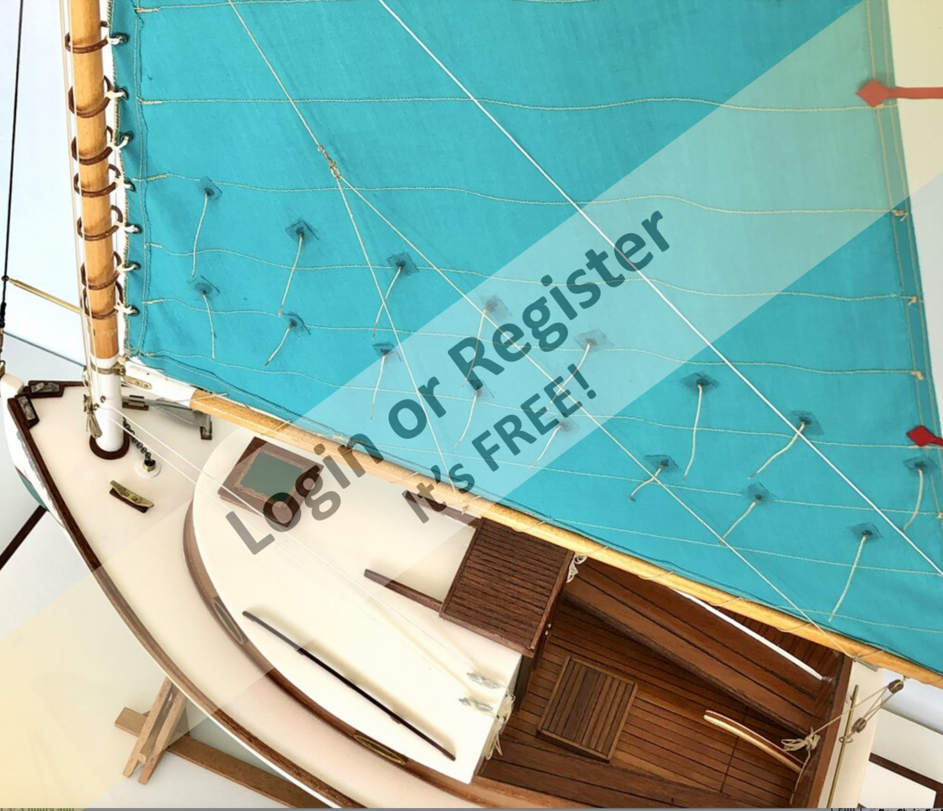

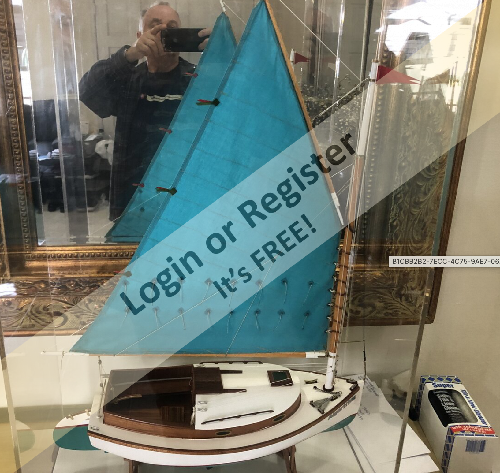

This model is based on a kit I acquired on eBay, is an early Laughing Whale 1:12 Friendship Sloop.
All structural and decorative elements from the gunwale upward have been entirely scratch-built.
Every item visible on the deck, along with the mast brackets, hoops, were fabricated by hand.
The eagle’s head was sculpted in place using a two-part epoxy medium.
The scrollwork on the beakhead behind the eagle consists of a 1/16" PVC overlay, heat-formed to shape. The black, gold, and red scroll design was meticulously hand-painted.
The sails were machine-stitched, with all borders finished by hand. Completing the luff, leech, head, tack, clew, and foot required approximately three days of work.
All interior components—including the seating, flooring, tiller, and compass—were likewise constructed from scratch.
I hope you will enjoy this piece.
