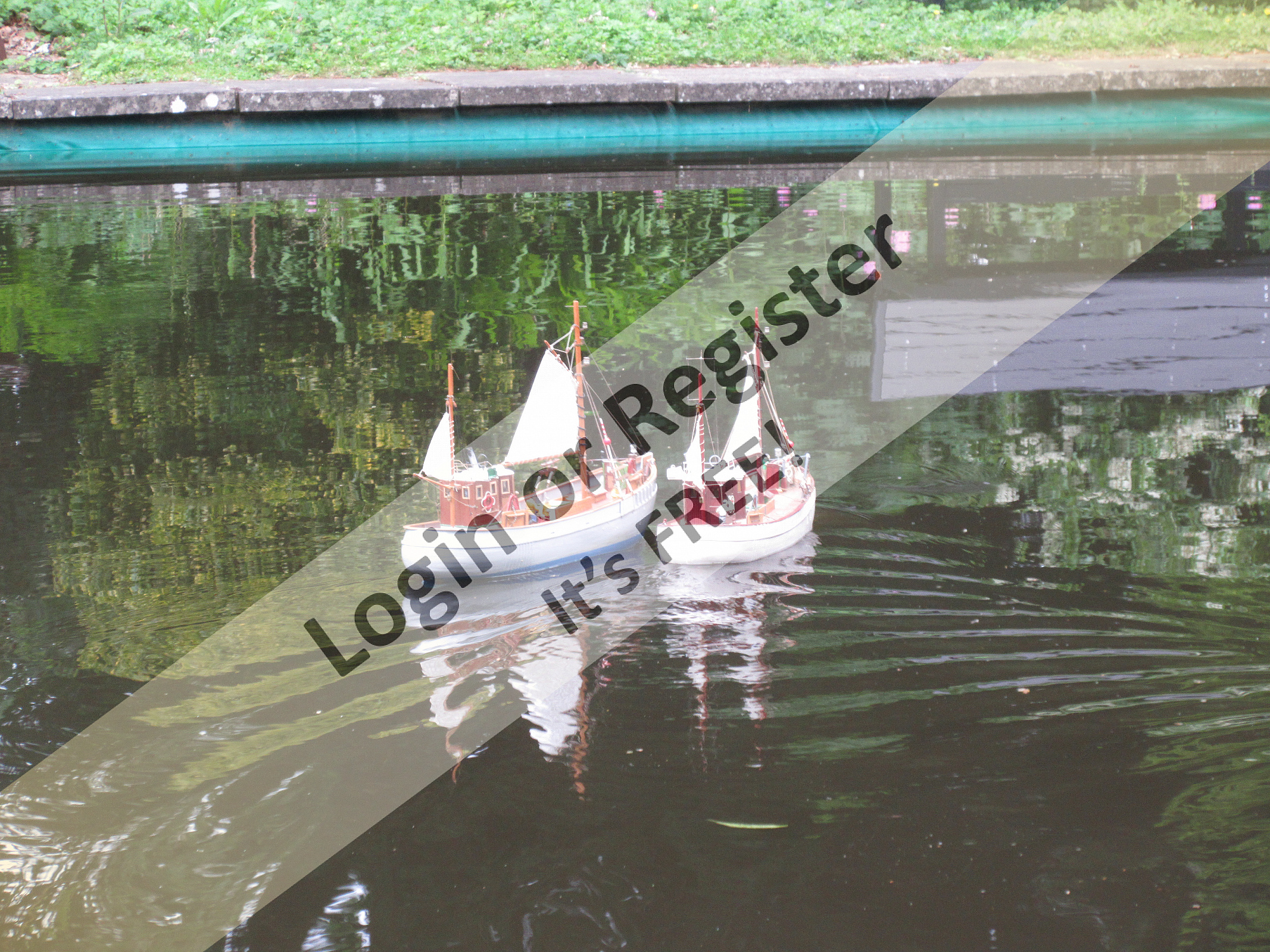

    Hi Bruce et al, I am very careful with prop tubes and I used to set them in place using P38.
    Now I have moved on and use bathroom sealer, the white one is a stronger glue than the clear one. It insulates a lot of noise and never quite goes hard. Been doing that for the last 4 or 5 model boats, never let me down.
    Back to the ring net fishing boat from the Scottish Isles, the epoxy makes the bare wood very shiny just like they are fullsize.
    See below my 2 'Mary Anns' They are both the same inside. They say a picture tells a thousand words, but I never noticed!
    If you look you can see that the near one is lower in the water, it was sinking! When I got her back there was an inch of water in her, traced yesterday to a sprung plank. Being treated with epoxy as I write.
