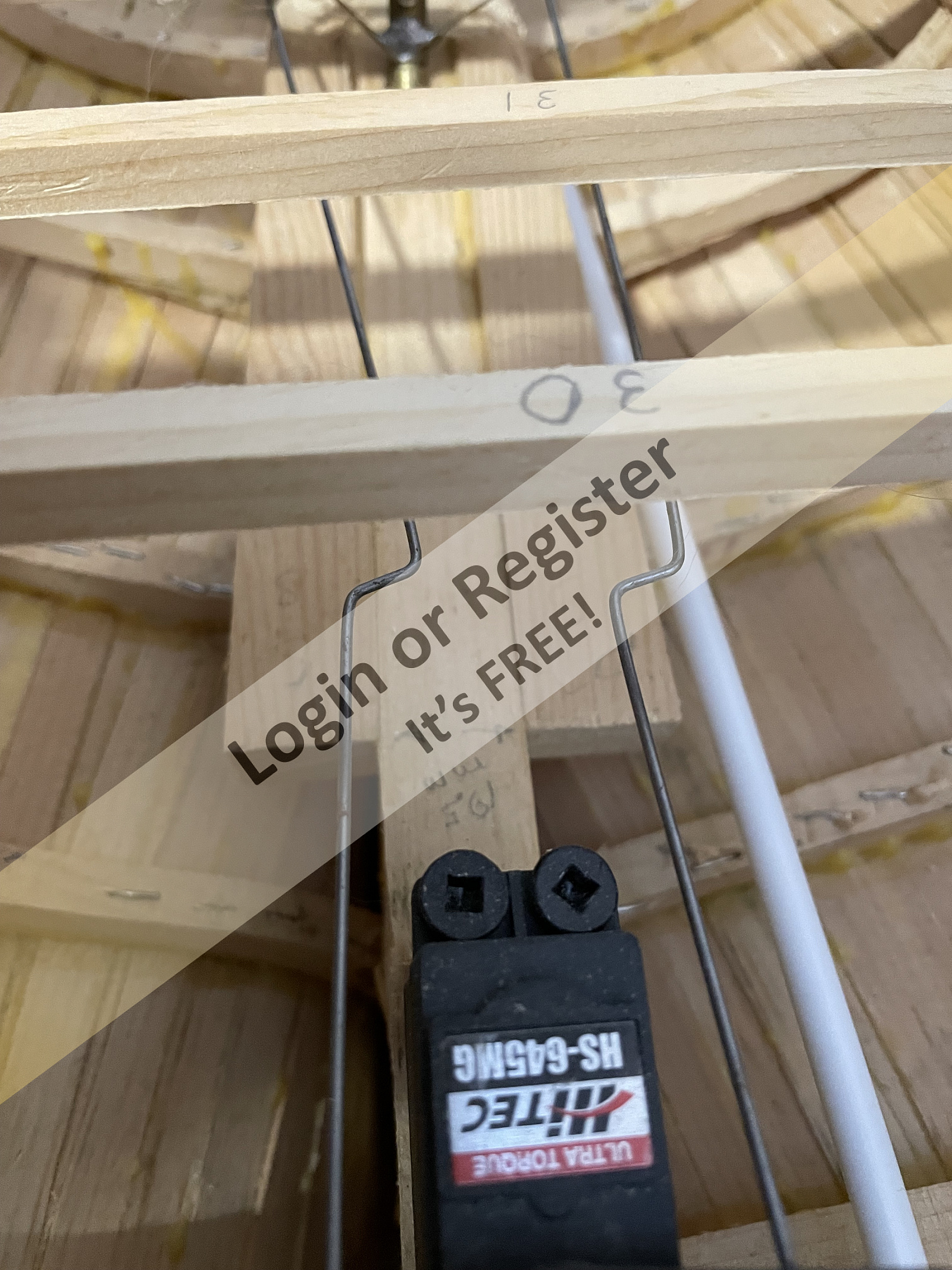

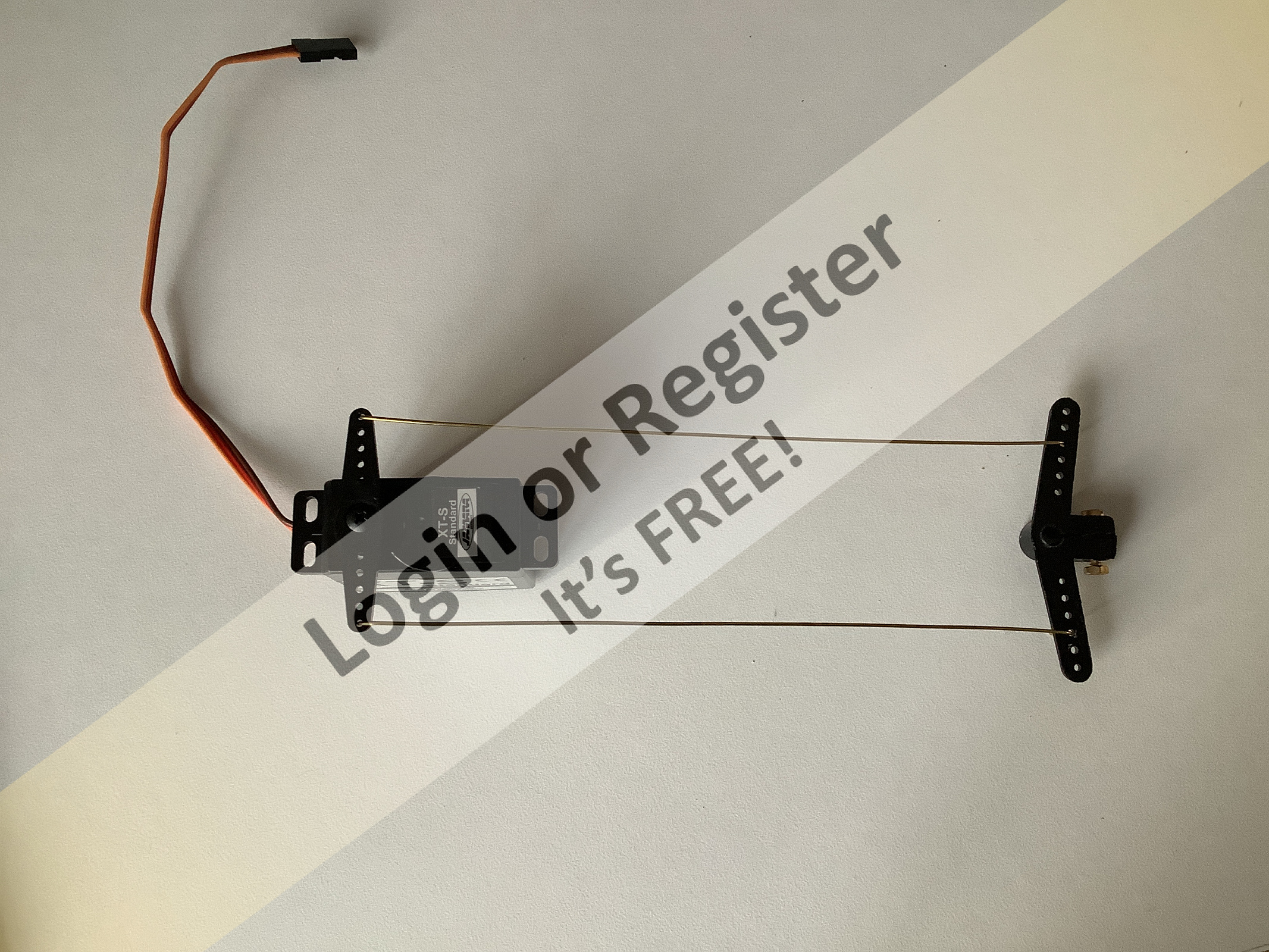

    "double routed" :
    I would guess to mean that push and pull cables or pushrods were installed between the servo and the rudder arm. I have done the same on my Juneau model. It appears balance the load on the servo arm and hence the output shaft and gear wheel of the servo.

    But I had the same problem and took my servo apart at the time.
    I was amazed at what I saw: the plastic gearwheel with stop cams had cams and teeth missing. .
    However, since I double-routed this from the servo to the rudder, I have never had any more problems. .
    I also replaced the old servo with a stronger one.

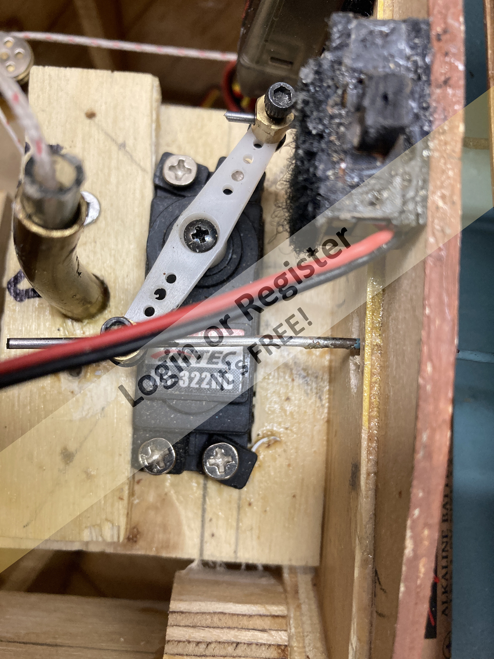

    First, what brand and model radio are you using? If you disconnect the rudder servo arm from the servo, can you cause the rudder to move in either direction further than the servo would move it? Does the rudder move freely?
    Quite a few people tend to set up their models with the rudder servo trying to move the rudder to extreme limits. This should not be done. It is very hard on the servo, sort of like trying to force a closed door beyond the jam, AND it causes the servo to draw a lot more current than1) it should, 2) the on board radio battery, or BEC, can supply. Either way, the servo stalls and now the receiver is not receiving it's share of power and, well that is when rc airplanes fall out of the sky.
    I hope this helps, but there are numerous components to your radio, model and assembly that can figure into this issue.

    I would have a guess and say the rudder servo is stalling and the receiver has a 'brown out' and the reboot of the Tx resets it.. I would check the Rudder endpoints to be sure you are not DRIVING the servo beyond the mechanical limits of the installation.
    BTW.. What Receiver and battery are you using??
