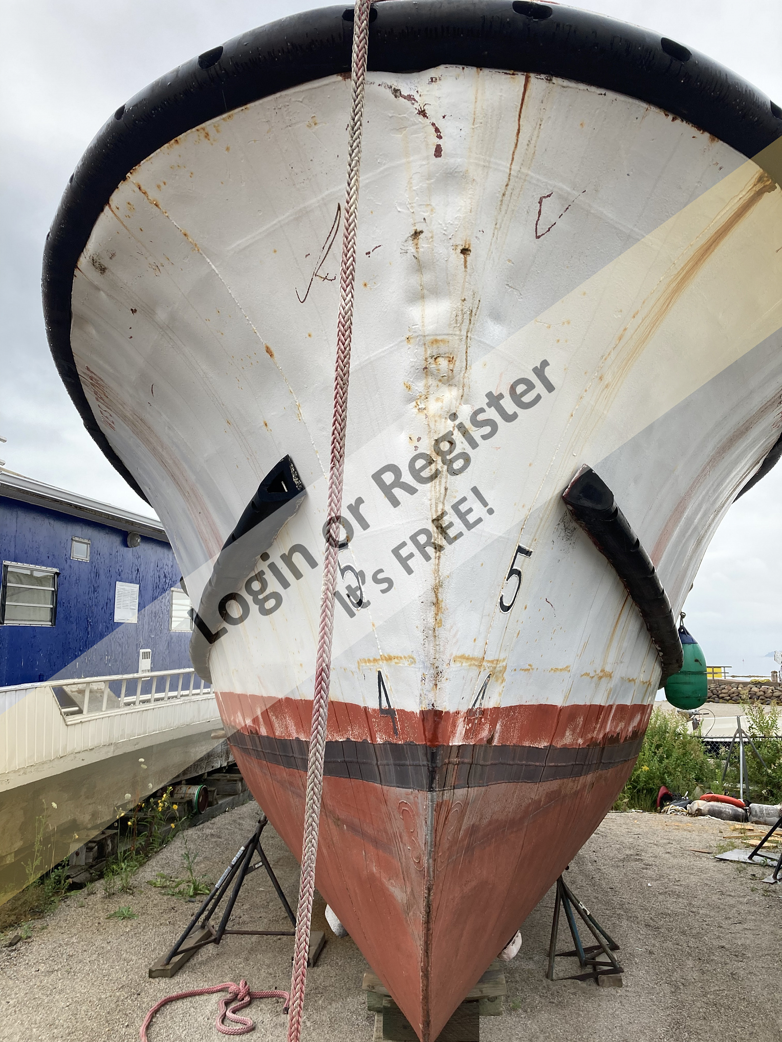

Wow! I was unaware that the enclosed the cabin. In the US we did not. Also, the splash-guard aft is different. But since I am in the process of building one, these are fantastic close-ups. I am trying to figure out what the port side aft vent goes to, we do not have that either.

That 44' Cutter is Canadian version, has the enclosed wheelhouse. I have a mold of that hull to lay up a 1:12 scale 44" model hull.

Looks like the USCG 44" Lifeboat,
She looks like she had some hard knocks🤕

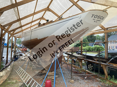

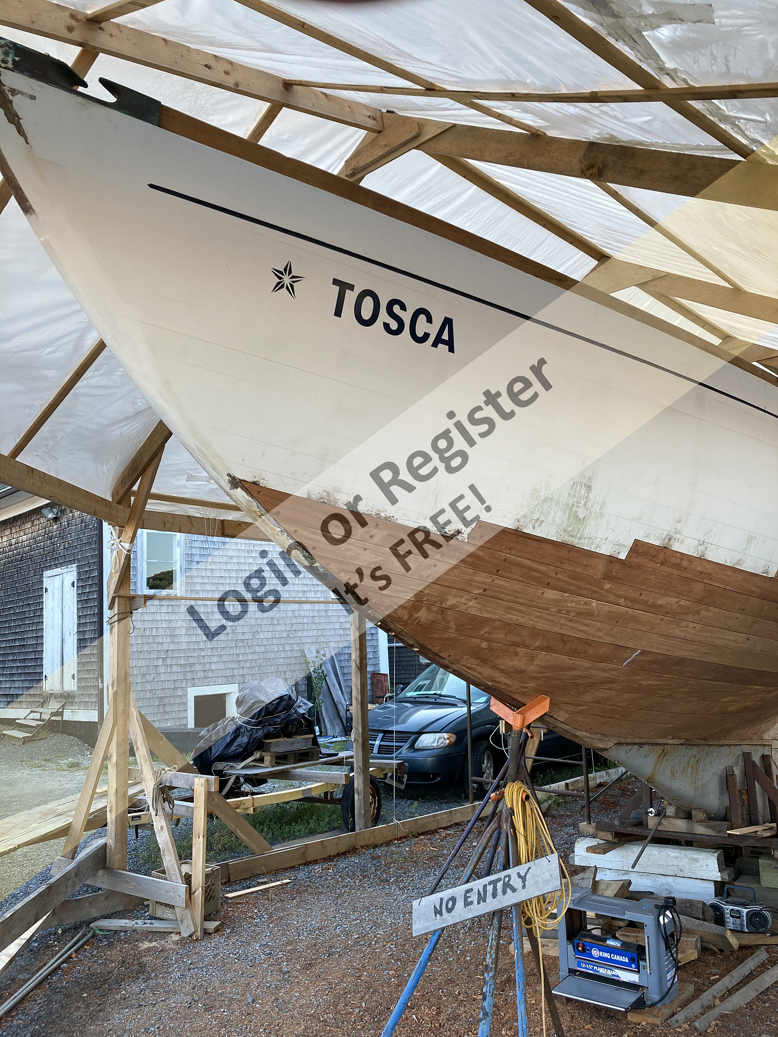

I like the wooden sailboat, Ron, she has great lines.
Too bad the planking job is wrong; the joints are way too close together.
They should be at least two bays apart, with at least one plank in between.
