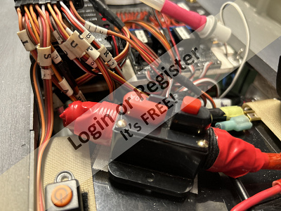

I got a chance to take a few pictures showing the disconnect I mentioned. It is mounted to the top of my battery with velcro. If you push the red button the circuit breaker will open and disconnect the feed. I use this button when I want to put the boat to "sleep". To reset the breaker from the open/sleep mode just push the lever sideways. You also push the lever sideways to reset the breaker after there is an electrical overload causing the breaker to trip.

I protect the entire electrical system on my 42"tug with a STETION Car Audio 40 Amp Resettable Fuse Circuit Breaker Car Protect for Audio System Fuse 12-24V DC for Car Audio Amps Overload Protection which I bought from Amazon.
What is nice about this device is that you can disconnect the entire electrical system with just the push of the on board button and it acts as a resettable circuit breaker in case there is an overload condition. I have it installed between my battery the main distribution panel. At the end of the day or when I take the boat out of the water all I have to do is push the button and the electrical system is disconnected.
In addition I have fuses protecting individual branch circuits. LEN1
