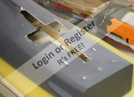

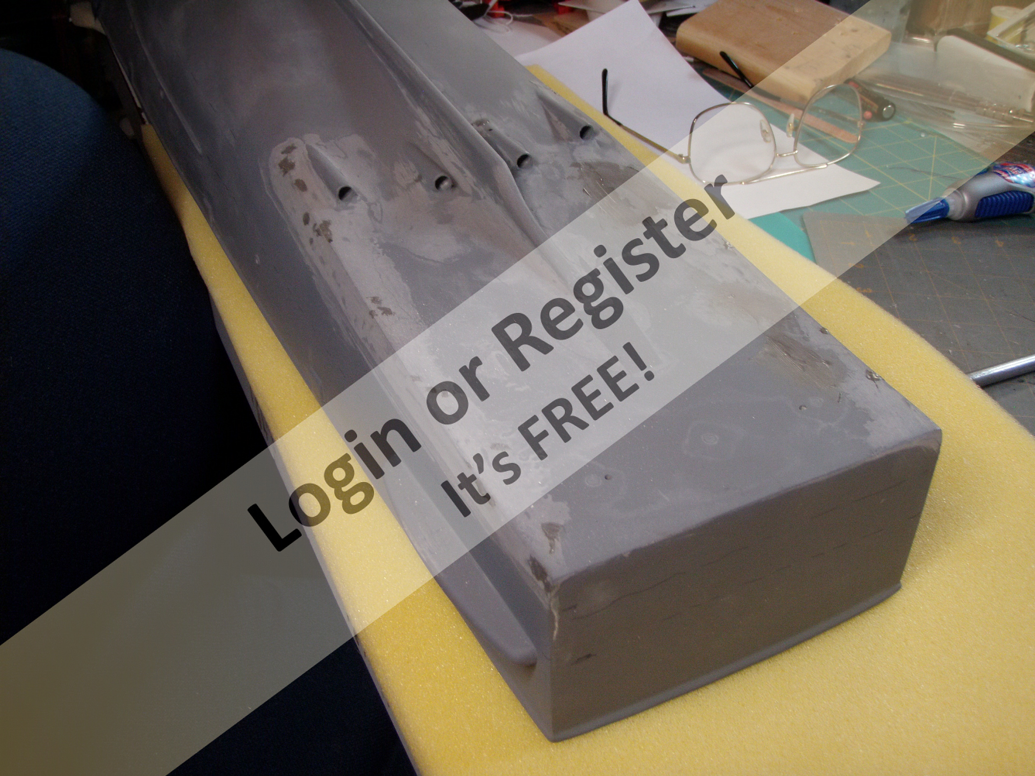

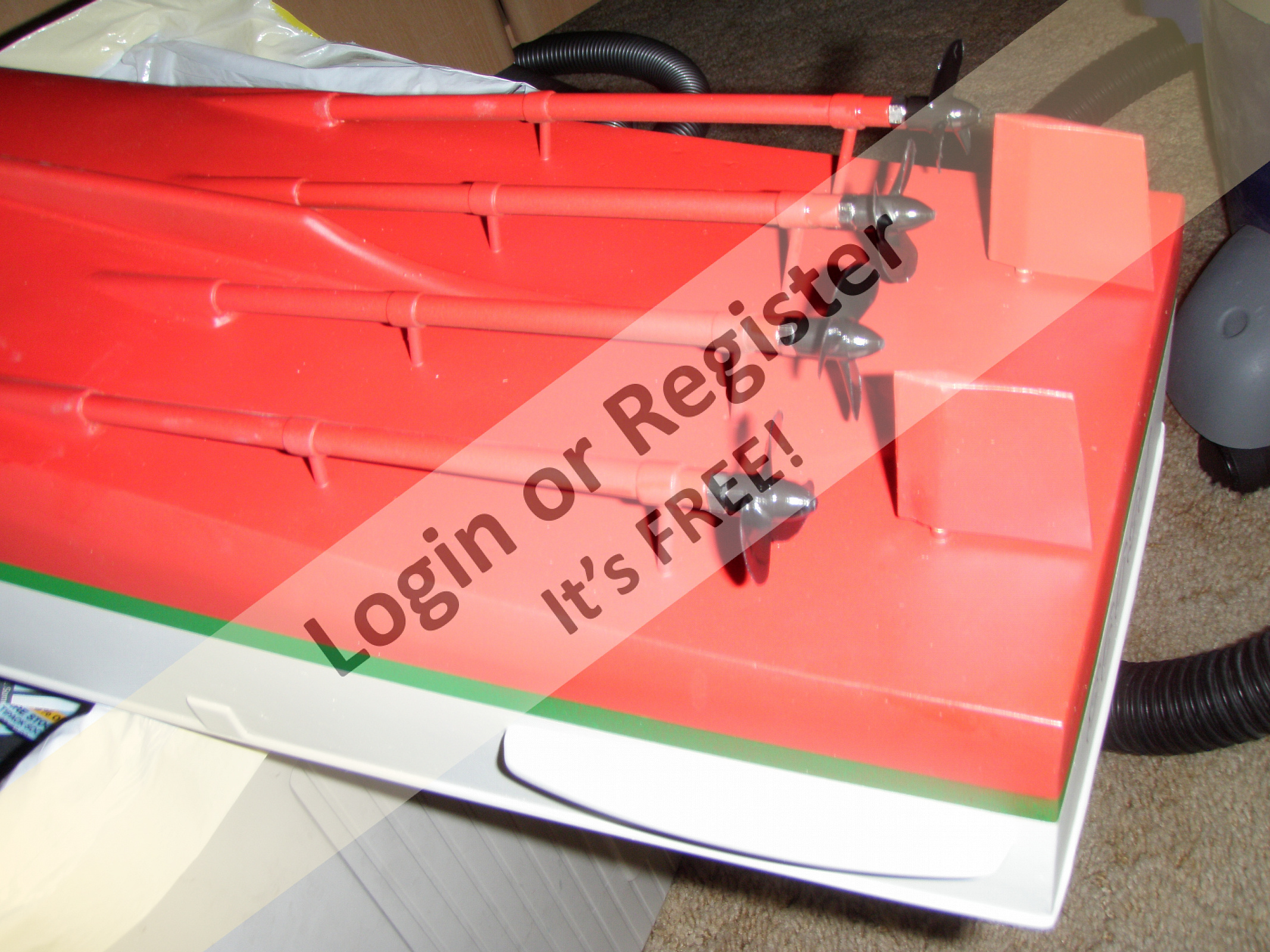

The shaft can be replaced, sometimes with great difficulty. I had to do that with my Wiesel schnellboot. I built it with three shafts (per Graupner's instructions) and then changed that to the correct four shafts. That required a 5 inch by 6 inch rectangular hole in the bottom.
Florida ⛱️, USA 🇺🇸
Correction (edit): The cutout was a cross shape. Added photos in the order of the repair.

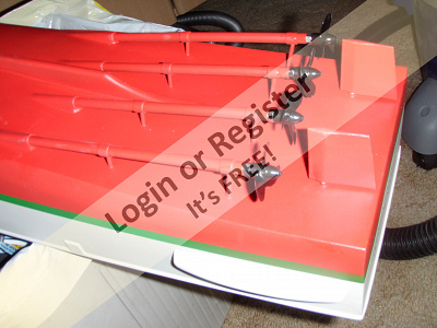

Spence, That's a new one! I never heard of anyone making a model boat coupling out of wood. For the coupling's small size and speed you most likely need something stronger, balanced, and precise.
I checked on ebay.co.uk and did see some Dumas couplings there. There ae some hobby shops in the UK that carry Dumas model boats and accessories, try checking with them. (Photo #1)
Alignment issues - difference between one and teo u-joints. (Photo #2)
Another alternative is getting two u-joints with a short shaft between them. (Photo #3)

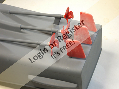

About photo #3, that is from the drive set I ripped out of the Krick FLB2 that someone gave me (someday I hope to get back to it). I added the short shaft and new couplings. Photo #4 is an exaggerated misalignment but serves as a guide as to why two u-joints are a vast improvement over a single u-joint. (Also, I did not realize I had any MFA Torpedo 500 motors. Ha!)
