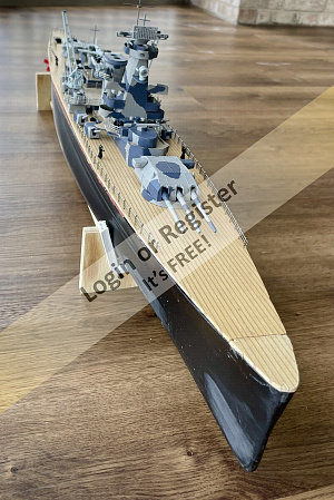

    I am building an RC scale model of the pocket battleship Graf Spee (you can see my build blog on this site). I am now getting closer to finishing and have to consider how to paint the plastic hull. Not having built a boat in decades and not having worked on a plastic hull before, I need some help finding the right paint. I need to match the superstructure which is brush painted in acrylics with a matte clear finish on top. I tested this method on the hull and it doesn't adhere well and is not durable. I cannot use spray for various reasons and am considering using commercial paint from a building store, probably enamel. My old favorite 2 part epoxy paint is no longer made. Can anyone suggest a good brush paint method and materials for a plastic hull that will match the superstructure?
