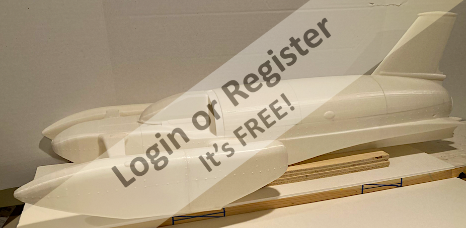

    I will be following this type of subject very closely in the coming months because of this 4.8 pound piece of 3D printed madness.
    More to follow on an appropriate blog as things develop.
