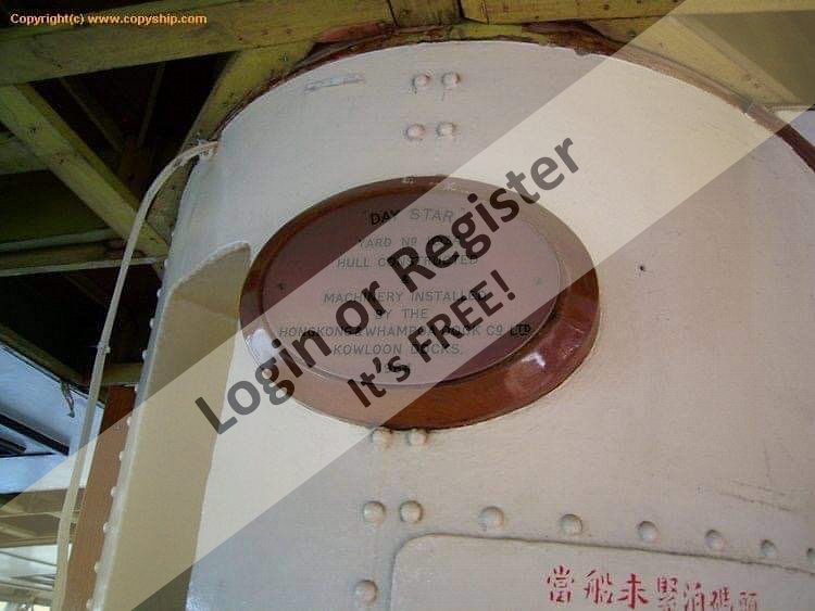

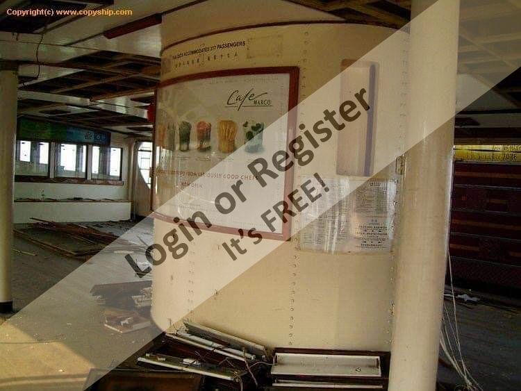

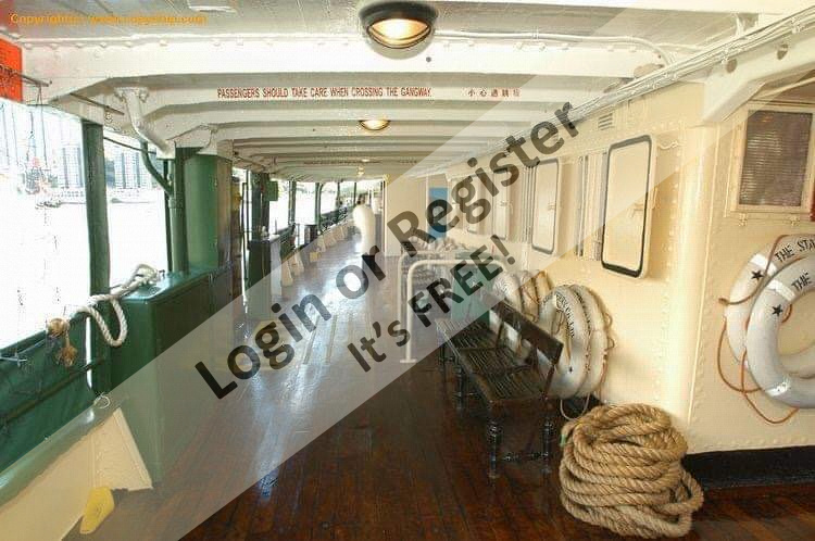

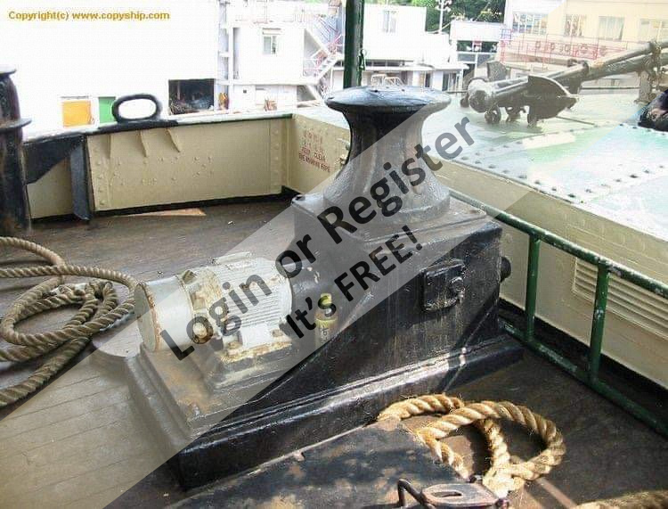

Over the years since I first rode the Star Ferries in 1965, I have wanted to build a model of one. There is no actual construction plan that I have ever found. However, I have found a number of drawings, and pictures, which I will attach.
I also corresponded with a modeler, who ran a Star Ferry model at a Northwest model ship meet a number of years ago. He built his hull from foam with open passages for his radio and batteries, and one motor for each prop. I also have some interior photos.
