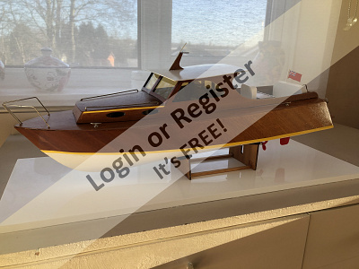

The first couple of photos are of my Diva built probably about 20 years ago.

Being new to RC boats I'm at a loss as to what I need in the way of electrics for my boat that I am building. I am okay with what controller which I have ordered but its the electrics in the boat that I need help with. The boat is simply a motor and a rudder. I have the motor but nothing else. Unfortunately Aeronaut's instructions assume you know what electrics are needed because apart from mentioning the motor and a servo, which they don't tell what size you need, nothing else is mentioned. The motor which I have fitted has some wire attached for connecting but I don't think they are long enough to reach the electrics bay. If someone could give me a list of what I need to purchase in the way of cable, connectors, rudder servo and what ever else I need I would be grateful.
