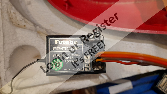

hi Wolfgang B no separate sticks photos attached thanks Brian M

Hello Brian
Is channel 1 + 2 on your transmitter the same stick? Do you have pictures of the transmitter and receiver?

hi I am new to model boats and am updating my HenLong Seaport workboat. I have fitted a Viper marine 15 amp esc controller and a servo for the rudder. I am using a Futaba Attak -R PFP-R103f 3 channel receiver(40mhz). the motor runs ok on stick 2 but the servo seems to get power
and locks up with no response from the chan nel 1 stick. if I unplug the servo lead the motor still runs ok.i am using 9 volt rechargeable power pack but no separate receiver battery ....any advise would be welcome, many thanks Brian M
