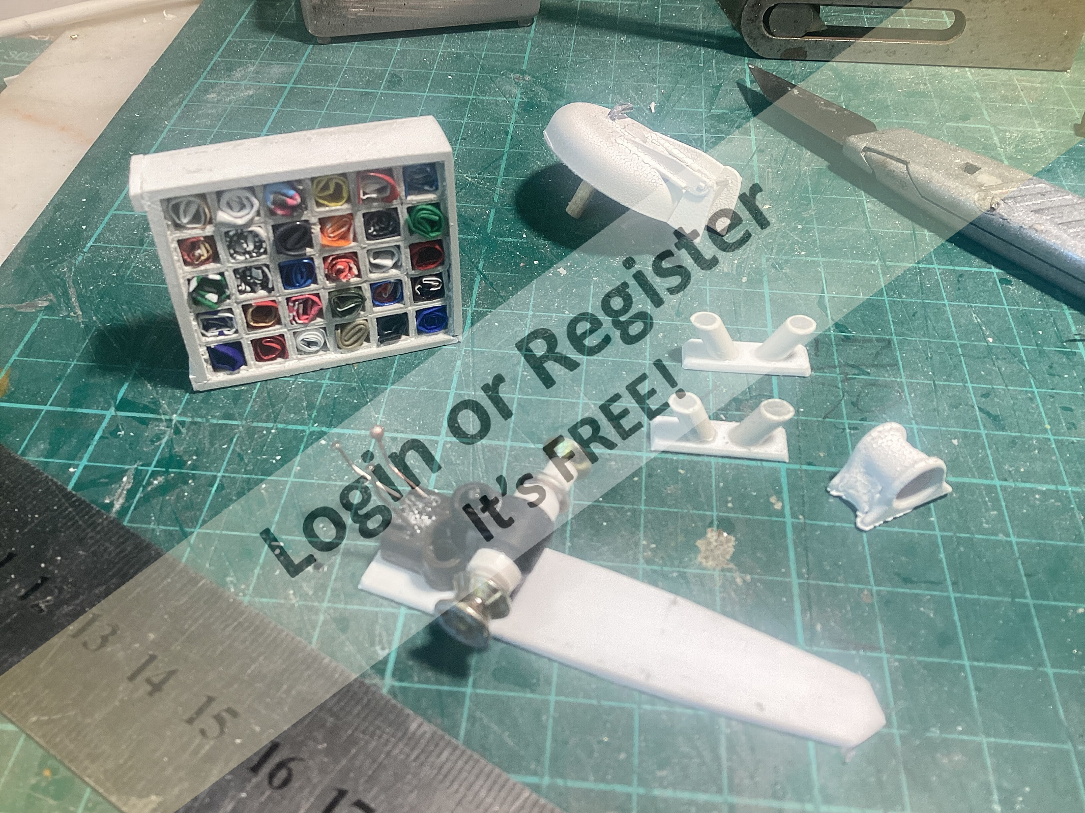

RTTL 2755 update
Hello fellow modellers
I’ve been busy today making the fiddly small components that I think set a project off.Each small part is a micro project in itself and I find it a challenge scratch building.
This afternoon I set about making the winch for the bow.I found a base to work as the motor body and a small cable clip for the gearbox.the difficult parts was going to be the 2 capstons each side, I solved the problem by sawing the heads off 4 countersunk screws bonding them to a shaft as can be seen in the 1st photo, adding some levers finished the job, next I added some folded flags to the flag rack purchased from “Battlecraft”. Then I made up a watertight hatch cover from a lid off a hand sanitiser bottle. Tomorrow not even started on yet.
Roger
