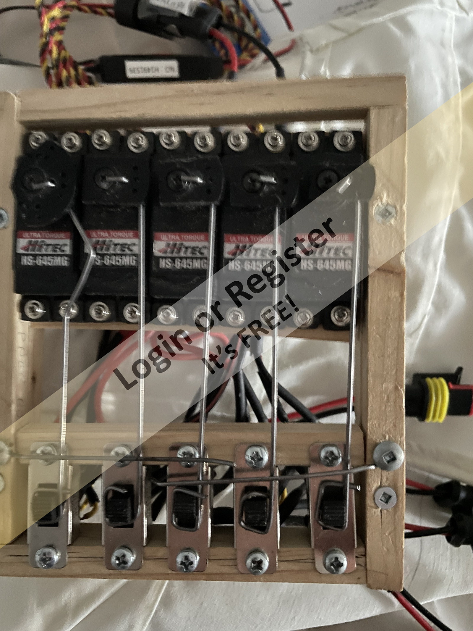

    Not knowing anything about RMG products, I devised my own solution
    1) winch motor and gearbox from ALIEXPRESS for about $25 CAD
    2) wooden rings, available from most handicraft outlets for pennies each piece
    3) couplers
    4) framing that anybody around here can build
    12 volt, completely separate power source
    DPDT switches to the servos
    HITEC 645MG servos
    Lifts 2KG weight, 1.2 metres, in 10 seconds
    different ratio gearboxes available

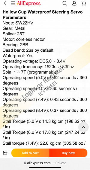

    There was a bit more info than that which Iโ€™ll include a screen shot of here if it works.

    Hi be careful of values of torque given as just 25 Kg. The unit should state the torque value in Nm ( Newton metres) or kgm or kgcm for example.Torque is a function of radius. The larger the drum diameter, or the longer a servo arm is the smaller the pulling force gets.They should state at what radius the 25Kg is measured at.

    I need a sturdy sail winch too. Iโ€™ve never used Ali Express before but noticed that they are selling a Kingmax SW22HV which is metal geared, waterproof, is programmable from 1.5 turns to 7 turns and around 25kg of torque. They give a ridiculous discount for first purchase so with tax and delivery Iโ€™ve got three for around ยฃ27. Iโ€™m not one for dealing with these Chinese sites but this seemed too good to miss. Delivery within 14 days.
