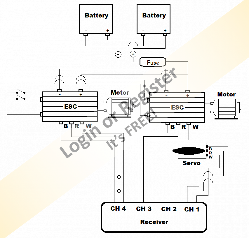

The only difference with my dual motor installation is the switch. You show a double pole switch. I use separate switches for each ESC as mine usually come pre-wired with the switch.

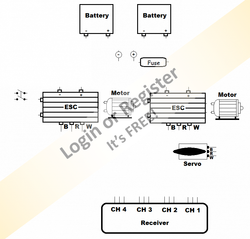

Pat Apologies I attached the wrong image here is the correct one

We always use two separate speed controllers and wire them up as shown. We have used this approach for over 15 years and have had no issues. Hope it may help

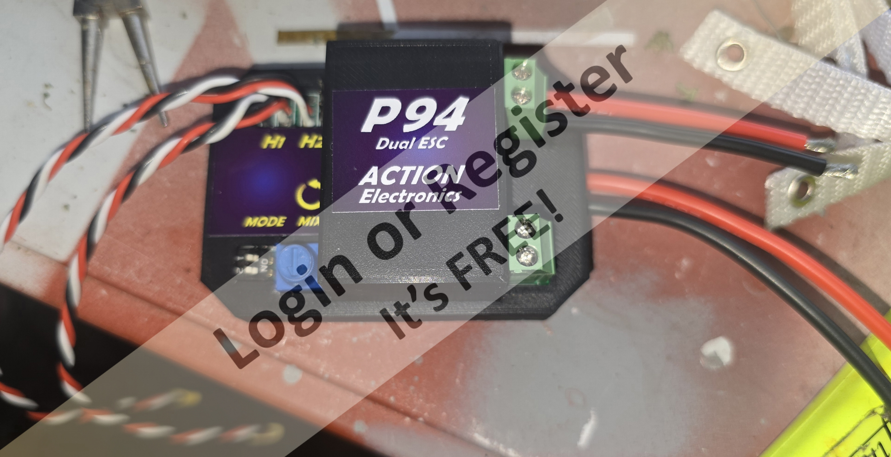

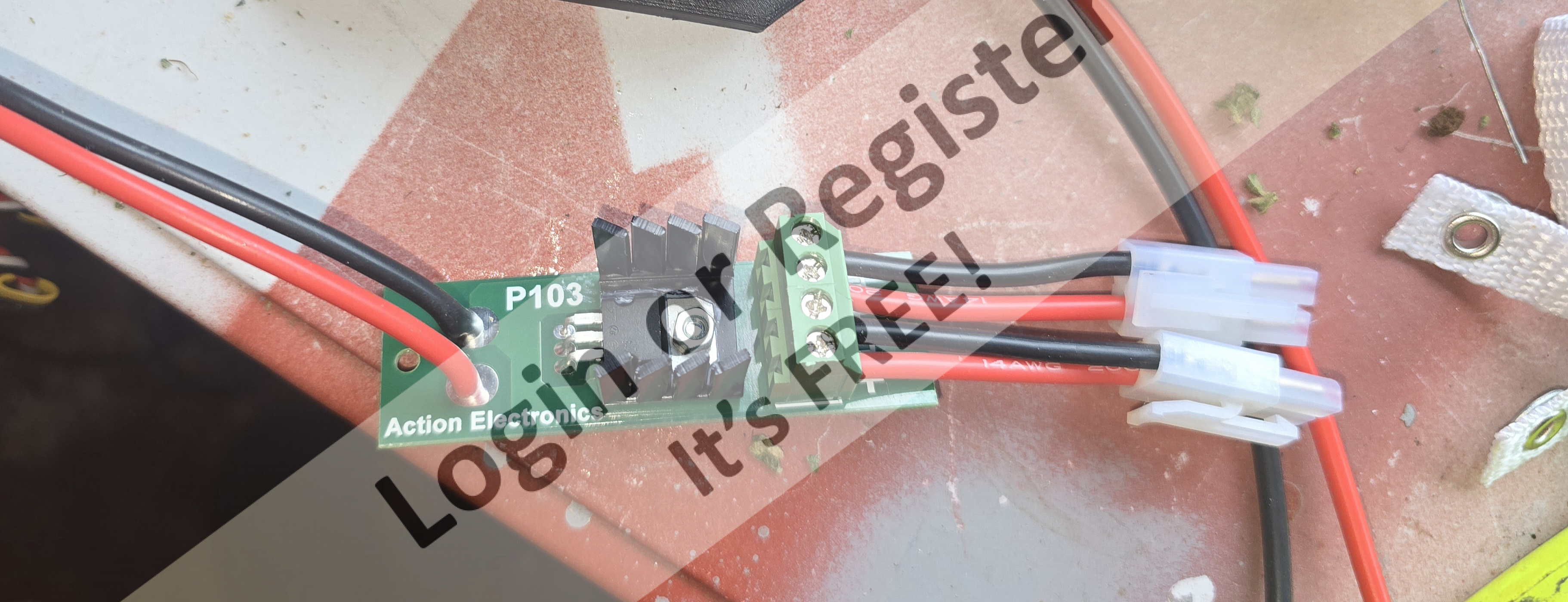

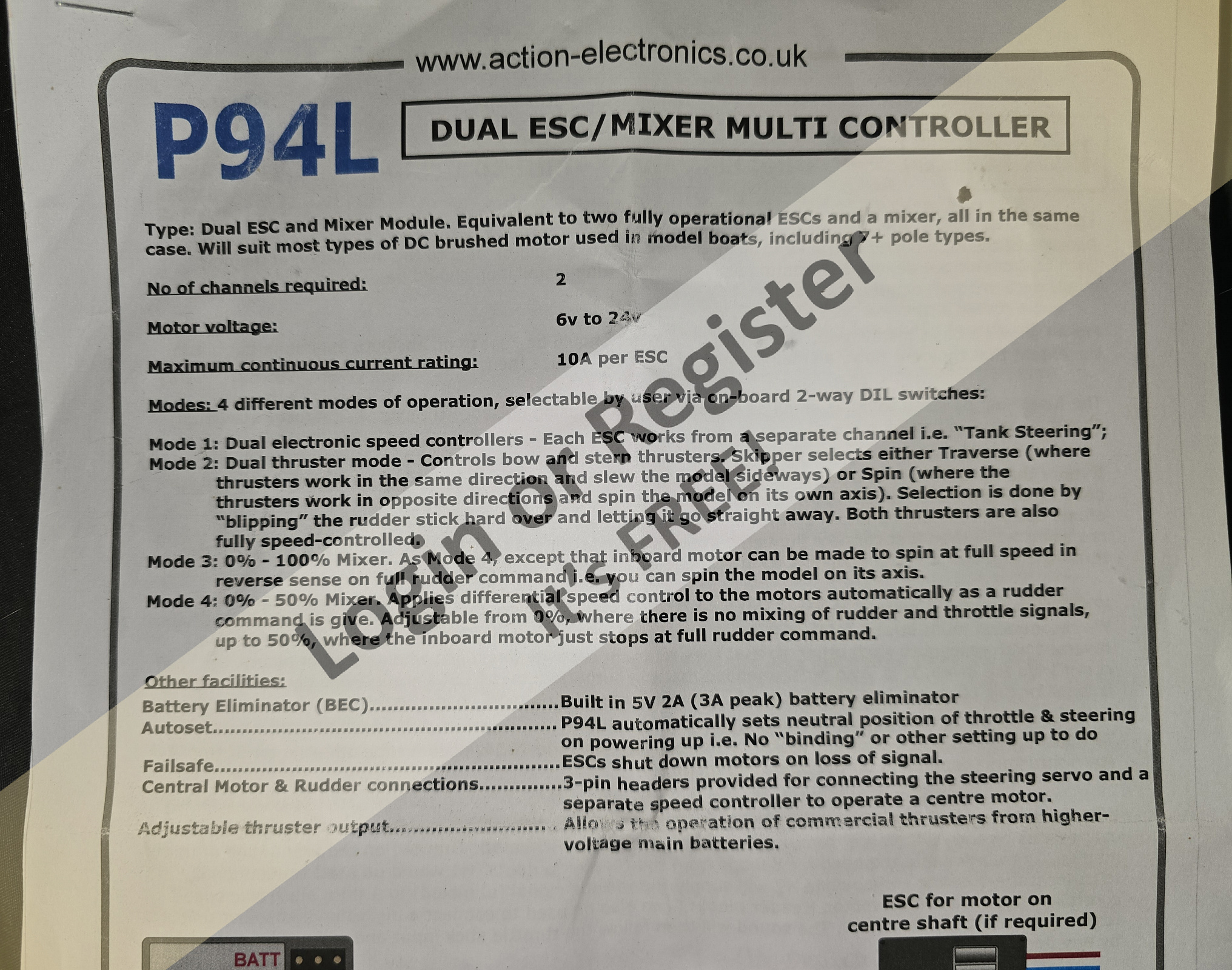

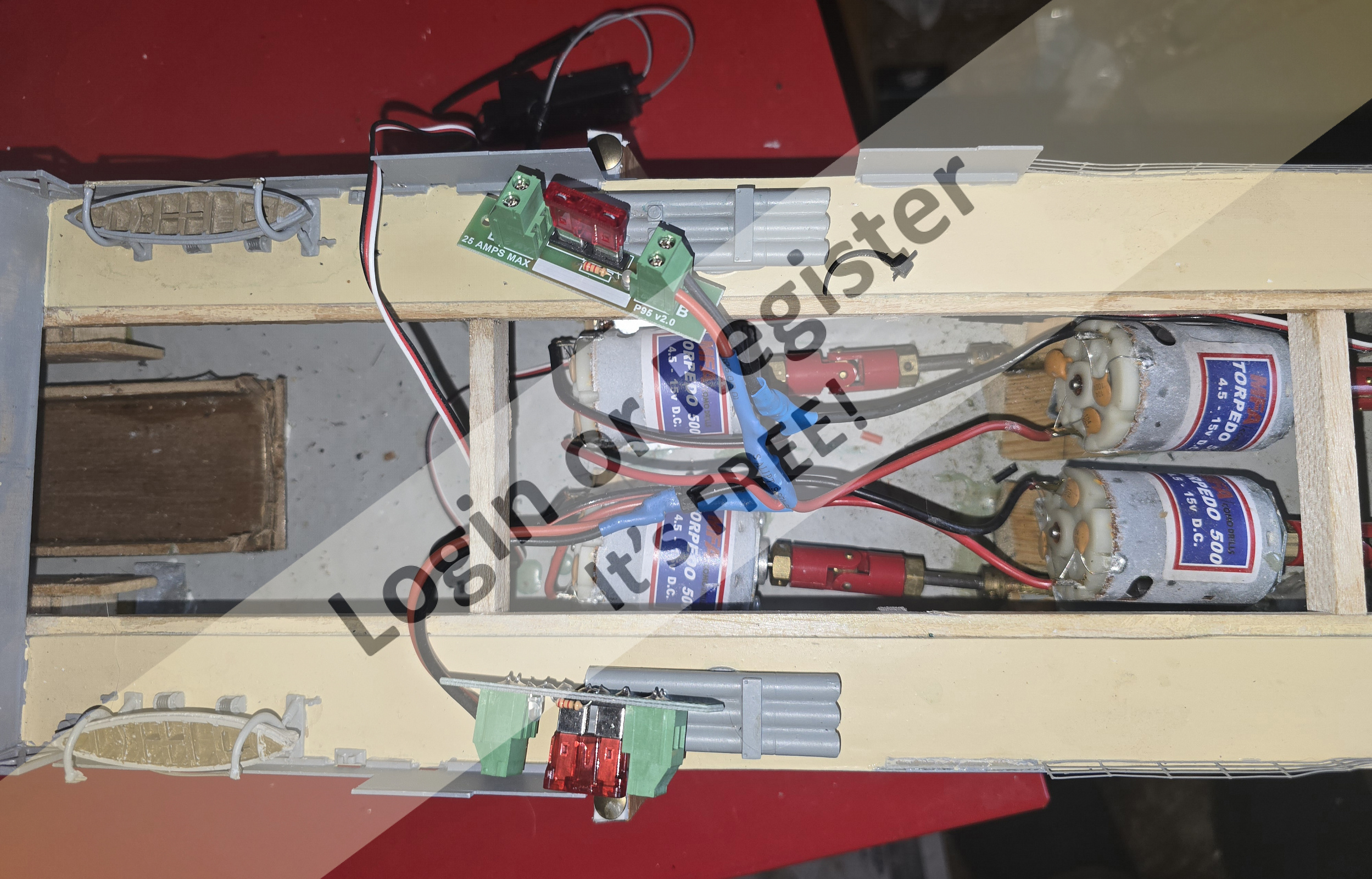

Hi Pat. I like to use the Action P94 dual escape plus mixer. I have one in my LCM6 and I am just upgrading the power train in HMS Manchester. Manchester is getting a parallel power board, to safely connect two batteries without fear of back charging, two fuse boards and the P94, which is programmable for various combinations of motor/rudder mixing. I can scan the instructions if you want to have a look.
