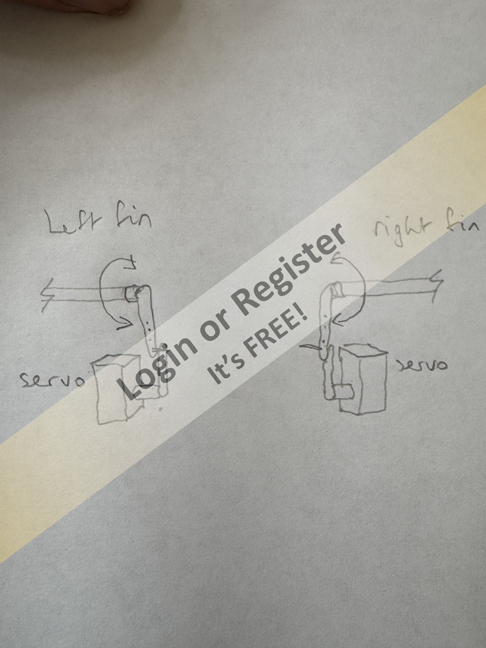

I like Roycv's suggestion. Also, what radio system and model are you using. If it is a computer radio, you should be able to set up mixes without any additional external mixer.

Hi that is interesting, I would use a mixer running from the receiver. Just 1 (up/down) channel dividing into 2 servos via the mixer unit would give planes up and down, with both working together. Then the left/right of the same stick to have the rudder input to the mixer for the banking. This leaves the right hand stick l/r for the real rudder control.
You just need one stick position for this set up.
I think that works, does it fit with the mixer unit you have?

Hi all, working on my RC Shark and need to mix the two servos controlling the side fins, firstly to operate individually as marine ailerons (to roll the shark) but then to operate in tandem as elevators to control the pitch of the shark. Using a 40mhz setup (for underwater use). Question - can I use a mixer e.g. Mtroniks v tail to mix the two servos over 2 TX channels? Thanks in advance - hope the drawing helps..๐
