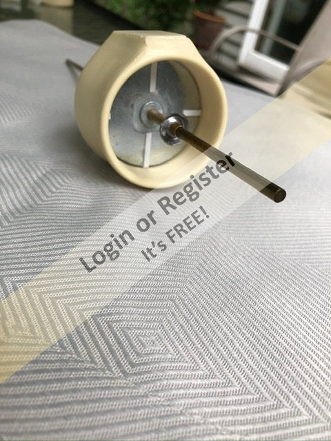

Having recently poked the stick in the cage about Kort nozzles. I want to ask, how those who use them & maybe someone who has converted to using Korts a question. What techniques do you use to align the drive shaft, prop, & nozzle?
I’ve used a technique as shown in the photo. The metal disc diameter same as Kort internal diameter (where the prop will be located in nozzle) with the shaft in the center of the disc. Works pretty well but I find I still end up eye balling the final alignment. So, I have to say my various methods are not all that great.
How are you other folks accomplishing alignment given there is so little clearance between the prop & Kort?
