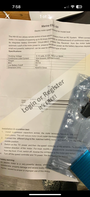

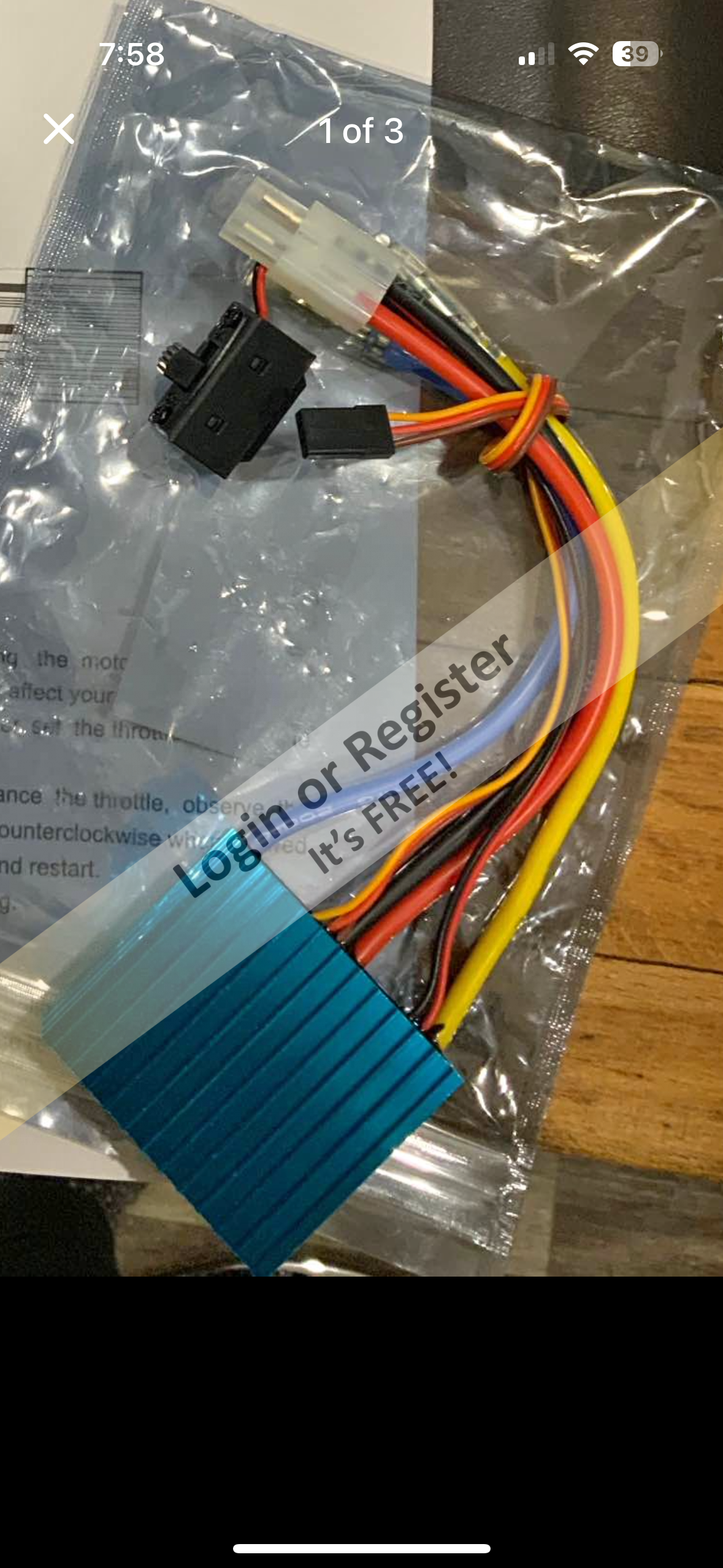

That esc was sold in the UK branded as either macgregor or multiplex and when powering it on it acted like a micro switch with no throttle till just over 50% then full throttle. I had bought 10 thinking i was getting a good price though they ended up in the bin as they where unusable. Got them for £60

If this is the esc it appears to be they have absolutely no low end response. I seem to recall their throttle start point is half throttle. I have an unused one I’ll give away for the price of shipping.
They might work fine for FE’s but I can’t use them.

There is a local person selling these HM- 50 ESC
Has anyone used them? And good or bad reviews?
50A Marine Boat ESC Electric Speed Controller Waterproof!
£37.99
The Brushed 50Amp is a Brushed Speed Control designed specifically for use in RC model boats. This Brushed speed controller has a 50Amp motor limit and has proportional forwards and reverse functions
Marine ESC-50. The hm-50 esc allows remote control of boat electric motors from an RC system. When connected with motor, it is capable of supplying up to 50 amps (forward) or 20a (backwards) of continuous motor current. Its integrated battery eliminator circuit (BEC) powers the receiver from the motor battery, with automatic cutoff of the motor power to preserve receiver power as the battery becomes depleted. It is small and powerful, waterproof, can be used for different type of boat.
working voltage 5-10 cells, 6-12volts
