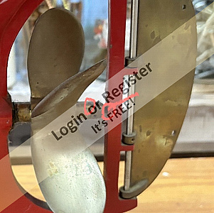

Is there a cap soldered on the rudder? See circle ⭕️ in photo.
Am I seeing a pin in the rudder square post?

If you would care to enlarge the photo will find a grub-screw through the prop and into the prop shaft, as well as the vice jaw marks on the rudder brass sheet. Regards. Gary.

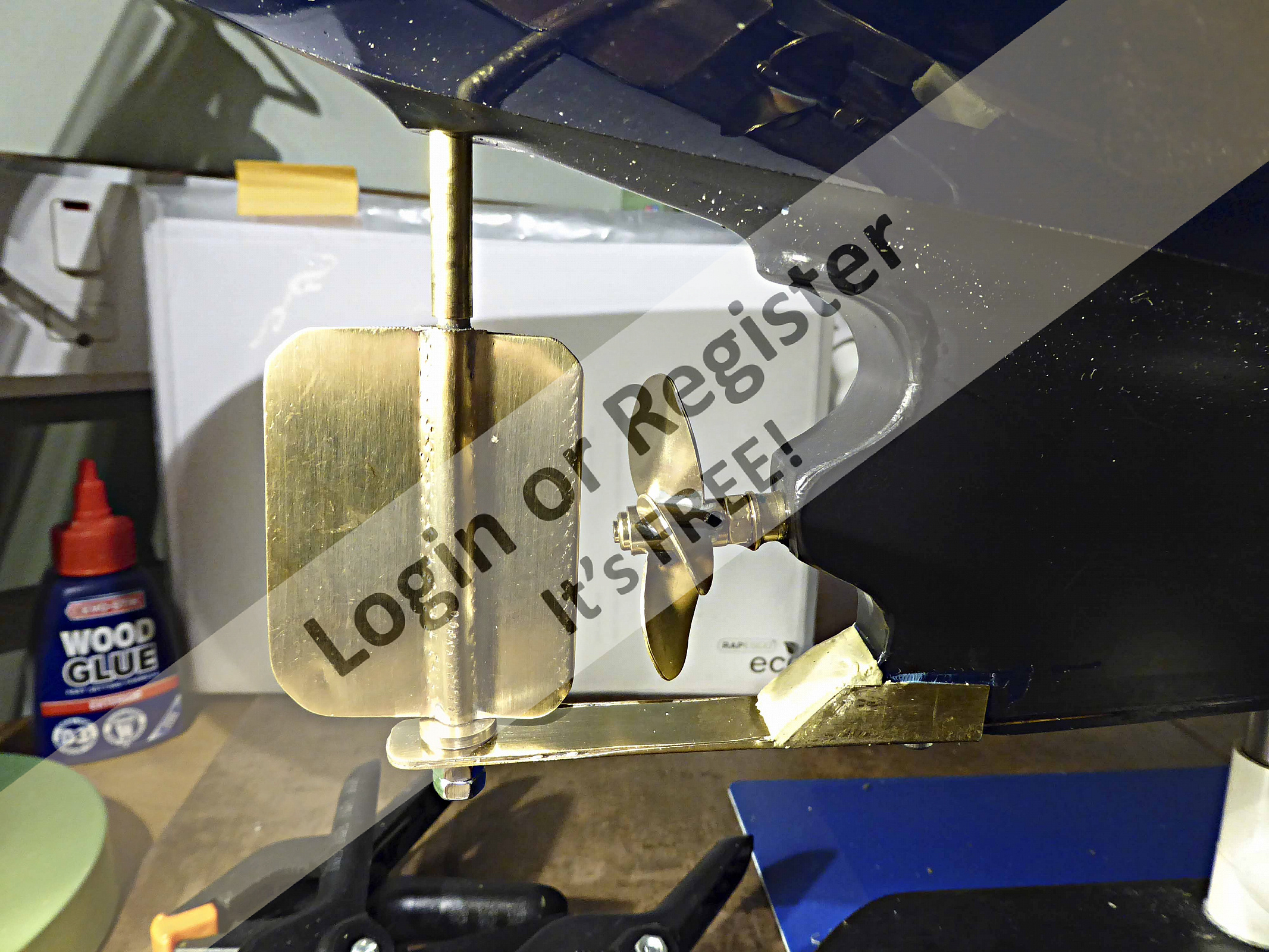

Having just given you my opinion on your prop shaft problem I thought I should back it up with the following photo, it might not look very pretty but it will be both effective and manoeuvrable, hopefully and as it turns to ninety degrees it will act as a brake. Regards. Gary.

My humble opinion on this propeller problem is, the prop is to large for the recess it is housed in. one doesn't normally fit a prop which leaves hardly any clearance room. Also, I should like to add that the rudder looks nice but is far to small to be affective and responsive, especially considering the oversized propeller. For the record I have been designing and building model boats for the last FIFTY years.

hmmmm...that all looks pretty tight. There is usually a lock nut between the ship and the screw and this creates some play. But that becomes problematic because the end of the screw already hits the rudder.

should there be a nut at the prop end of this or do I a cut the boss on the casting off and replace with a nut or just put lactate on the thread to stop the prop tightening the end cap is just that not a nut thendof the shaft rests in the rudder post
