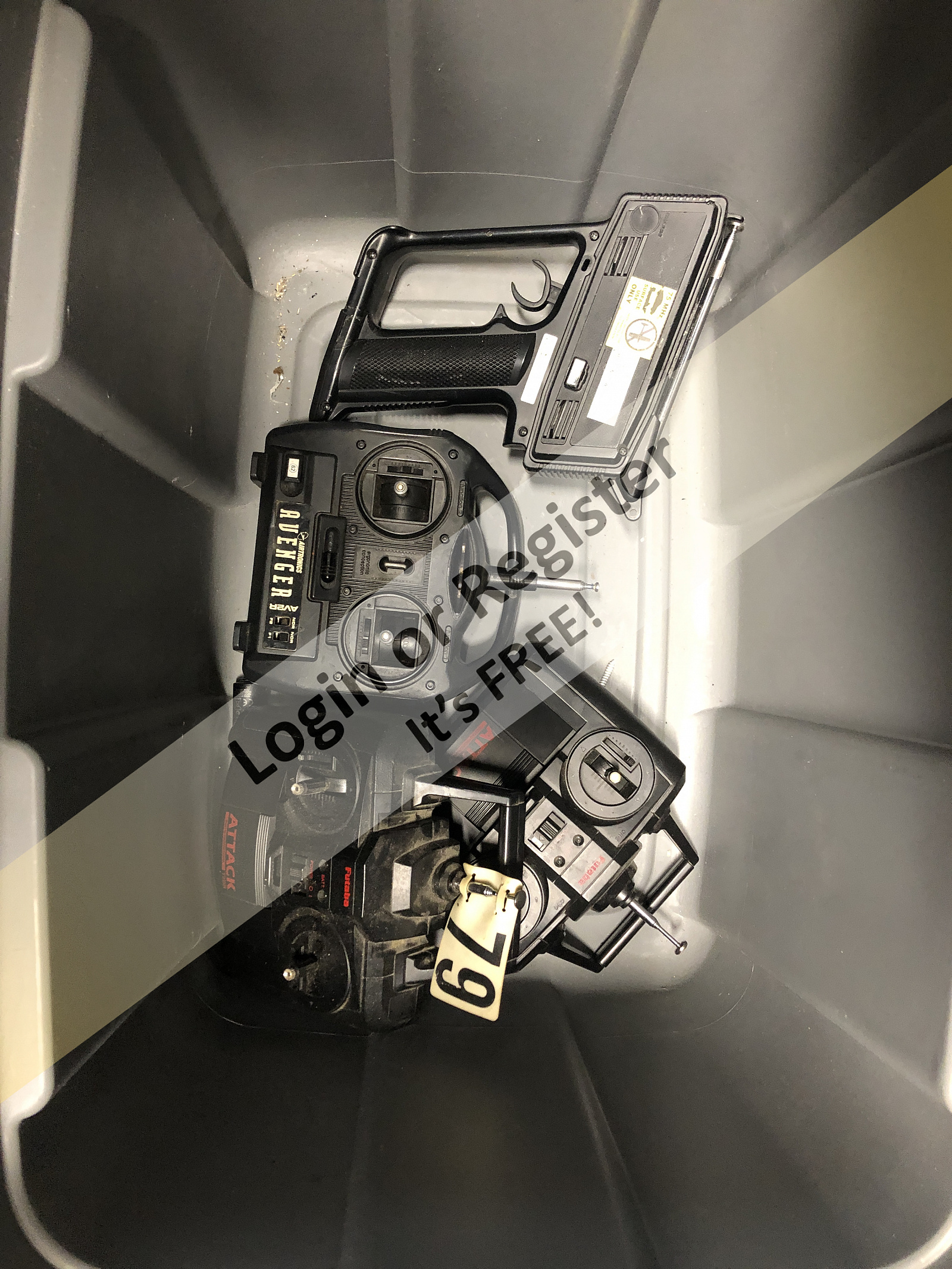

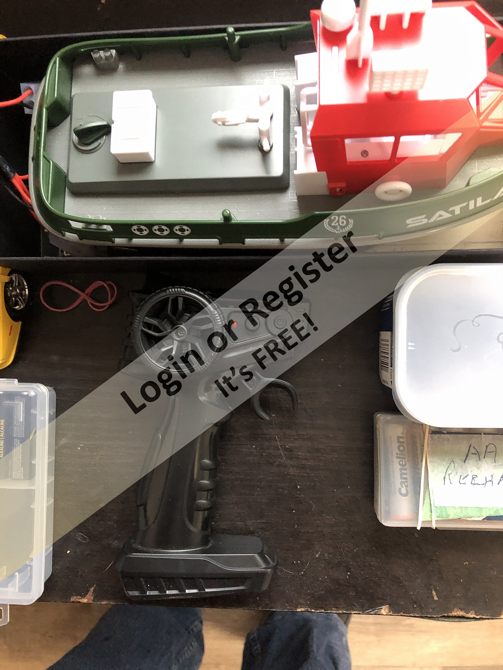

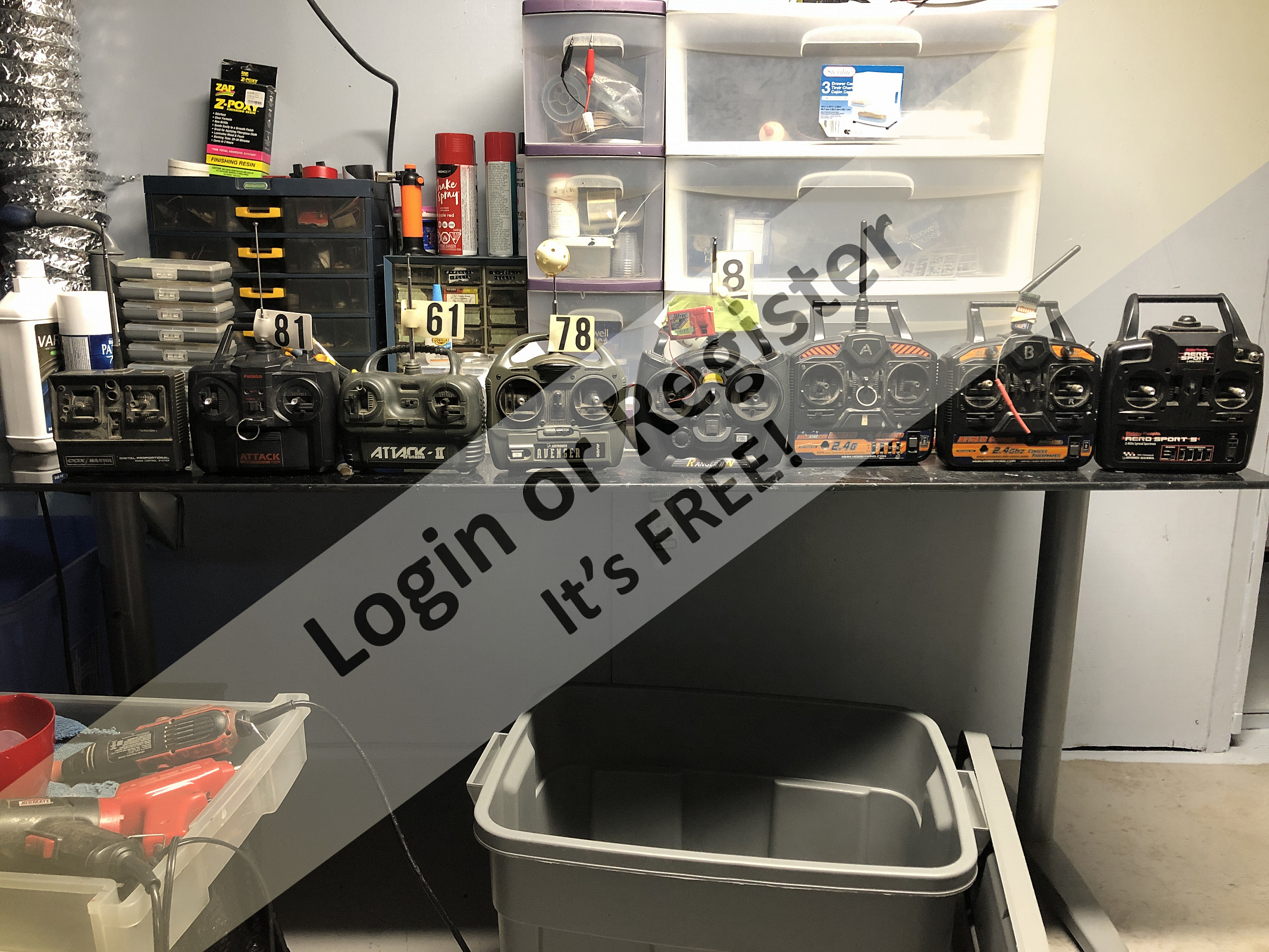

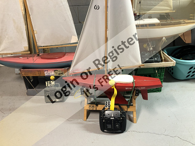

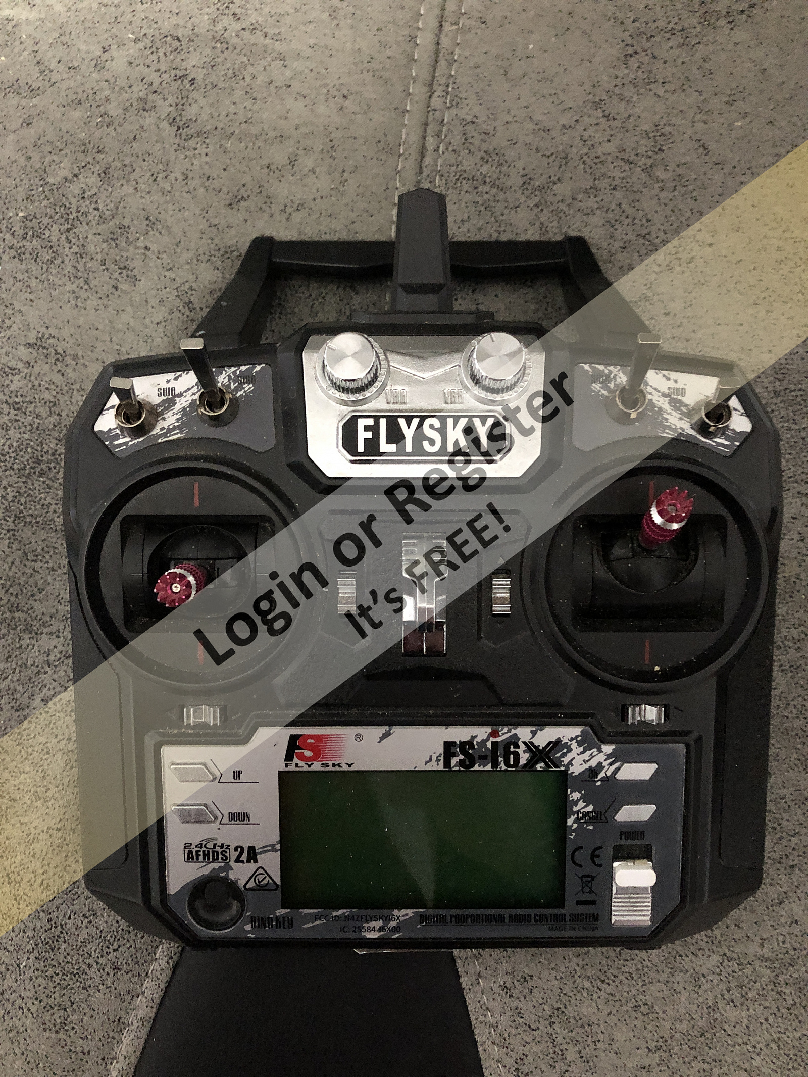

I bet you all are getting tired of me, but. I have a history of most of the transmitters from the past that I should put in the garbage, but I'm a hoarder. In the beginning first one COX/SANWA a elegal 72.160 then I moved up to the two-channel, which could only be used on one model boat. As time went by, they reproduced like rabbits Every boat needed a transmitter Every boat had to have a number assigned to it. So here is most of the unused transmitter because then Hobby King 2.4GH and everyone needed a special transmitter, but Hobby King stopped selling them, then came FlySky, which became #1 with about 16 models so far are on FlySky now and I'm still trying to figure it out.
