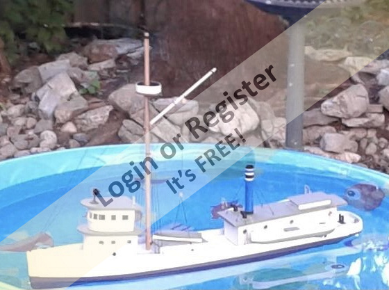

On the small water test in the pool, did it set verily well, steady, not rocking of bobbing like a cork? If so, good, if it bobbed and rocks, then in my opinion the model needs a bit more ballast. Possibly when you add the batteries it will steady it.

I started off with few pounds of stainless ball bearings... all I had, but not enough. I purchased a few bottles of copper BB's and just started spreading them out and then 2 part epoxied them in place. Once that cured, painted inside the hull Matt black. If I saw a shiny Spot, I had water where I didn't want it.

What ballast is inside the hull?
Some of us use BB shot; HO train car weights; lead shot; recycled materials from skeet shooting ranges. You glue shot in place, or put in small plastic bags and secure when ballast is done.

Good day,
My first build that’s coming near completion. The kiddie pool was used to balance it port to starboard as well as stern to the pointy end. It’s 36” o.a.l. and weighs more than a case of beer. I do have lights in the upper and lower deckhouses as well as the deck house over the “ engine room “ and the spot light too.
I’m eager the get around to the sea trials as I have never done an RC or scratch built boat before. I know she floats and I want to see it go and hopefully come back too !
A 2 year project of working on it when time allowed and family life didn’t get in the way….
