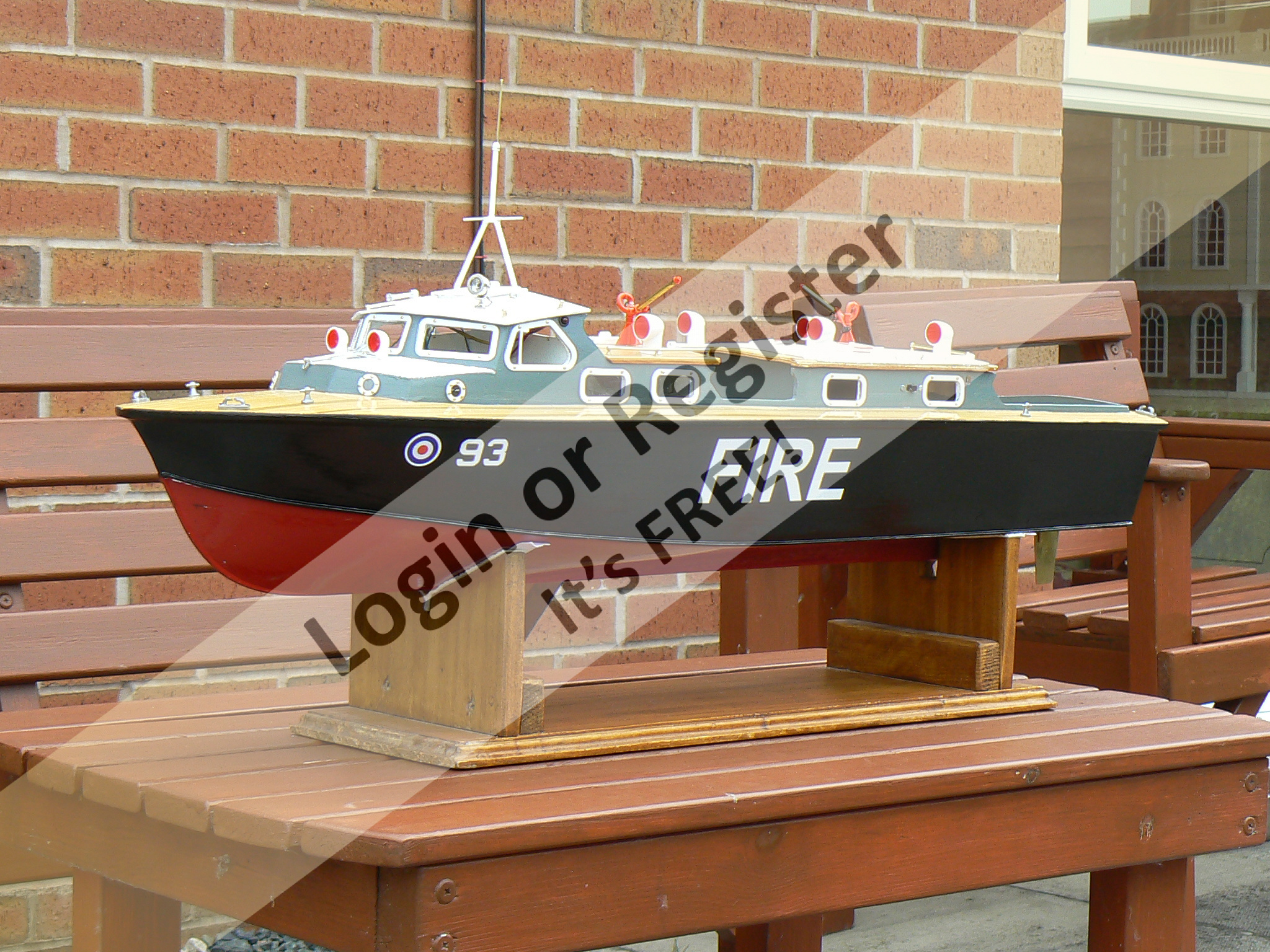

    Here is my 34 inch aerokits version over 60 years old now, but still works fine.
    Cooling water exits via the exhaust tubes in the stern.
    The monitors are fixed position but operate very well using an old 6 volt car windscreen washer pump switched by a microswitch operated by servo arm.
    The intakes for Cooling and the monitors are just behind the prop.
    All run from 7.2v nimh batteries.
    Cheers Colin.
