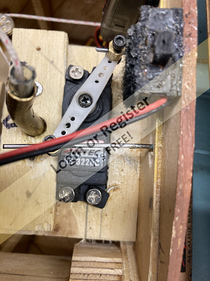

Servos Required for Aeronaut's Yacht Bella
Lengthy reply..,here are some of my servos both rudder and sail control. You will notice the 322 handles my schooner.
