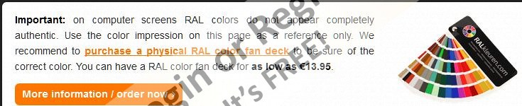

Hi mc,
Attached are a few colour and conversion charts for the popular paints.
PLUS a WARNING, that what you see on your display may not be quite what you get!!
As Dave says; take a gander and choose what you think is suitable, i.e. takes your fancy😉
