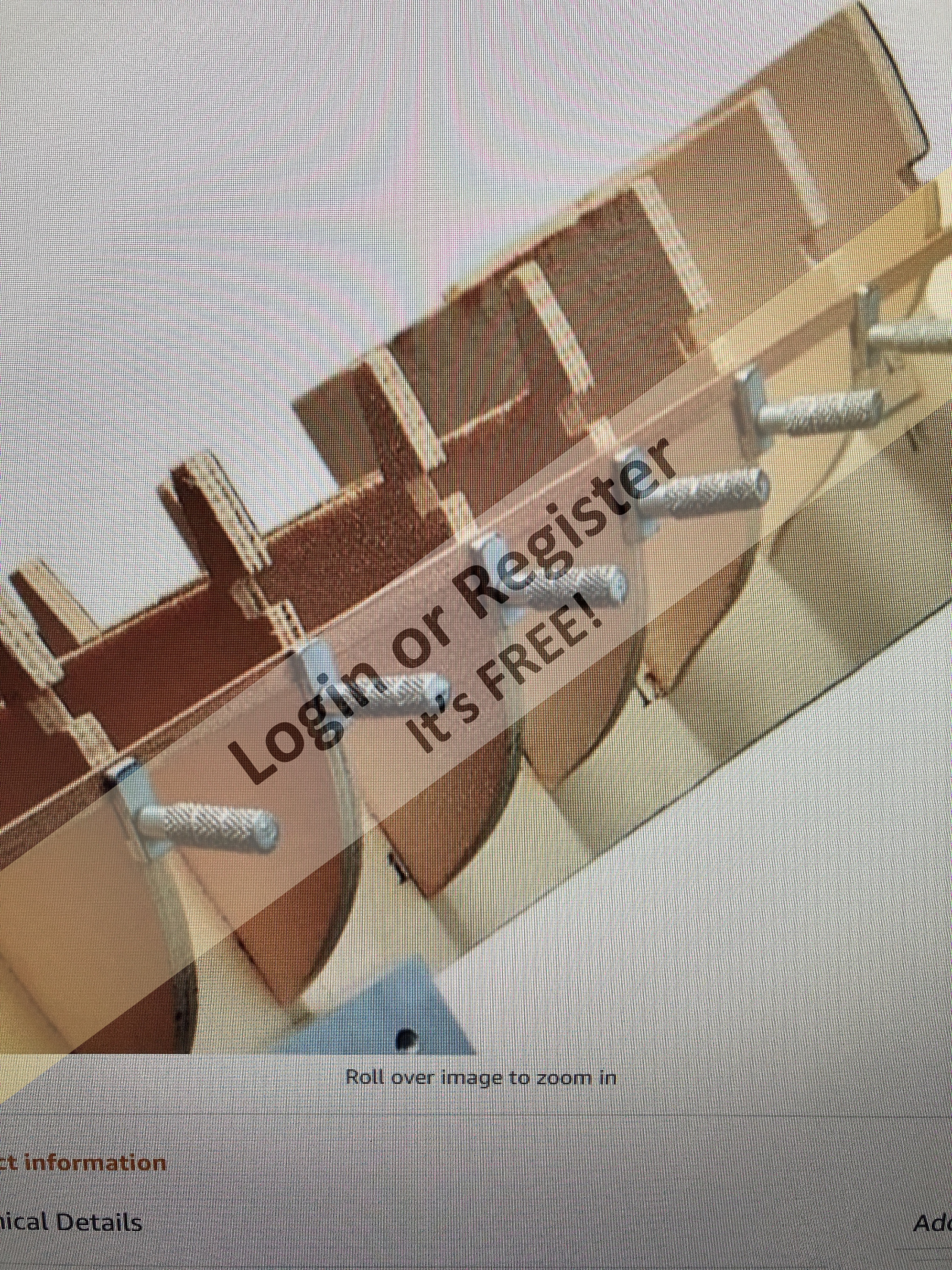

Looking at how it works if the bulkheads are just 3mm wide surely it will split open the bulkhead by the time you are halfway.

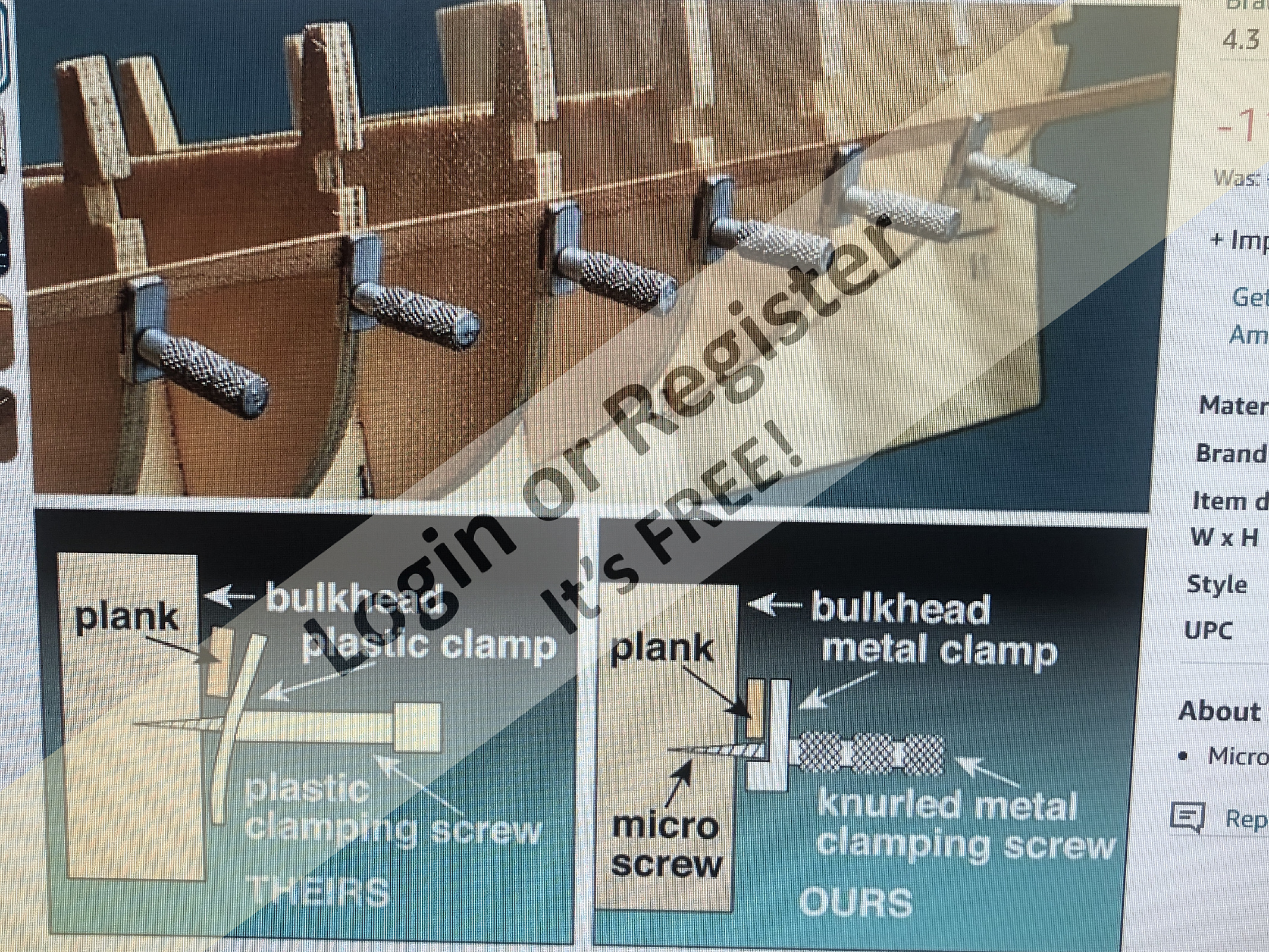

I'm sorry I didn't explain the clamp I got for planking strips on the hull frame & I have been building models for 55 years & didn't know this was available live & learn please see photo .

Thanks for all the info & that helped me get to Amazon tool ( Micro-Mark 10-Piece Planking Clamp Set ) a little pricey but it's better than using my teeth to get the crazy glue off my fingers . I could order them another way But Canada Post is on Strike & I wouldn't get them until next year P/S Santa will be happy no letters to Santa from the kids.

Definitely check the micro mark website. They had a pin/clamp set up where the pin went into the former and not the plank if memory serves.

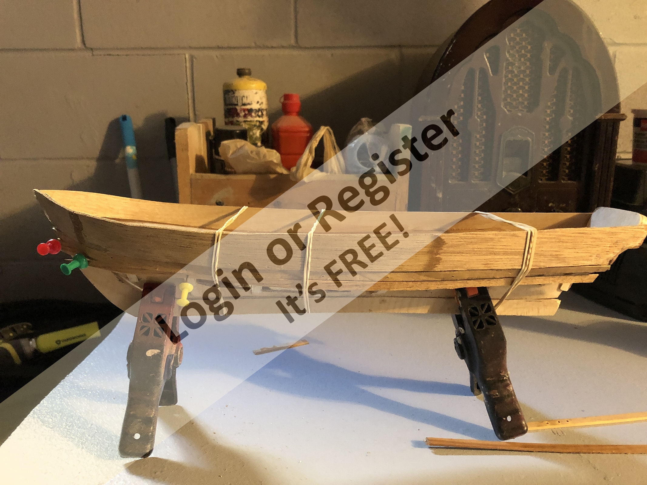

Hi I have not got a photo of the finished item, but see if I can describe how to make a quite effective one from a bulldog clip. As per picture.
You will need several as the wire parts are also donor items.
Dismantle one and keep the 2 wire pinch pieces. Take one of the pinch pieces and insert it into the upper part of the inside of the black spring part.
It will then project out so that when you open up the complete bulldog clip and clamp it on to a bulkhead there is the top of the wire sticking out at right angles. The old part which was a hinge will now hold it in place.
This will hold down a plank while the bulldog clip is clamped to the bulkhead.
I bought a pack of 20 each about 2cm wide and they make up 13 of these clamps. But any of the type in the picture will do.
Hope this helps.
