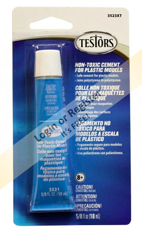

Thicker CA's have a lower odor than thin CA's. There is an odor and hazing issue when you use hotshot type of accelerants on thin CA's. I try to avoid that particular combination. I also avoid quick setting (5 minute) epoxy's as they definitely have an odor.
I still think Tamiya Thin Cement is the best way to go as you use it sparingly.
However, if you are deeply concerned of glue odor and toxicity I suggest using the Testors low odor non-toxic styrene glue.
