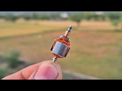

Good morning everyone,
I attach a very interesting video.
It confirms but, above all, makes clear the point (2a) "Number of turns", of the article called: "Permanent magnet brushed electric motors. Main features. Basic elements of distinction..." (see the link at the end of the text).
""""""""""""""""""All other things being equal, the number of turns (in the MabuchiMotors document it is indicated as “Number of turns of armature winding per slot”) affects both the torque (because more turns means more conductors generating magnetic force) and the maximum speed (which tends to decrease as the number of turns increases, because the resistance and inductance of the winding increase).""""""""""""""""""""""""""""""""""""""""
Let's remember (it's better not to take anything for granted) that, by Ohm's second law, a longer and thinner wire offers greater electrical resistance than a shorter and thicker wire.
I hope it will be of interest both to enthusiasts of electric motors and electronics and to all modellers.
https://model-boats.com/wiki/147457
