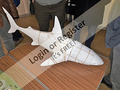

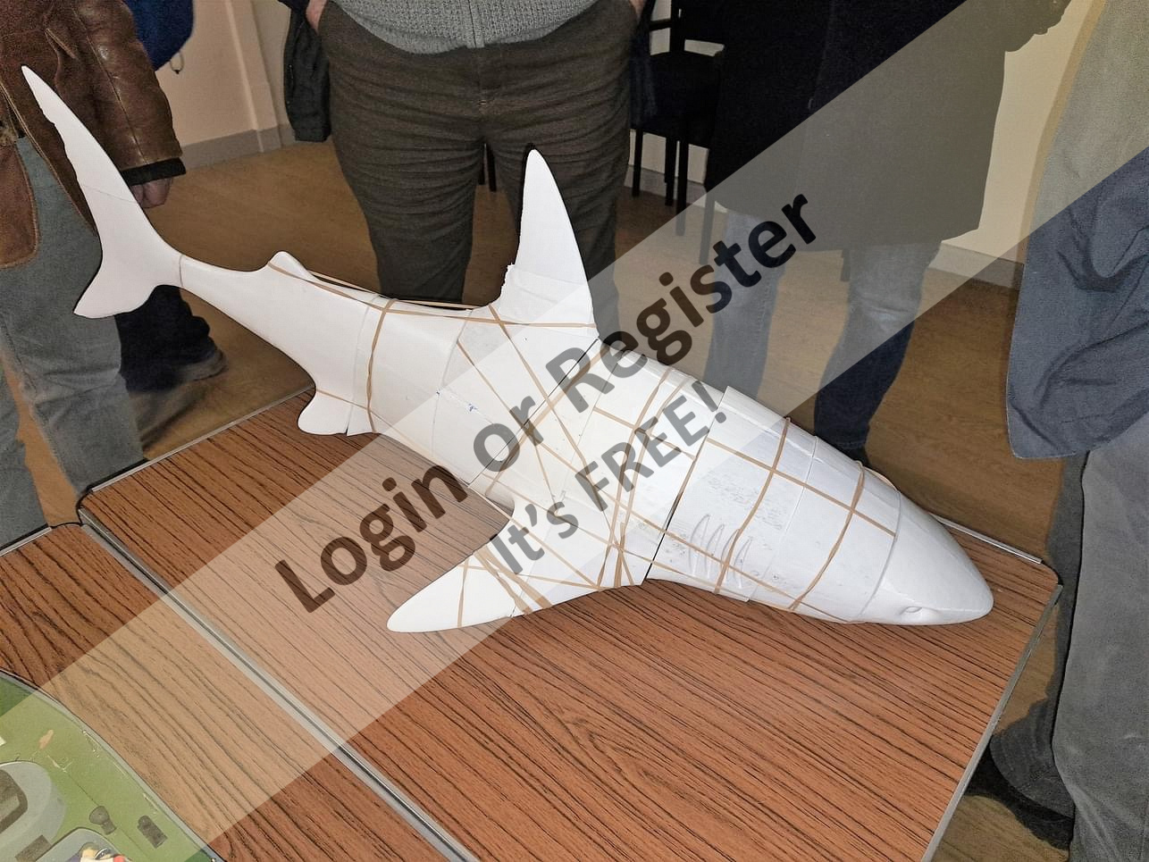

Hi all, sorry if I’m duplicating a thread, but I’m trying to get some guidance on buying a 900mhz TX/RX set for my great white shark.. it’s potentially going to be-submersible and I’m told 2.4ghz won’t work under water..
Any guidance/links appreciated!
Thanks,
Eric
