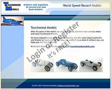

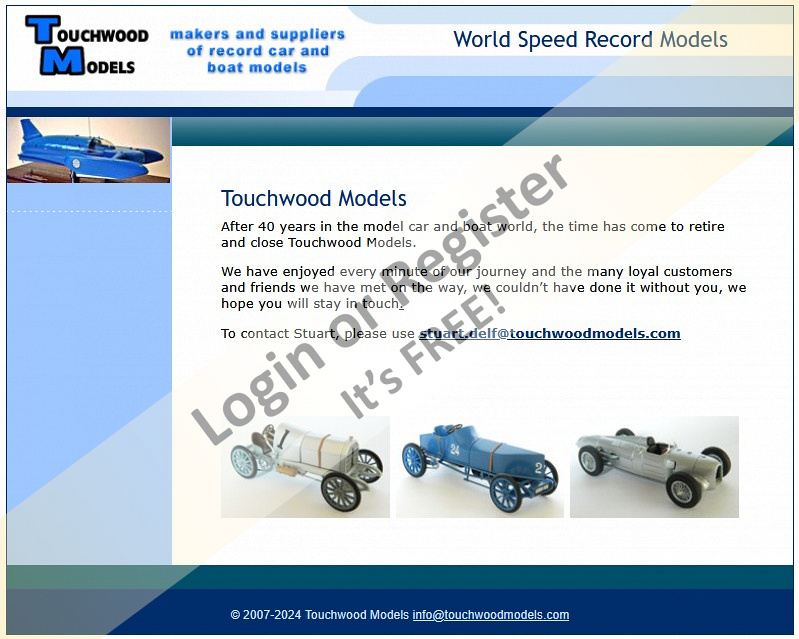

Hey me hearties! Stuart Delf at Touchwood was kind enough to send along a nice reply to my query.
He has not produced a K-7 in two years and has no plans to do so in the future. He suggests eBay searches as my/our only outlet.
Bummer!
However, I appreciated Stuart’s reply.

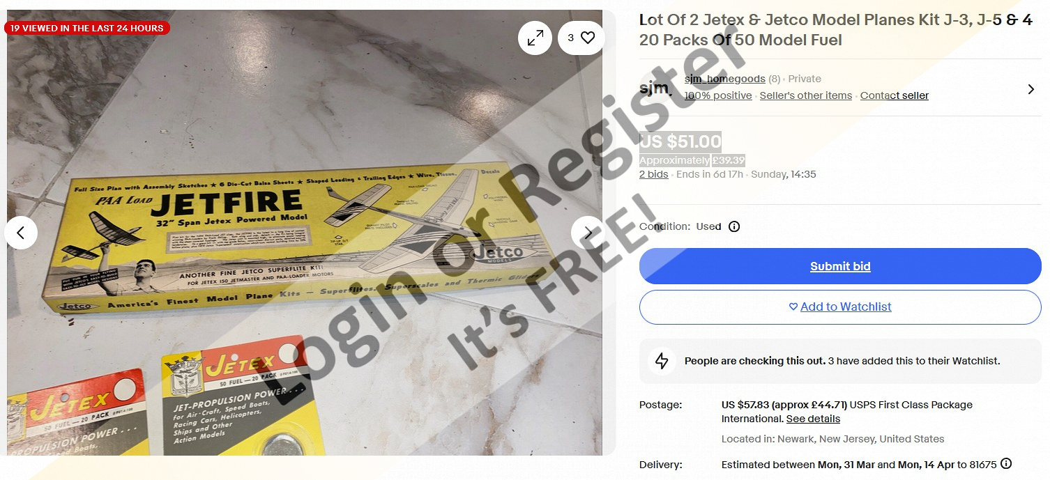

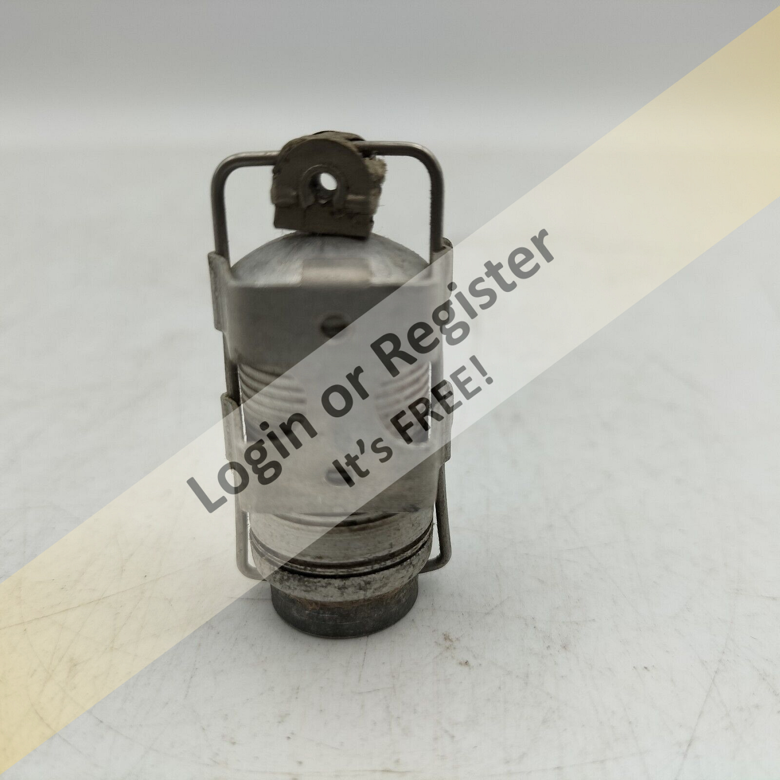

Shucks🤔
Just cancelled my Jetex order.
Found exactly the same parts (same pictures) for ca £39.52 instead of £99.00.😮
Now cooled off on the whole idea.
Ciao, Doug😎

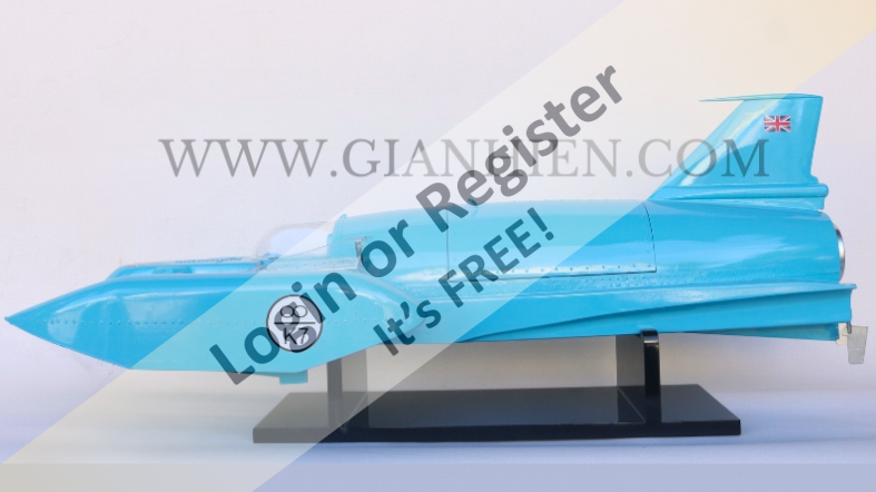

BTW: here's an r/c ready 1/8th scale Bluebird made by Gia Nhein aka: woodenmodelships.net in Vietnam . I've inquired about price on a lark. We'll see.

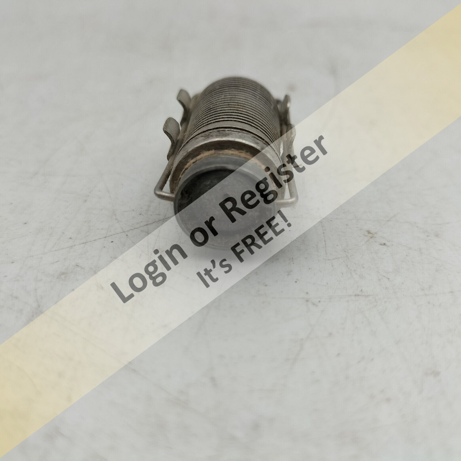

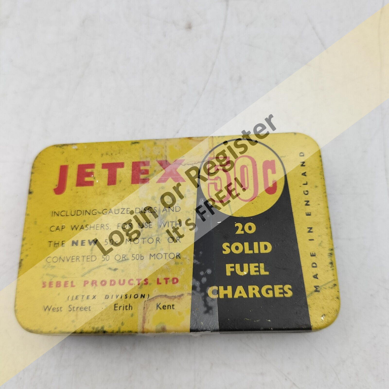

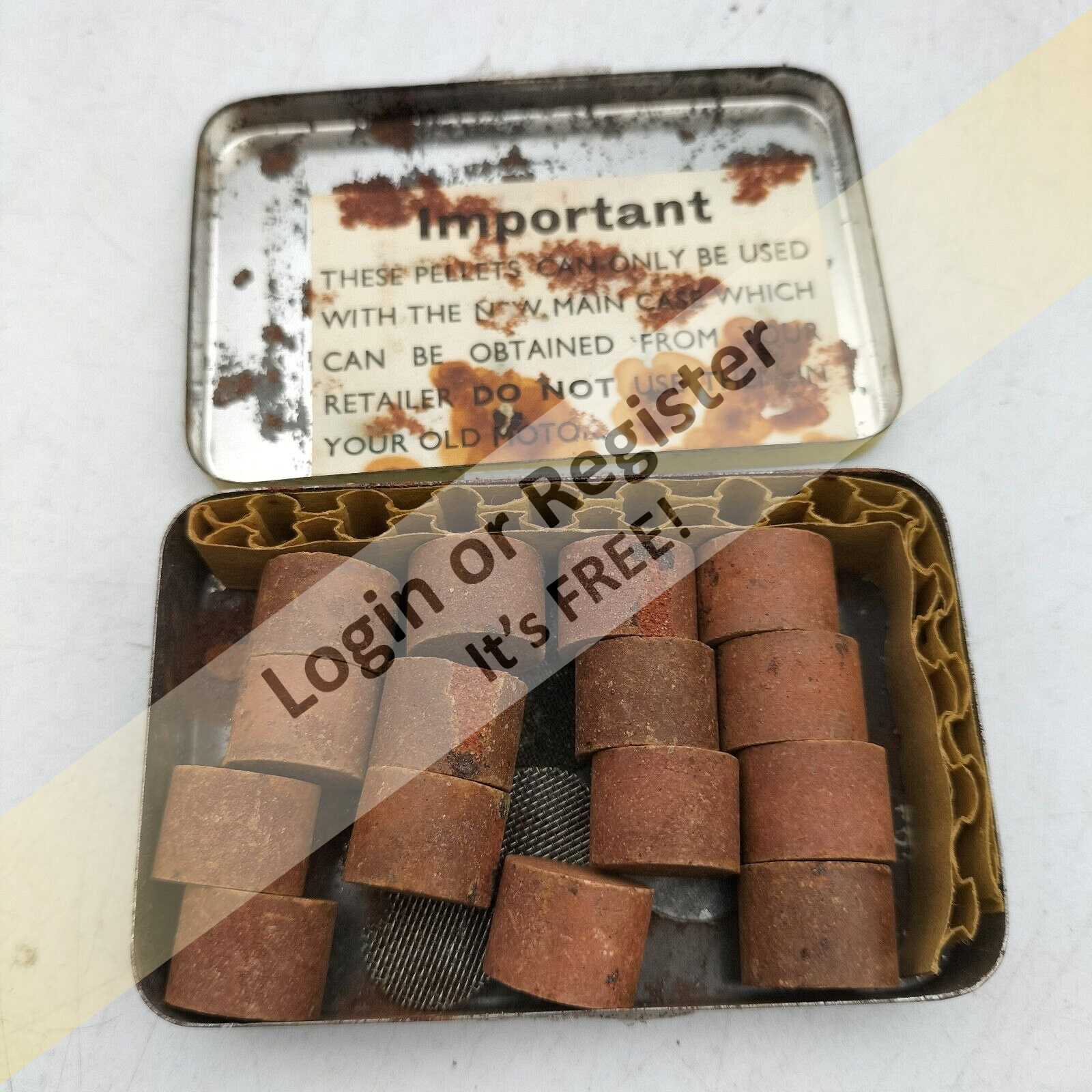

Back to Jetex.
Shame the Jetex forum fuel discussion seemed to fizzle out (damp fuse?☹️) and vanish in the desert. Made me curious though so hunted around a bit.
Have just ordered from Eb a complete Jetex 50, but more importantly, a box of 15 Sebel pellets with gauses and washers etc.😉 Wish me luck🤞💥😭
