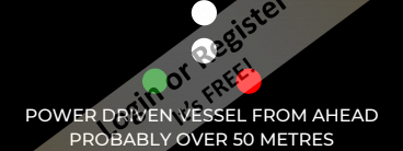

Hi Pat, a clarification, if I may.
For sailboats over 20 meters:
The green and red masthead lights are visible 360 ​​degrees and are optional (not mandatory).
The white stern sternlight (with a 135-degree angle) is also mandatory for sailboats.
As Pat said, if the boat is powered by a motor, it must also display the white masthead light (225 degrees toward the bow). Two if it is over 50 meters.
The side navigation lights have already been mentioned, but I can add that the careful modeler should only make them visible 112 degrees toward the bow (this way, they will only be visible when the boat is viewed from the side or head-on).
This is what I remember after studying the COLREG.

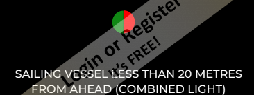

Lights on Boats
Following on from my last posting about lights on power vessels here are the lights that should be displayed by sailing vessel along with the stern lights that should be displayed by power and sailing vessels.
Also are the day time marks that should be displayed by a vessels under power and sail

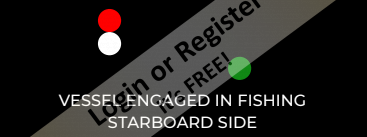

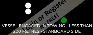

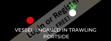

Lights on Boats
Hi Ship Builders
For those tha put lights on their model they have built - please find enclosed a summary of the correct lights that should be used - these are the correct internation lights.
If you want to know the correct lights for sailing vessels please shout - giving me an indication of the type and lrngth of the vessel
Cheers
