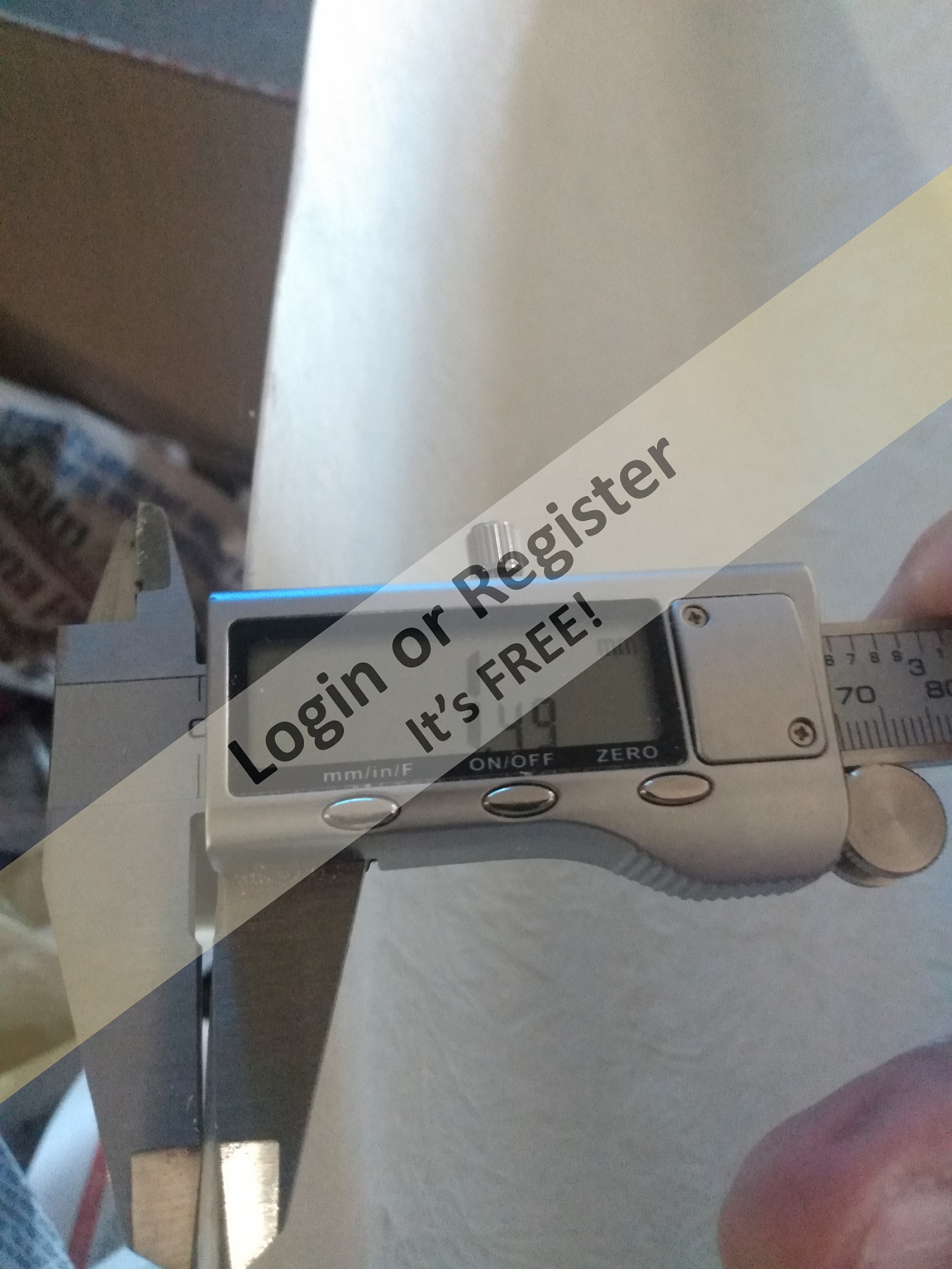

Well I finally received my Huntsman hull from Ebay. To me it looks very nice.😀

Sorry to hear about the sinking. The hull you have is more likely to be nearer to 34" when measured over the rubbing strips and is likely to be from the Precedent kit at the odd scale of 1:11.
If you send me a message with your email I can help you out with drawings etc. This will be in a few hours time as going to bed now! Have stopped up far too late this side of the pond!
