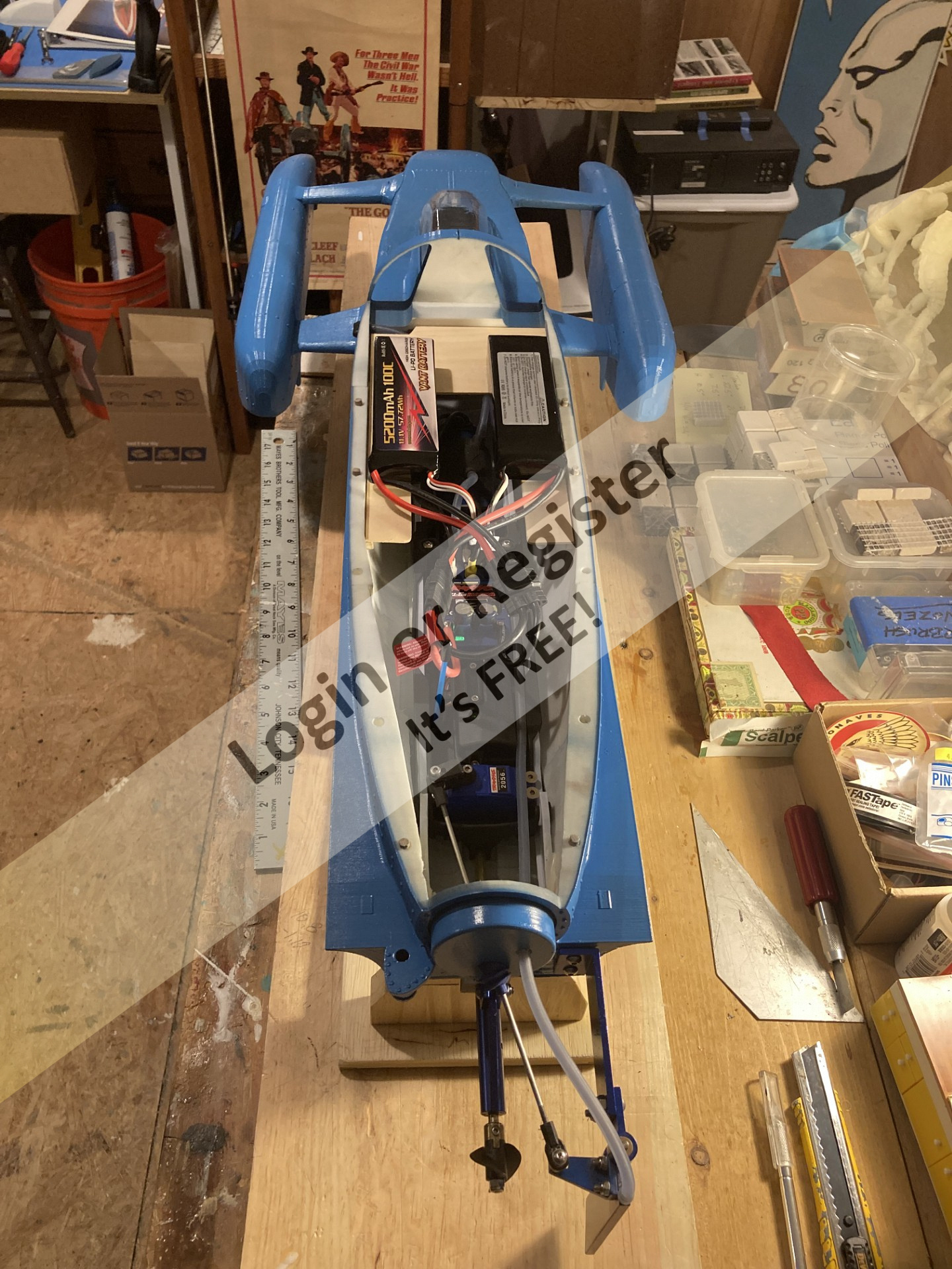

As a dyed-in-the-wool Nicad guy, then Nimh, the move to Lipos has been a chore, especially for high speed applications. I think I'll need a phd to figure them out, charging, storage, discharge rates. Yikes! But, dove in with both feet so the quest continues.

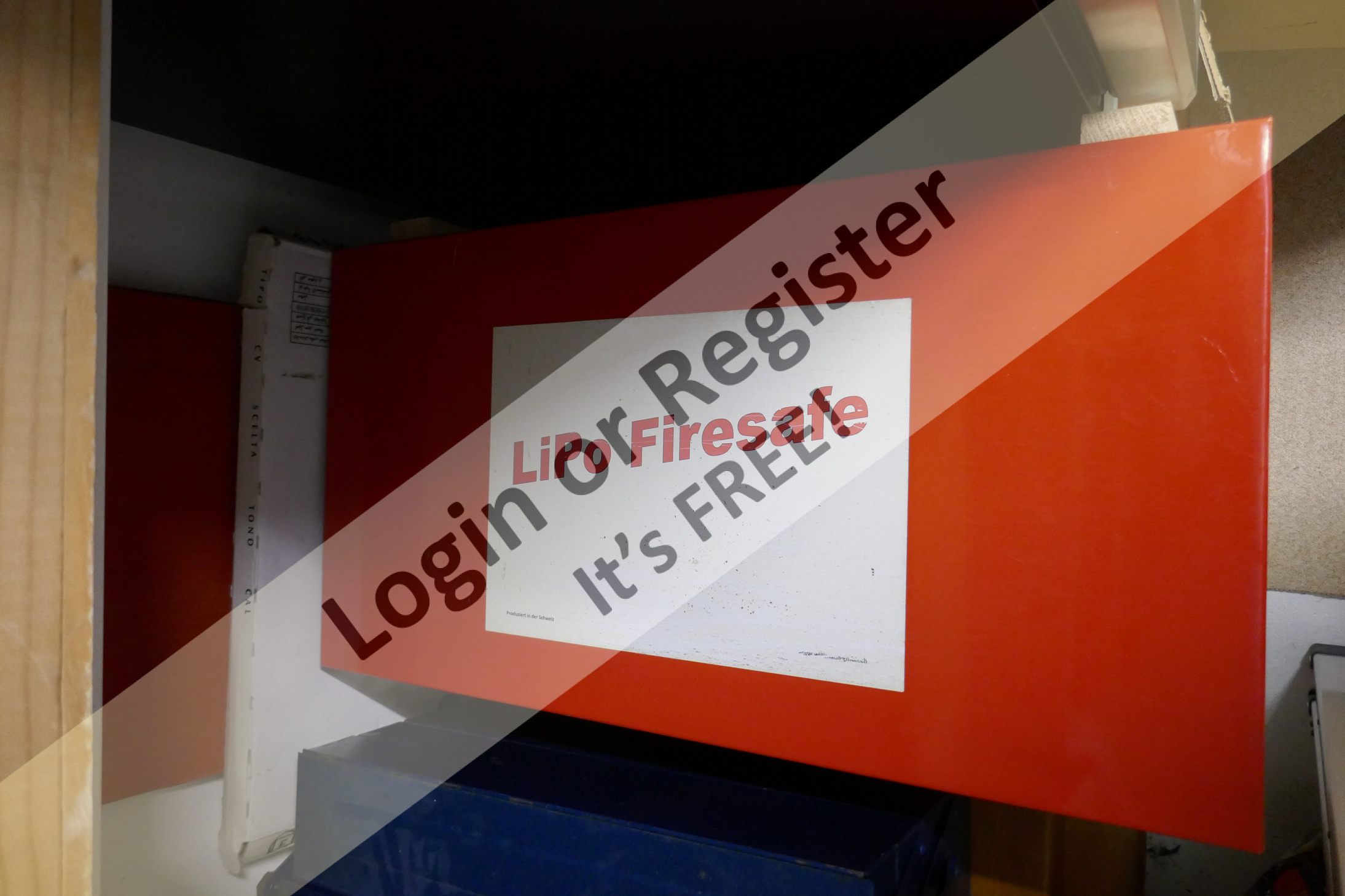

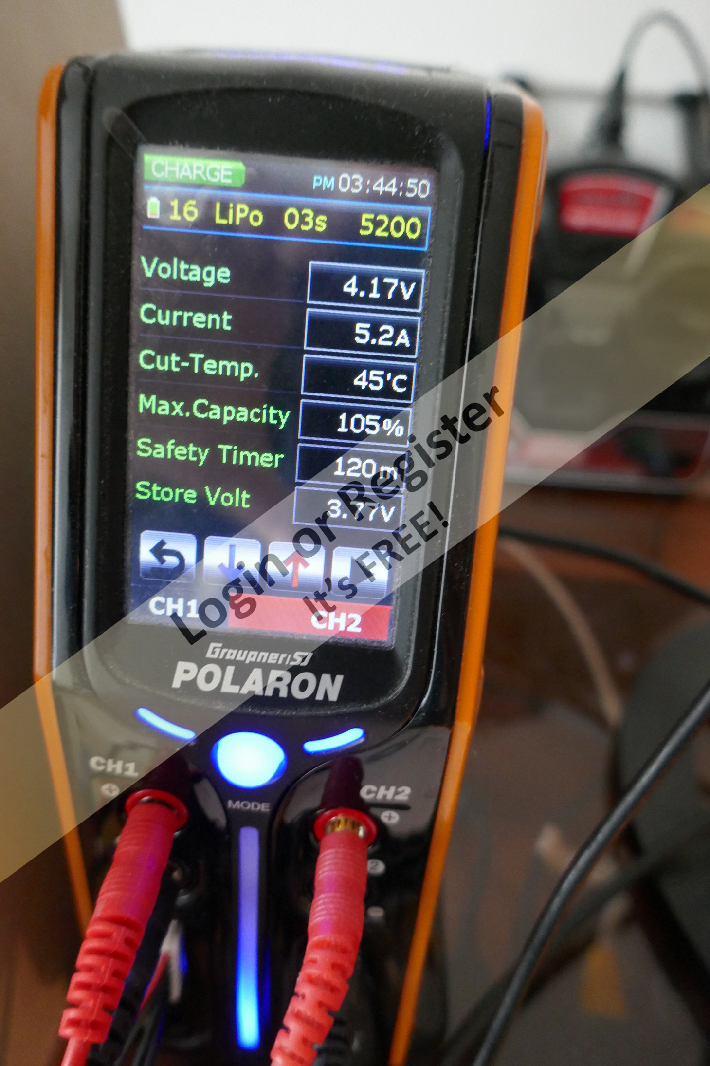

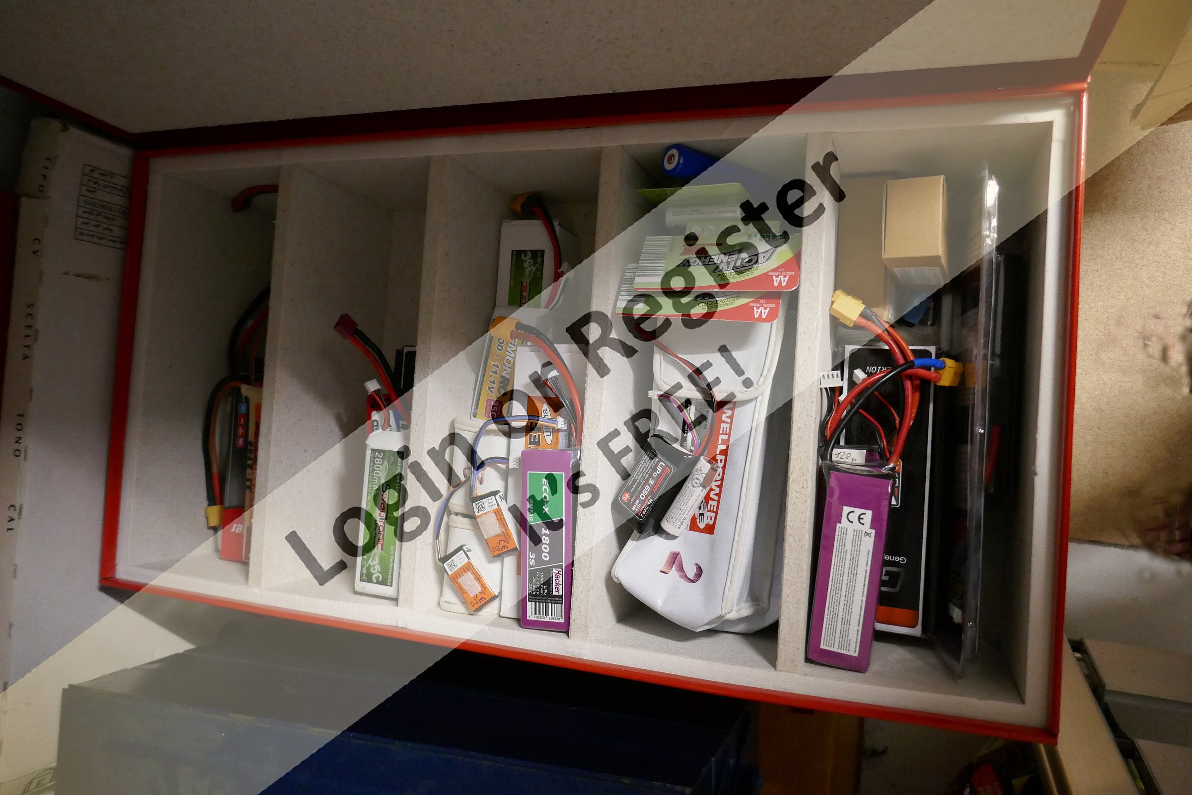

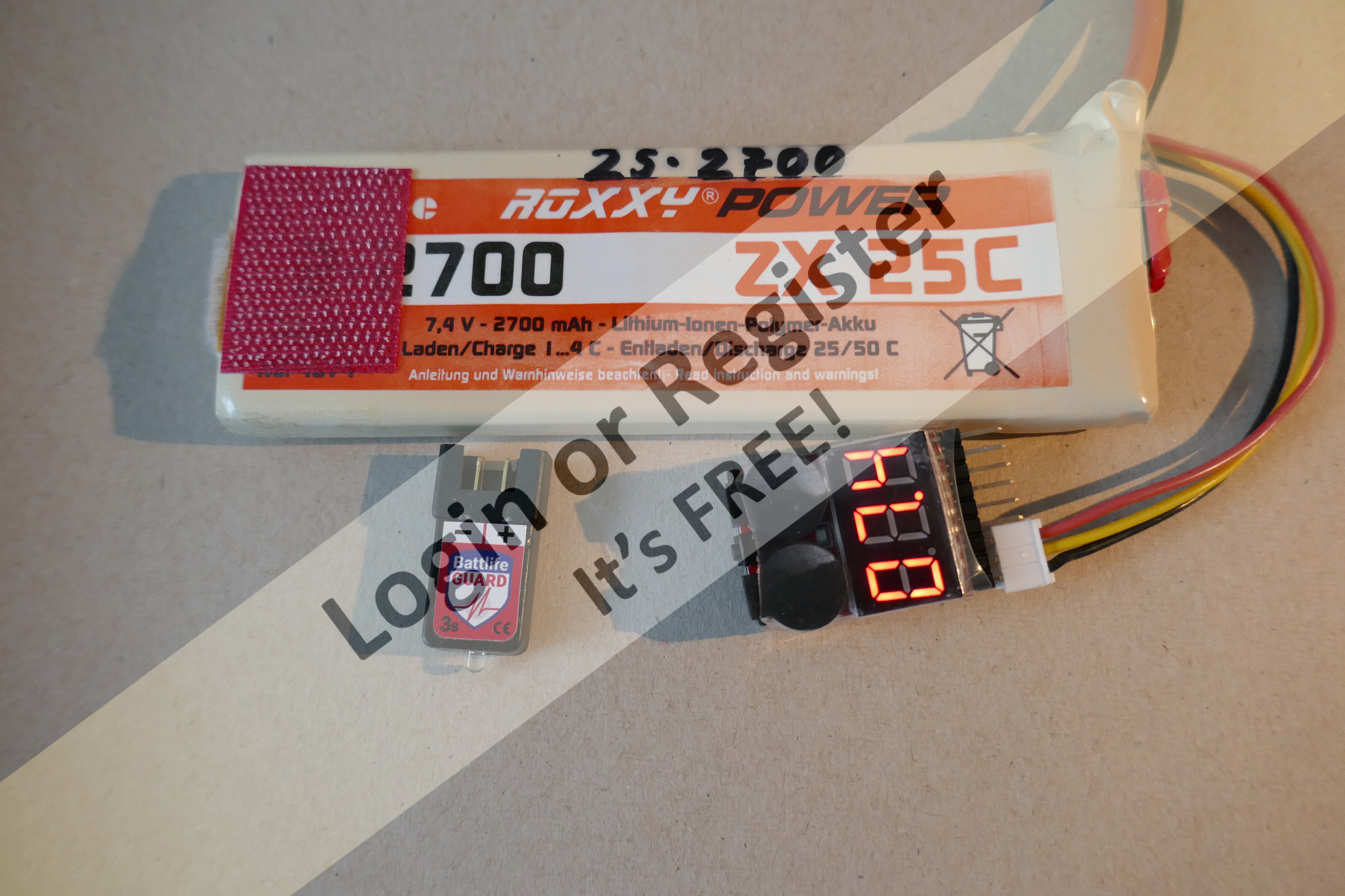

Try to keep life simple - even building finicky and complex models. The Polaron charger has been serving me for roughly ten years, charging anything up (or down) to my camera and motorbike batteries. The Lipos in the Firesafe (clad in firebricks - safety first!) are up to 8 years old and all in (near-) perfect condition. The last pic shows 2 useful gadgets: a VERY noisy voltage monitor you can even hear when flying gliders and a de-charger which lowers Lipo-voltage automatically to storage state (storage voltage is IMPORTANT). Good when you have not emptied the battery; happens more often when running boats than flying planes . . . Both by the way cost so little I have a number of them. And I would never buy anything that has to do with electricity IN China. Yes I know, the stuff all comes from China, just like my Lenovo laptop. Differentiate! And when I fry things like ESCs I don't frown at the battery - I squint at the mirror. As I say: keep it simple and safe, don't change a winning horse. Your wallet and your nerves both say thank you.

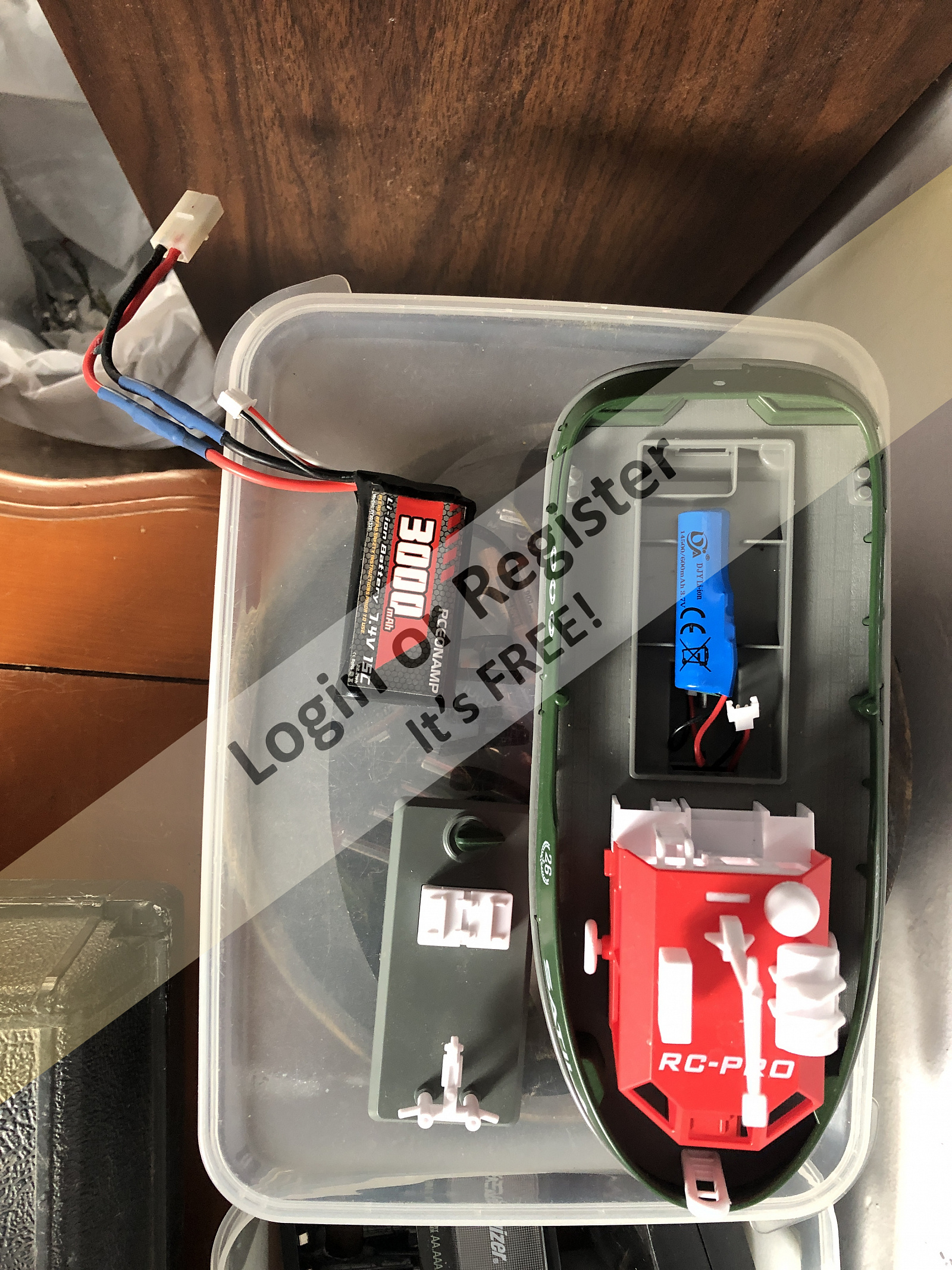

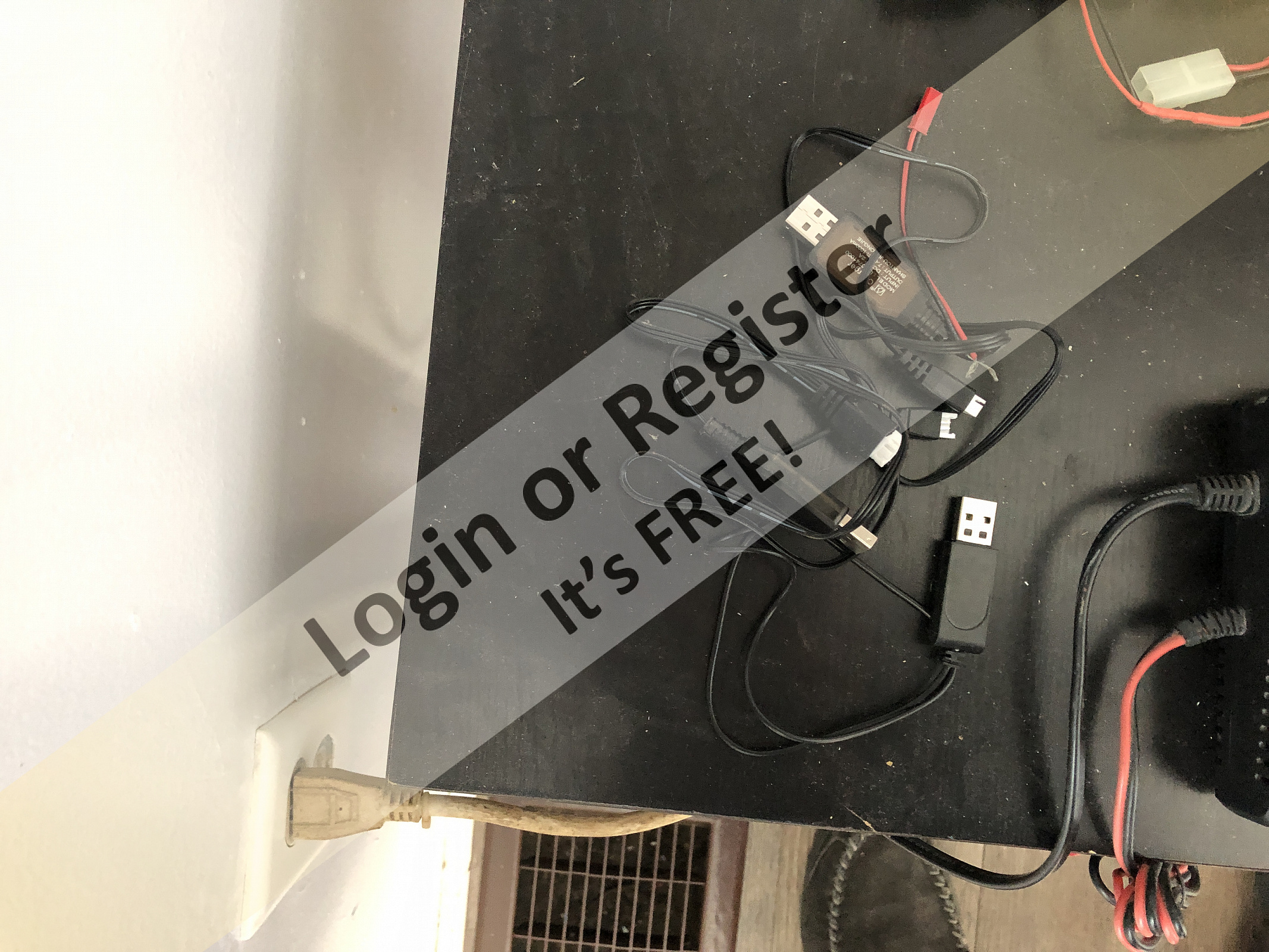

Those little boats are great for kids though the 2 in 1 esc/receiver units are terrible. They don't have a low voltage cut off so you end up accidentally destroying the batteries. The included USB chargers are just as bad.
You can fit a 10amp brushless esc and add 2 280 brushed motors along with a rudder and they sail perfectly. They are cute little boats and very popular for hobbygrade conversions

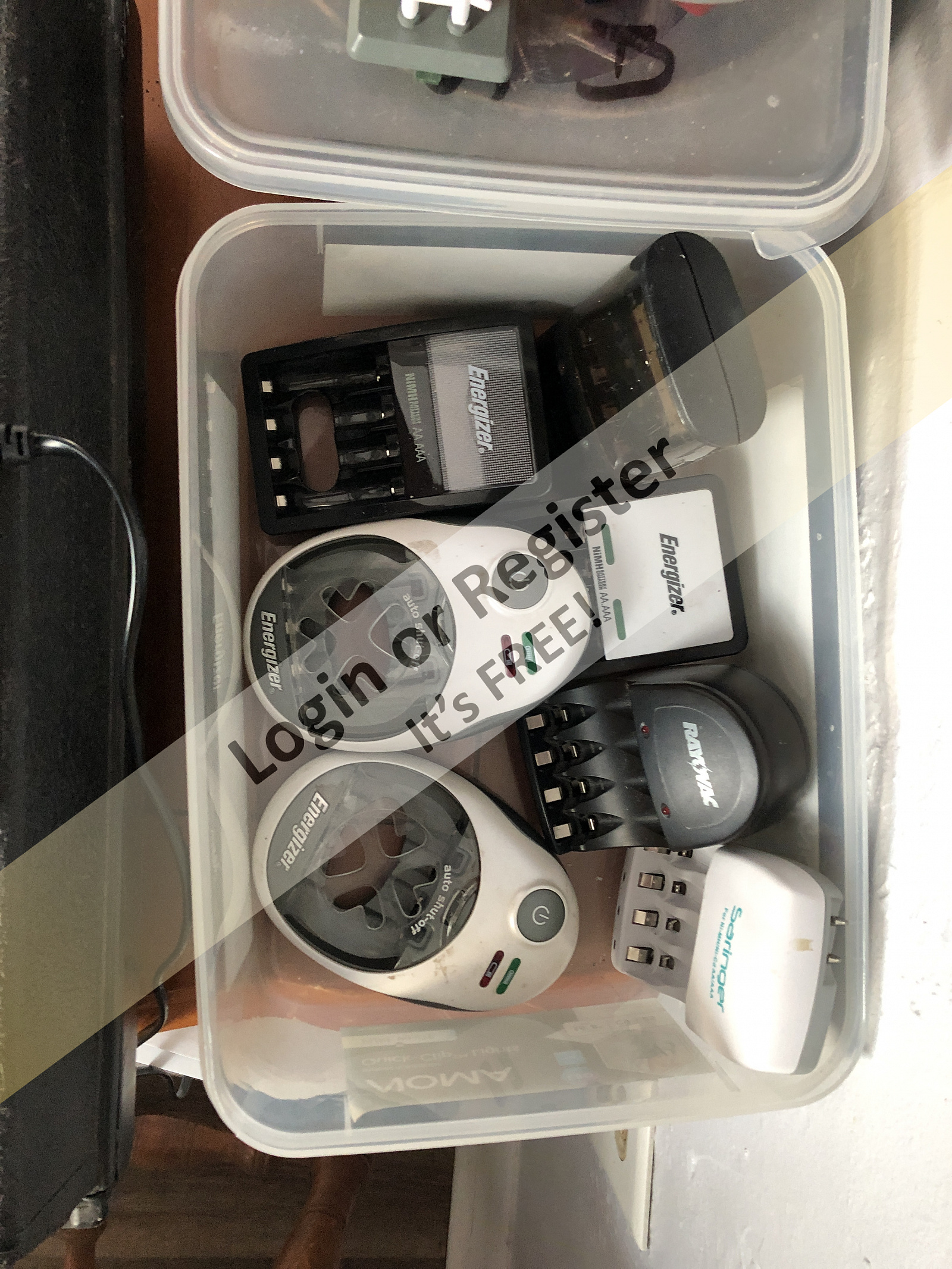

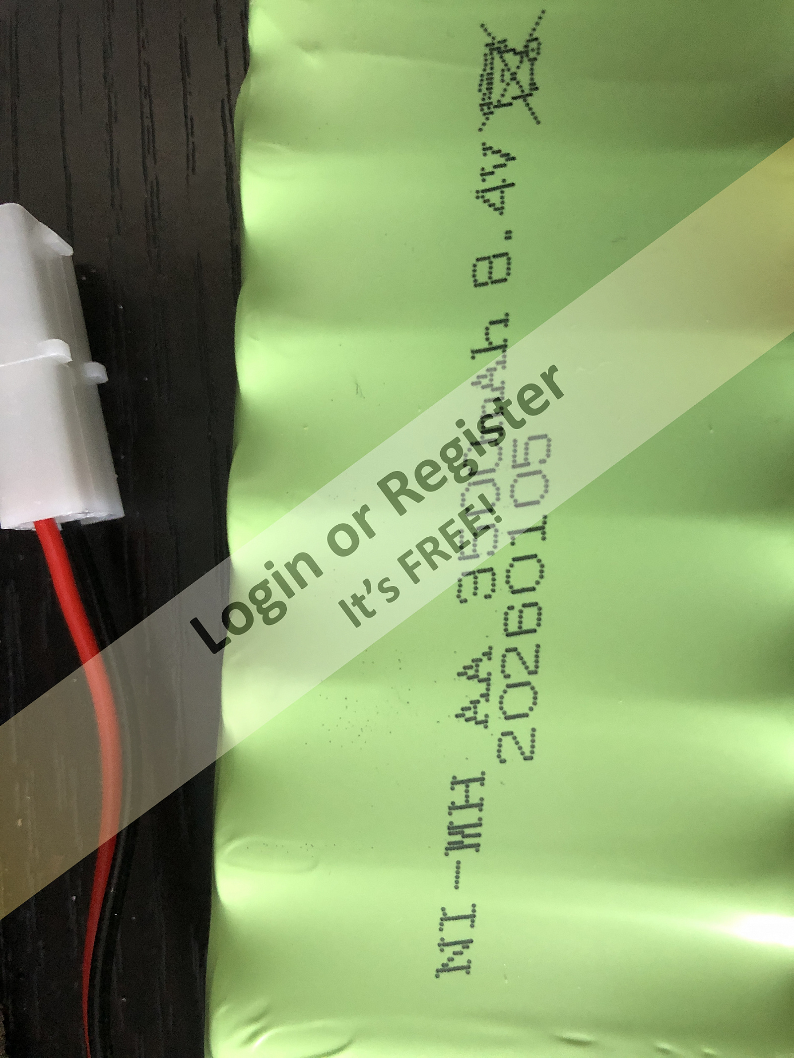

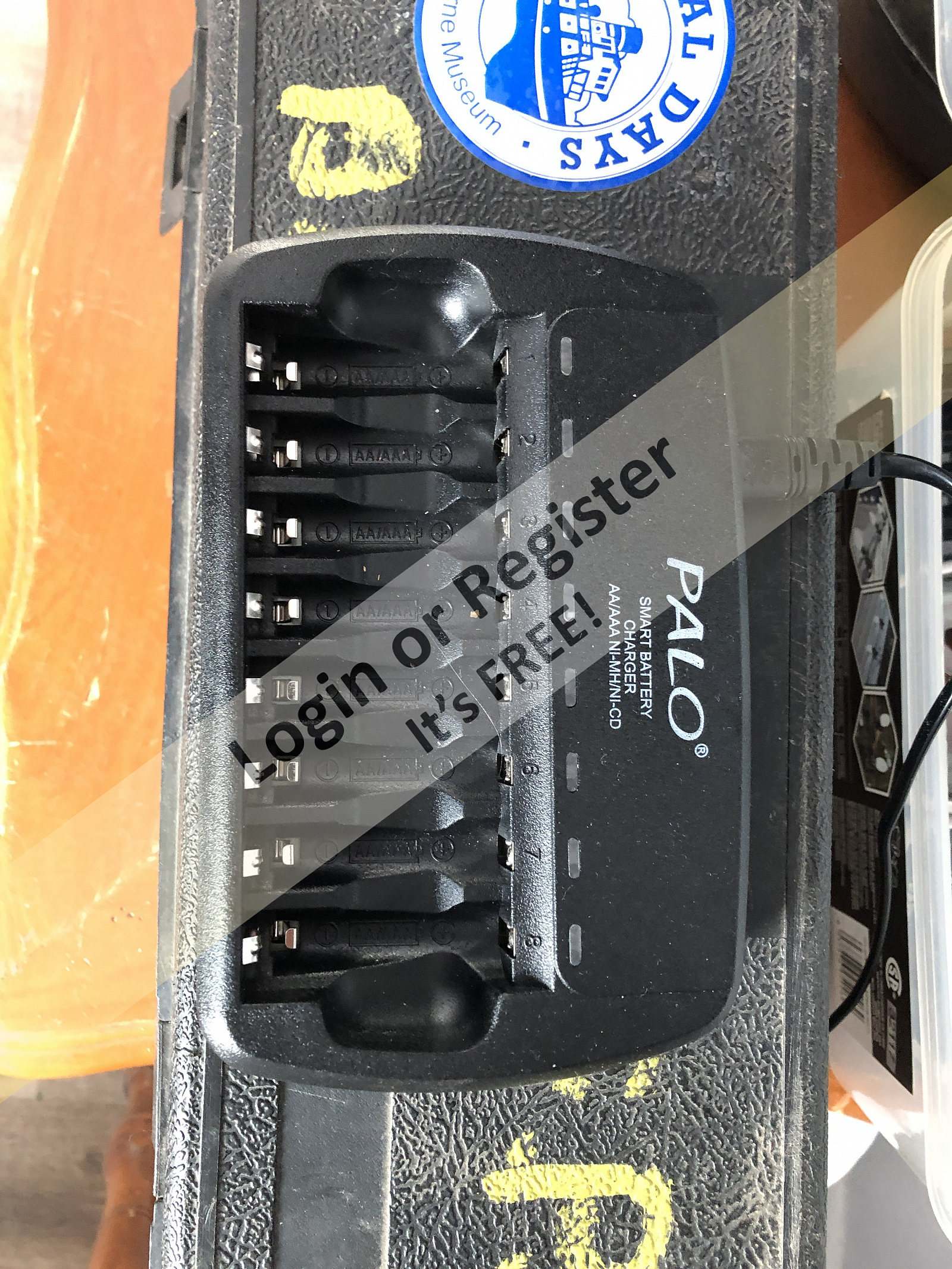

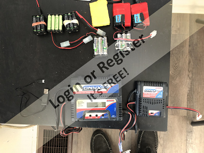

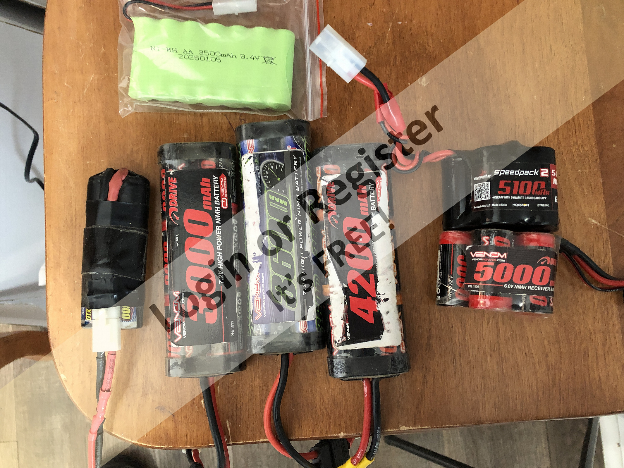

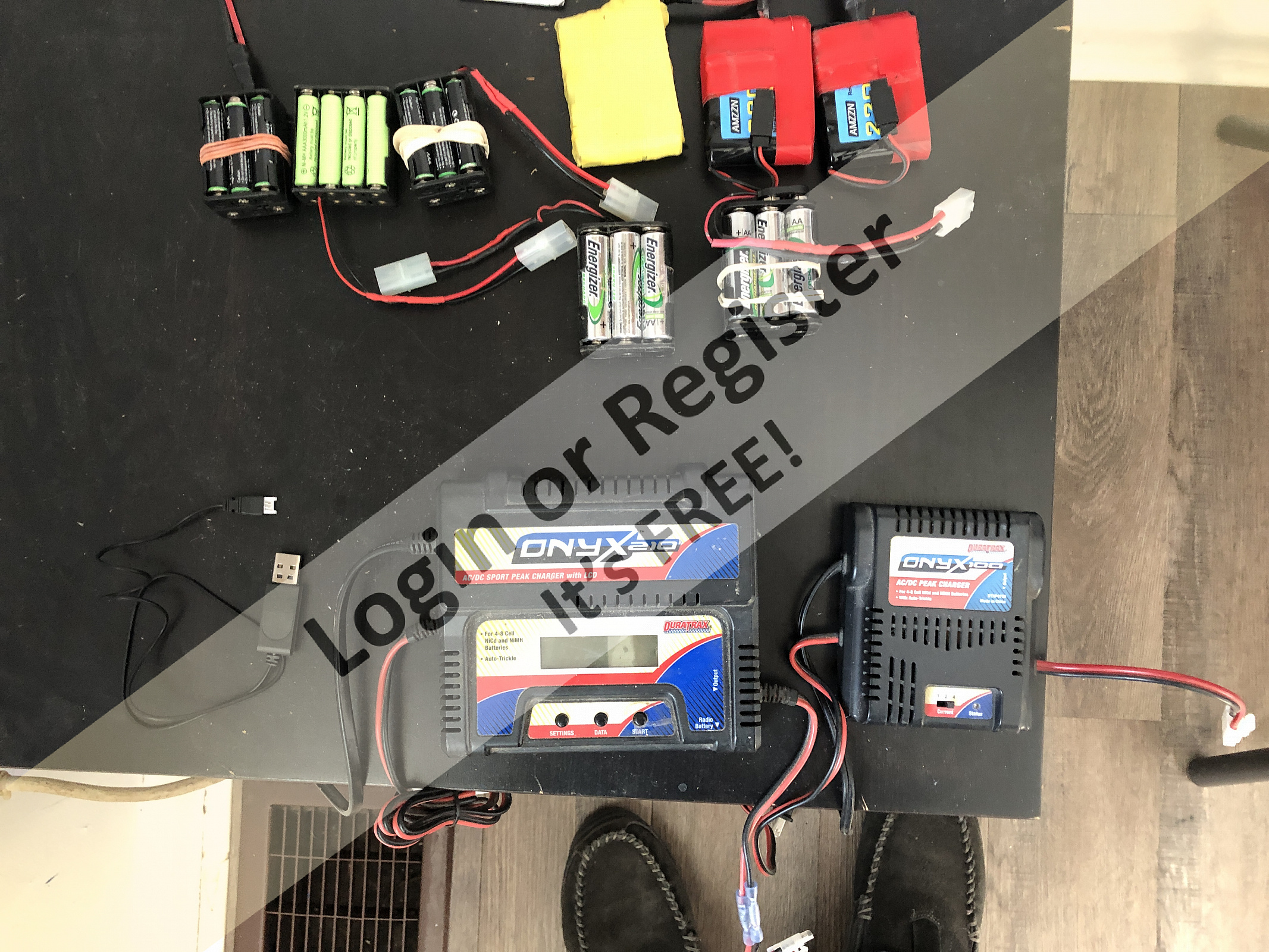

I have been building R/C models for many years, and during my Building of models have accumulated so many types of batteries & chargers. In the begining started with Nickel Cadmium bad for envirament so on to Nickel metal hydrate, 7.2 volts with different MAHs.Tried the ion batteries. First one fried my speed controller & smoked the battery. I also bought a small fire boat for the little kids to run at shows. It has an ion lithium battery that had an alarm in the boat if it was low .that battery ran down & battery will not charge any more SO NO MORE lithium. Last photo is my newest charger for my 3000 Amp Hour AA batteries that will be my power for Voster or maybe a the NI-MH AA 3500 8.4 Volt I just got from China.
